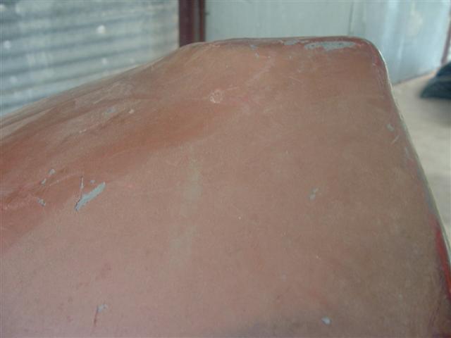

Looks like it has been hit in the front. How are the front quarters? It looks like the crosspiece under the tool roll shelf is deformed by about half an inch. This not only looks bad but will also affect the fit of the fenders if the damage is not repaired/pulled out.
That area looks fine to me

I think the later front apron was just welded on in an uncommon position.
All of the horizontal lines above the tool shelf seem to be parallel to me.
My 100th part of a dollar x 2
Ted
I agree with you on the apron. It is crooked but it is coming off anyway.
I am talking about the metal immediately below the tool shelf.

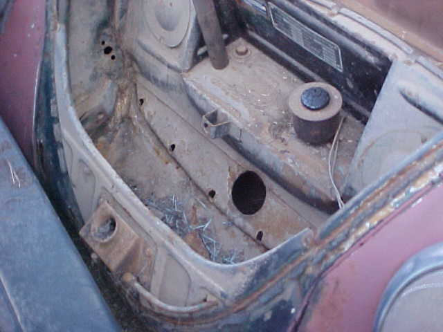

Does this help any woody? Maybe just to clerify something you see..And yes the apron is getting cut out and replaced with correct parts..Ill be sure to post pictures they send to me from the shop.
Yes it does.
Where the flat shelf area turns downward there is a bulge. I will call that panel (the one with the inspection holes in it) the front crosspiece. There should not be a bulge there--it should be flat all the way across except for that slight bend that runs from one side to the other. The flat shelf is bolted to the front beam because that is the location of the front body mounts. When a bug gets hit in the bumper, the bumper--which is mounted to the lower, unsupported corners of the front quarter panels--pushes back the quarter panels. The quarter panels are spot welded to the front crosspiece. It moves with them except in the center where the shelf is. The shelf doesn't move because it is bolted to the front beam. Instead it tends to deform the crosspiece where it is attached. That deformation is very difficult to correct, because even if you can pull out the damage to the front quarters, that area wants to stay bent.
It would help us if you could have the shop photograph the front quarter panels from each side with the fenders off. Another picture looking straight down into the spare tire well would also be helpful. I would be willing to bet that the tire well bottom will be pounded. An accurate replacement is available from Wolfparts in Sweden. Used tire wells are often all beat up from curbs, rust etc. The repops available through WW and the like are not correct.
Regardless of whether you decide to replace the crosspiece or not, when the metal work is going on, the shop will need to preassemble the front end and hang the hood before welding up the new apron. This will help ensure that the hood latches properly and that you have a uniform hood gap all the way around. They can use clecos or sheet metal screws to mount the apron temporarily during this process.

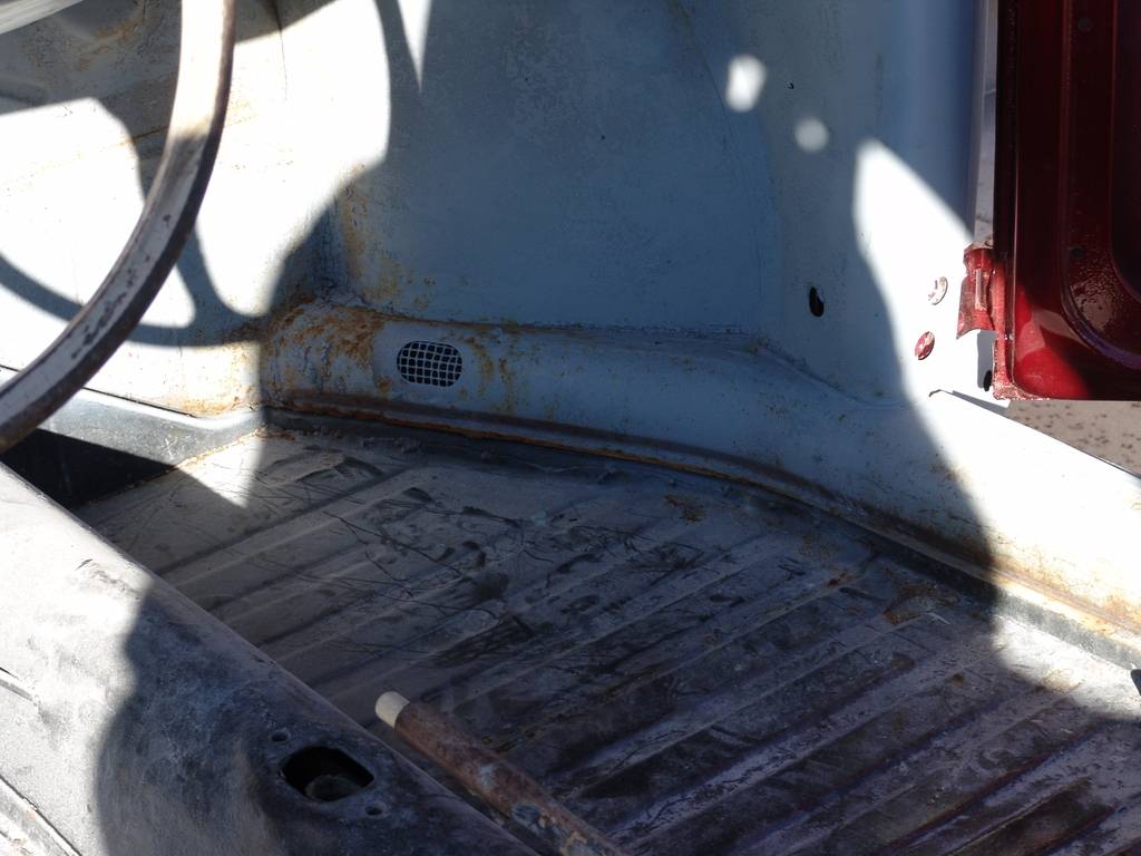

Mr. Woody, are you talking about the bulge in my 54 like the one in this picture used by "Billmetric" in a thread? Right below the tool box shelf, above the inspection cover whole..Ive looked through the gallery and found some are flat and some have a degree that pops out on the sides and come out a bit..I think my baby girl is okay..

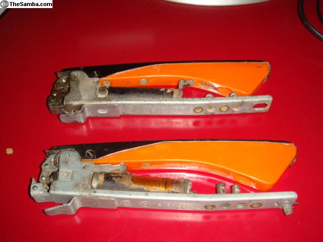

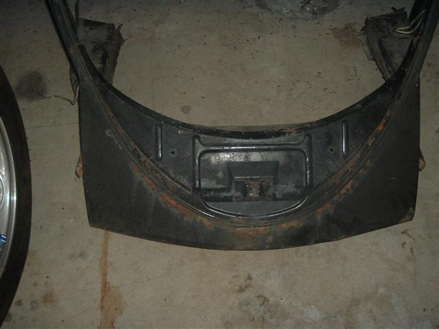

Heres the replacement for the rear apron...Its an OG Rear H Apron section..removed with care..and being installed onto my girl..
Here are the OG front fenders I picked up and are replacing the ones you see on her front clip..First the Drivers Side:
Now the Passengers Side:
And both have the tubes behind the buckets and great flares at the running boards..Next is the OG 53-54 Right Rear Dimpled Fender..someone drilled holes for later tail lights..but you can see in the second photo where the OG holes were before someone covered them up..
Here are the correct rear seat set thats going in as well..
And last but not least for updates is the SHO semis..remember, the ones with the yellow lenses are SHO 12 Volt, what I have to do is take the SHO 6 Volt semis orange lenses off and covers and put them on my 12 Volt pair..Then I should be okay..So I will have a nice pair of SHO 6 Volts on the side, as well as SHO Yellow lenses..
Well thats where Im at for parts that are already at the shop and some that are in route to her...As far as whats happening right now..her front beam is getting removed and a 3" Narrowed Selecta Drop Beam will be installed..the rear will be lowered the old school way a little, no lowering plates..Just wanted to say what was going on for now..Take care..Ill be adding some stuff just to make her a little different as well, but the parts will be OG..and not all of them in my gallery..Dont know what Im going to do with the 56 Huls Seat Recliners just yet..Im looking for the early ones.. Wink
