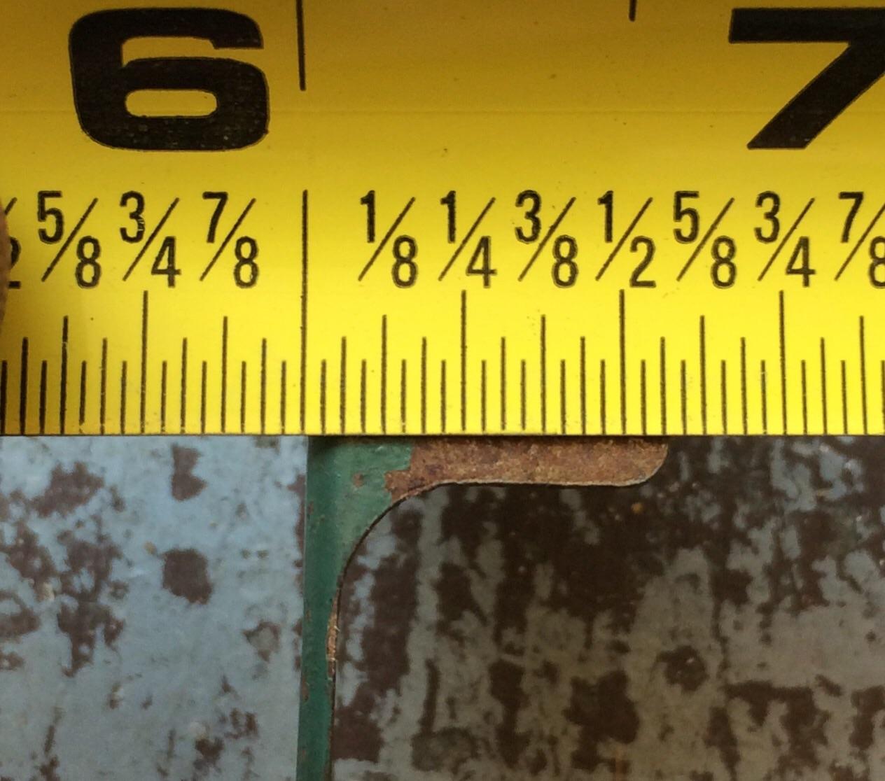

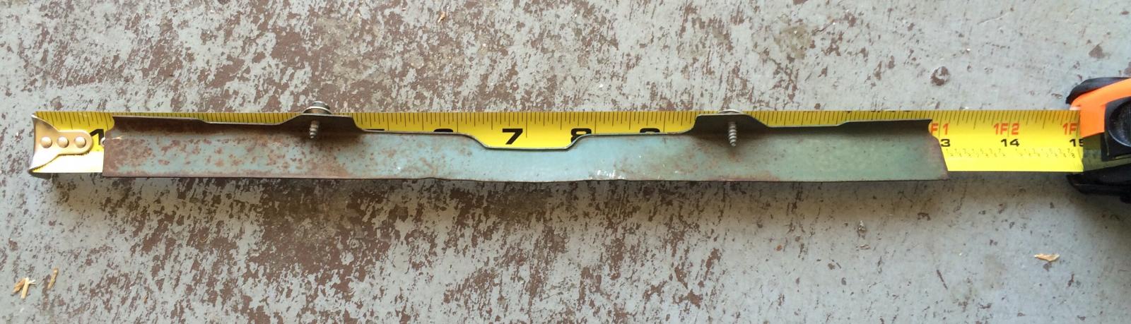

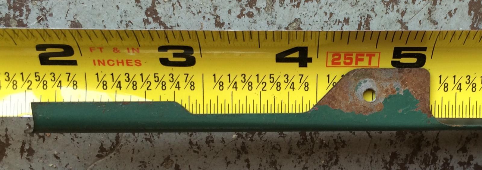

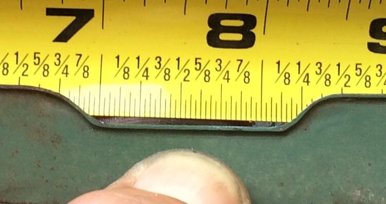

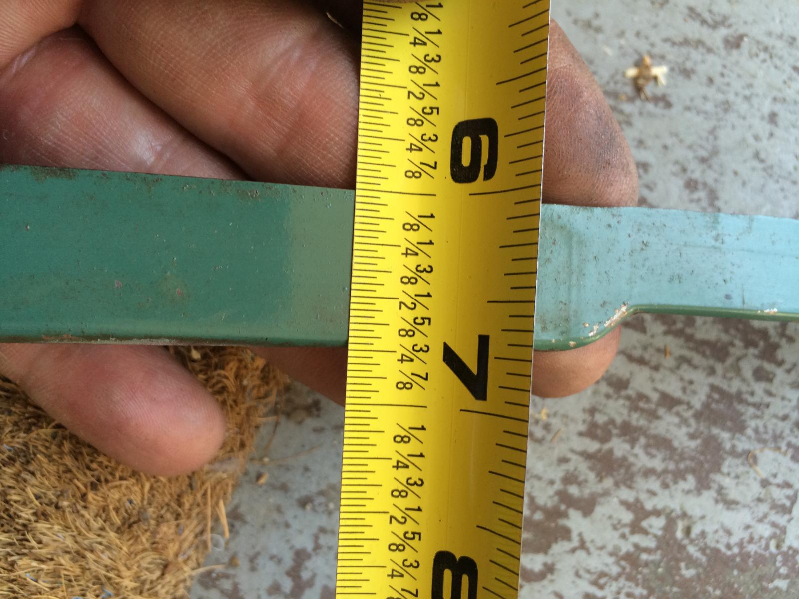

I've added interior paneling to my panel bus & like the finishing trim found on some other models. In looking for the trim piece, I've found many spot welded in place. I believe loose ones are harder to find... and are held in place only by two screws attaching it to the door panel.
I'm posting this in case anyone wants to make the piece. Forgive the mix-n-match of metric & imperial units. I started with tape measure & migrated to calipers.
e
As delivered look (minus being paint mismatch)...
