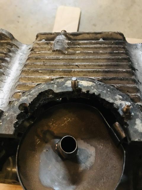

Has anyone seen this before? Any thoughts on if it’s toast or how I could repair it?

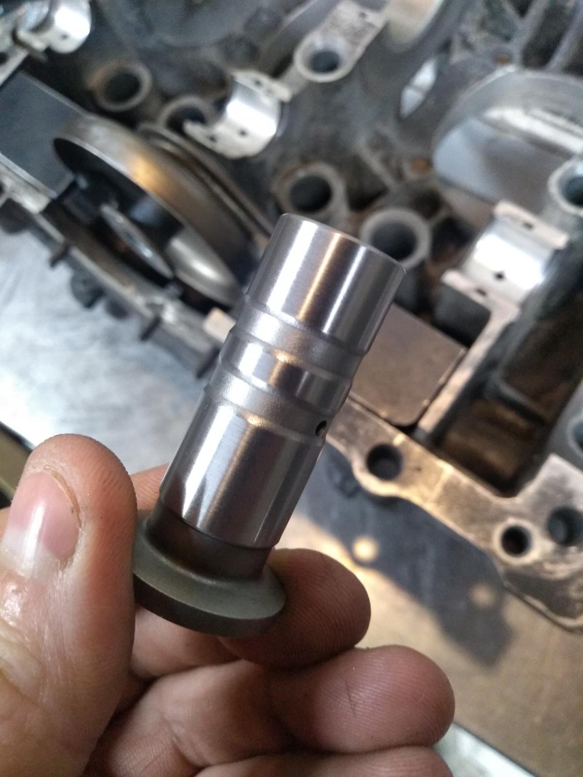

I'd say that might be close to a goner, if not a goner. I had some minor corrosion of a very similar style, just less advanced. I made surfacing tool to level it, and did what I could. In addition, instead of using m6 studs, I through-bolted from the inside of the case with a longer m6 bolt, just so the "case meat" was sandwiched between the bolt head and sump plate.
You can kinda see my "bolt-studs" in the lifter picture

got one worse then that ! caused by moisture, from oil not burning it off, forming acid, or just condensation and water getting in engine, water is heavier goes to bottom, why you should change oil every year even if it's not run, especially in damp climates.

thanks for the reply, any idea what caused this?

car had been sitting for several years before I got it, cylinders were froze so was/am in the process of rebuilding and found this. I'm thinking of making some metal split gaskets placing one inside with bolts through holding each half in place and one on the outside and filling void with JB weld. Am I nuts?

https://www.thesamba.com/vw/forum/viewtopic.php?t=505703

Yes, see link above, it has been done several times before.
If you can afford the Belzona product, it would be better, but it’s about $200 for the same amount as a $6 JB Weld package
