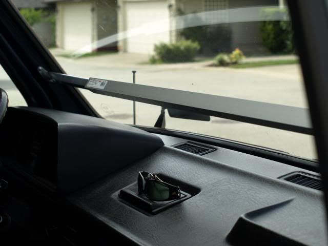

So far here's what I've done. Instead of welding, I went to home depot and found a aluminum 1" square tube, there's a steel ones too but heavy and will flex. Cut the X bar in half and shove it in the tube from the depot. later on I will drill a small hole and screw it on for security.
Now I have the adjustable bar Wink
Here's the hardware, for now I'll use the screws that came with it.
Measured and screwed one side first before I got the right angle. I placed a sticky foam in there too to prevent scratch on the paint from the bar ends.
Front side done.
Here's the back. I wasn't sure of the bracket angle but I tested it and it seems fine. the front seats are as far as it can go back, the most space I can get with out taking the headrest off. I just don't want to do that hassle when it's time to set the cot up. I should've angle the bracket a bit more. Mad
Pic from the back side. With the square tube I can't get anymore lower..headrest is on the way, trying to leave a bit of gap between the bar and the headrest.

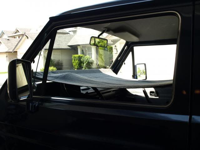

Maybe it's the camera angle but isn't the front bar too low for the cot to clear the instrument pod and steering wheel?

PostPosted: Thu May 16, 2013 2:13 pm    Post subject: Reply with quote
Must be the camera angle.. I just installed the cot and it's even not as tight as I wanted and still clear the cluster. It seats just above the steering wheel.
Now off camping with the kids;)

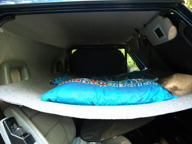

PostPosted: Fri May 17, 2013 1:51 pm    Post subject: Reply with quote
Finished it yesterday and took my boys camping overnight. My 6 yr old slept on it and no complaint, he loves it;)
