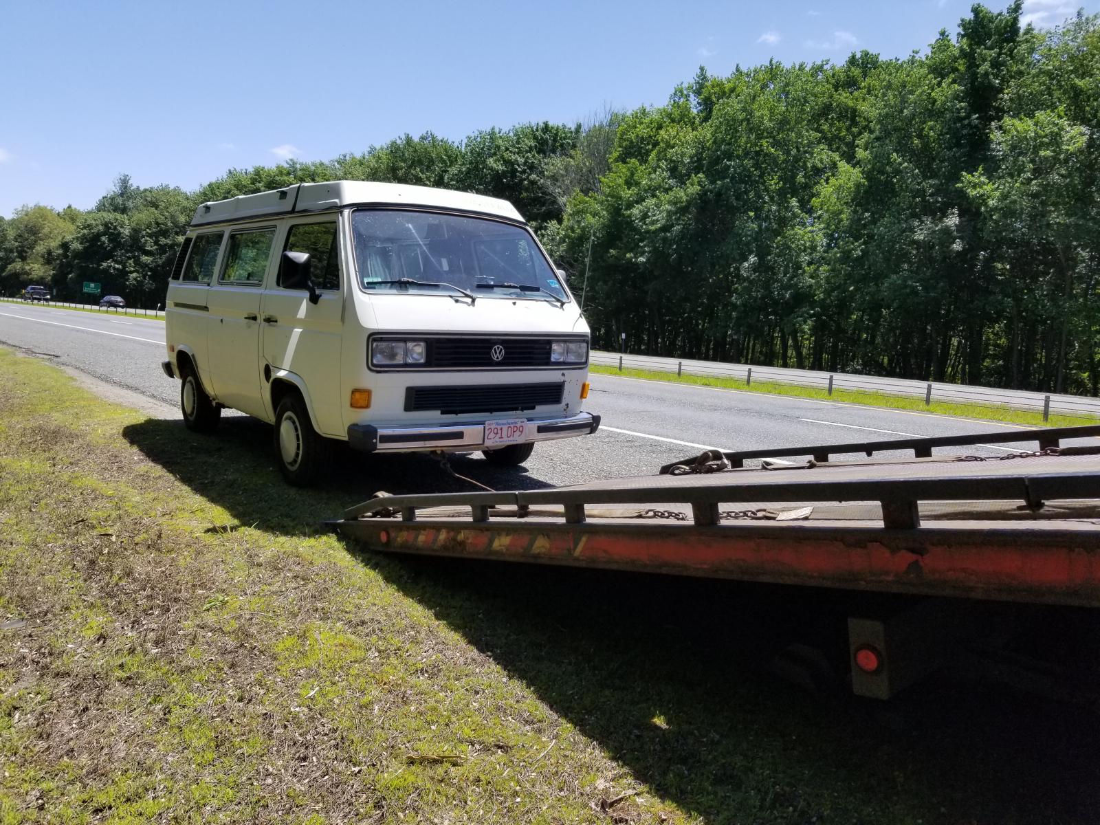

Well with the help of a friend and his truck I rented a Uhaul flat bead trailer and we headed up to my grandparents house to load it up.
one last picture of the 1987 Westy and the 1985 westy together in my grandparents yard we used the 87 as a test load just to see how things sat on the trailer
loaded up and ready to move due to the cracks in the front tires exposing the steal cords we let the air out of the front tires and strapped it down like that to make sure there werent any issues in transport

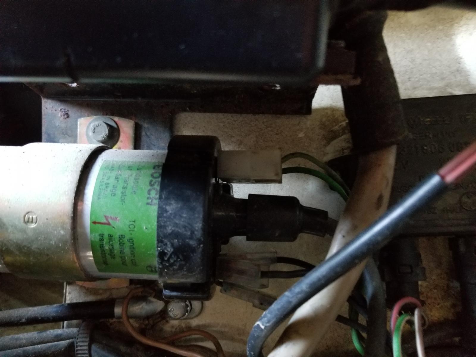

So my goal was to get the Westy running so that I could move it around the yard, I drained the 12 year old gas and got some fresh gas in it and decided I should check the valve adjustment and found one of the big reasons for the lack of running was due to 5 of the 8 pushrods not being seated in the lifters so I reseated them. Next was cleaning all of the ground wires and replacing the bolts.
I did also clean the trans ground strap and replace that bolt as well, I was poking at it and tried to start it with the 12 year old autozone battery I had brought back to like but it did not seem to hold a good charge suprise suprise so I replaced the batter and was in the engine compartment with the remote starter switch and the voltmeter poking and found when I poaked the green coil wires I got a real sputter

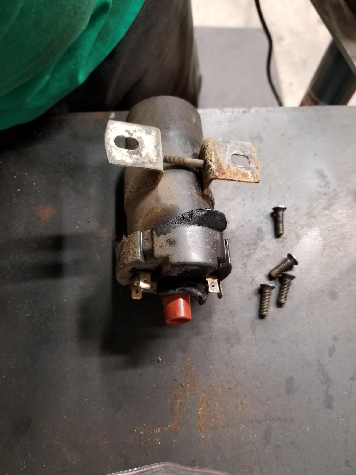

Next after realizing what was causing issues with the not starting was the double connector and was able to get the van to run not well and not controlled but there was noise and fury.

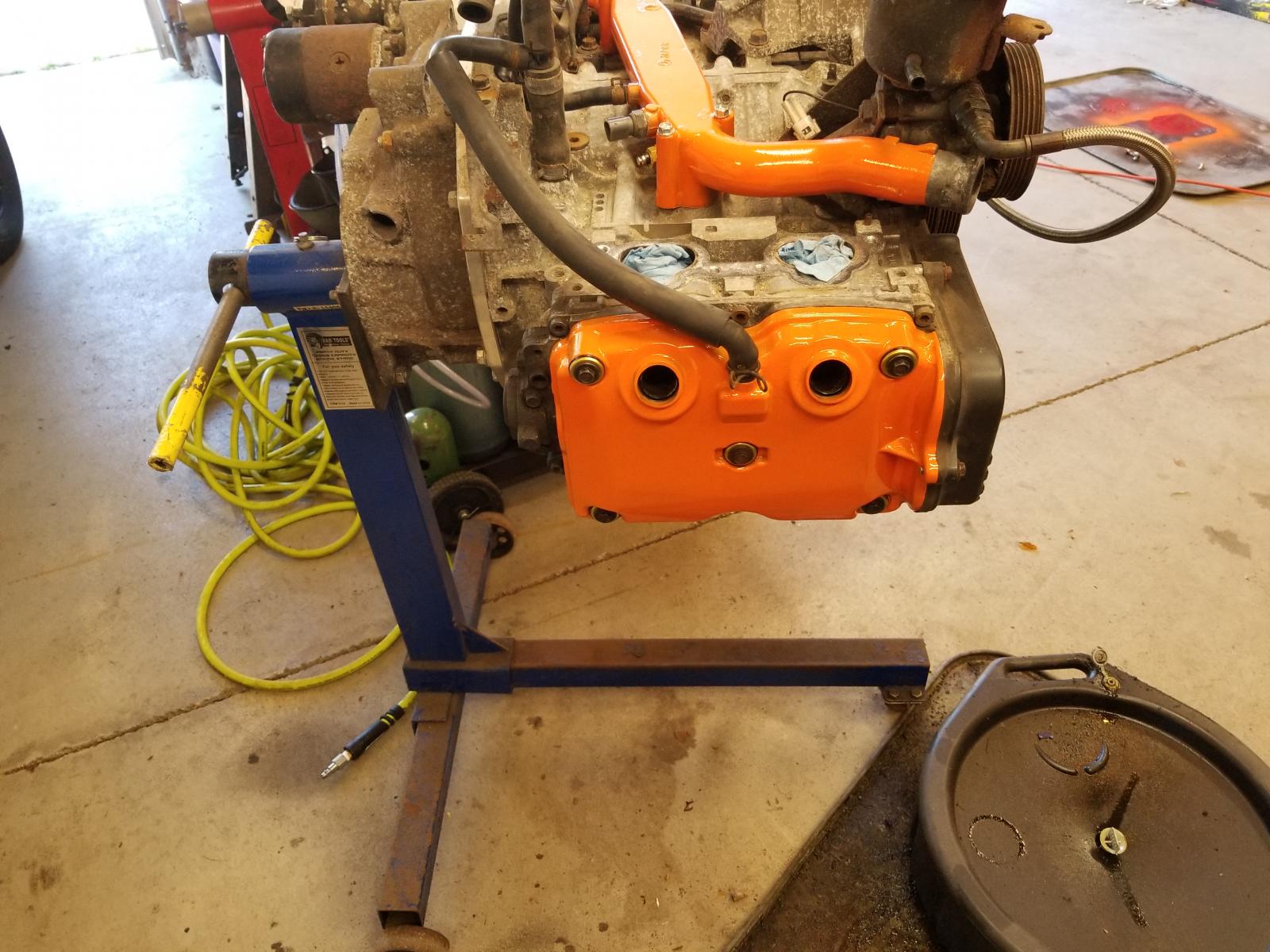

Spent some time working on the exhaust for the subaru engine, I had a brand new muffler cat and rest of the exhaust for a 1.9 so I used these components to work on the exhaust.
I built a bracket that uses 2 unused holes in the head one top and one bottom to support the muffler and one exhaust bolt being a fase 2.2 from an impreza it has the single port exhaust headers and I plan to build my own header.
Here it is with the small car non reversed coolant pipes

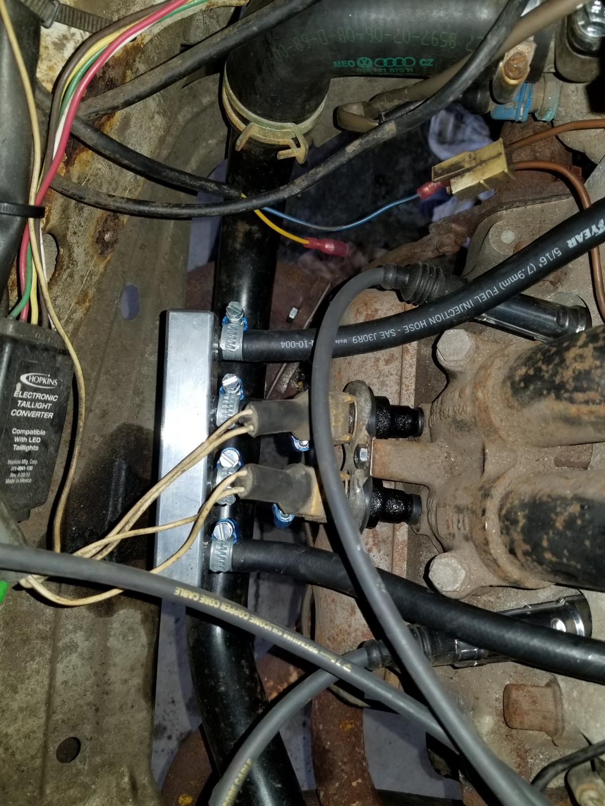

since I have been running the van a bit to move it around the driveway it has started to not want to do much more than idol I swapped in a new fuel filter and cut open the old one to find a fair amount of rust in it making me decide it needs replacement instead of cleaning. I opted to go with a late tank with the larger outlet to help the suction side of the pump and will be putting the later fuel filter in just need to find the bracket or get one.

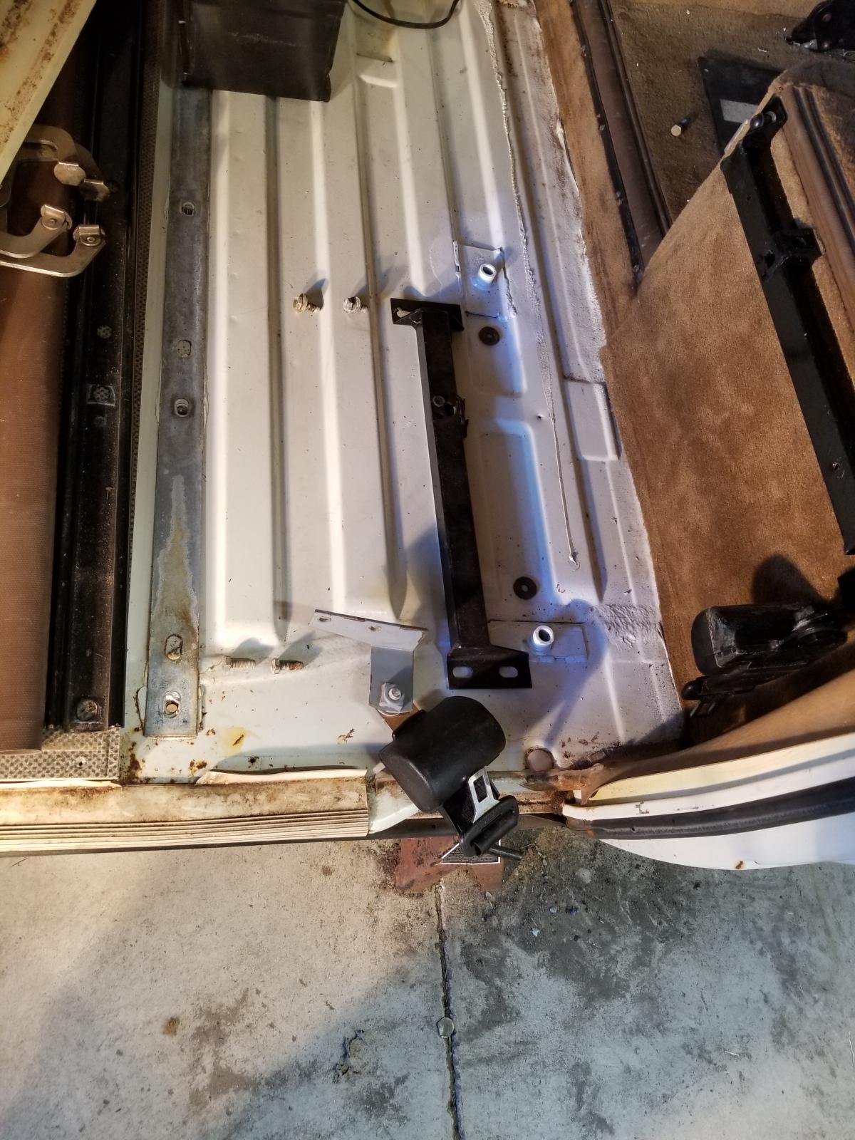

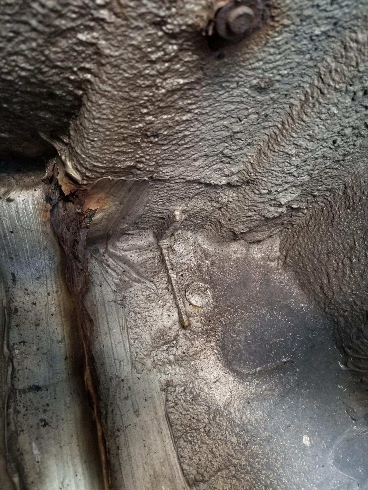

So last weekends goal was to replace the gas tank with a brand new one and also to install the hardware for a Jump seat while the tank was out.
Fortunately this is a 1985 which has the floor split into a couple of pieces for the middle seat rails after pulling the steel angle iron one screw and the forward seat rail I was able to pull the section of the floor out.

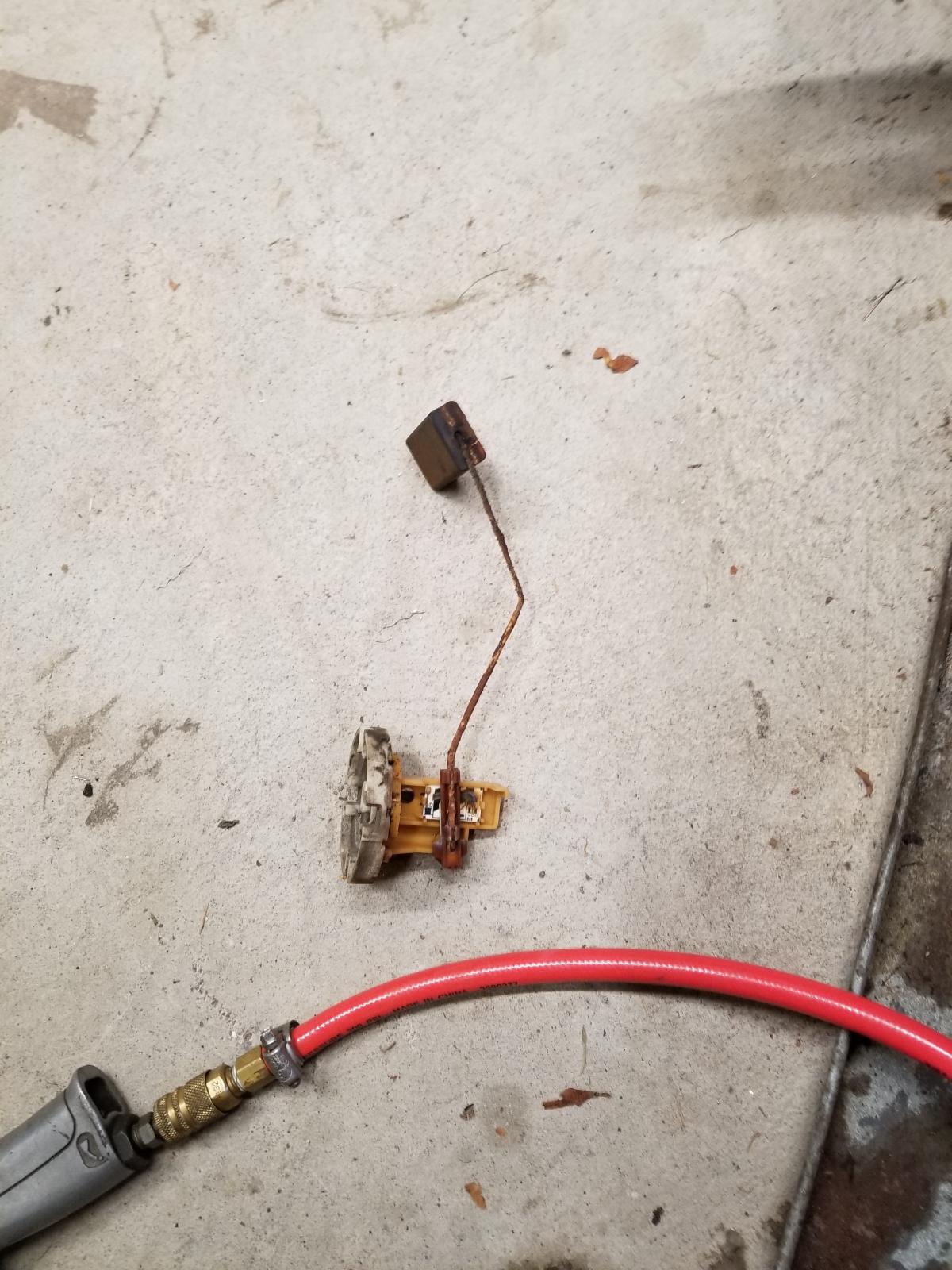

After removing the old tank I pulled out the level sensor in hopes of re using but found it very rusty and not moving freely, so after airing out the garage from the fuel and putting the rusty tank outside and emptying it of rusty fuel that would be all for the gas tank for the day.
My Syncro is a Factory Base model so it was my reference to help me locate the jump seat in the sety by measuring the right post.
I had cut out a set of factory jump seat receivers and the bracket from a van a friend was scrapping out and cleaned them up for install just like factory
After locating the right mount with measurements I tacked welded it in then put the seat in to make sure left receiver was spaced out correctly. There are 2 versions of the Jump seat set up the ones found in Caratโ€™s that have Grey seat frames and receivers up high have 2 round posts in the floor and the ones found in 1990 base models have black frames and one circular and one oval receiver in the floor.
After the 2 floor receivers were welded in it was time to concentrate on the receiver on the battery box I again consulted the Syncro for guidance:
I used some angle Iron and 4 M8 nuts to build the support brackets to help sandwitch more metal and spread out the load like the factory did
I did clamp the back bracket in place and installed the seat to get the location of the 4 holes and marked them drilling them out and bolting it in place temporarily to weld the 2 bracket in place one in the wheel well and the battery compartment
Here is a picture of the bracket and hardware used to mount the rear bracket there are 4 bolts used with 2 washers on the inside and the seat belt bracket on the outboard side there are 4 thick heavy washers used to provide a gap for the carpet to make sure everything is tight metal to metal and the carpet does not affect anything.
Finally a picture of the seat all set, (just need to bolt in the receiver under the front seat belt receiver.

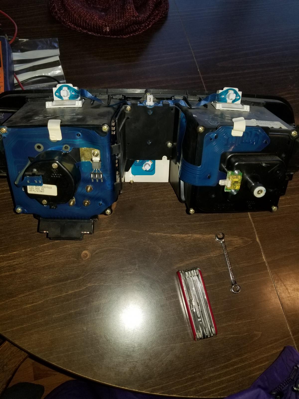

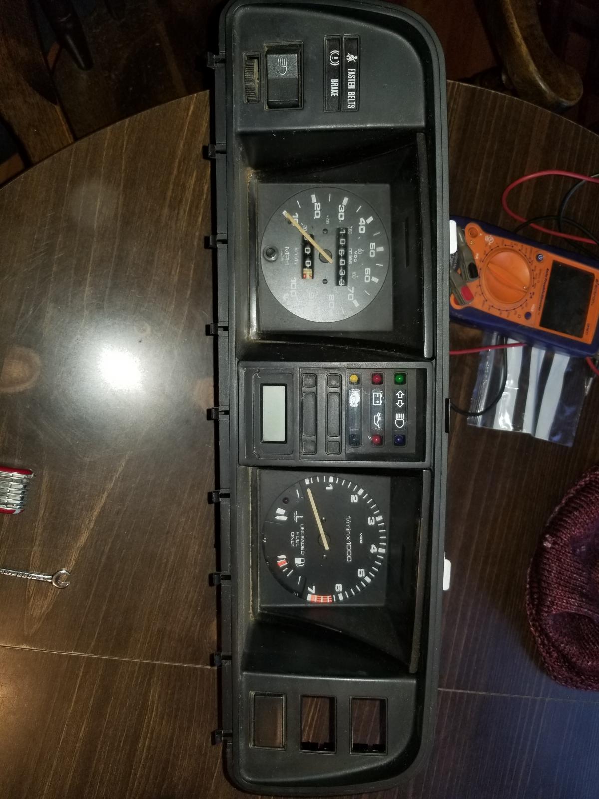

Well I have still been busy working on the jump seat and the Subaru conversion I was not a fan of the exhausts on the market especially for the single port EJ22's. As I had already made my own muffler bracket I took on making my own header, I still need to shorten the drivers side as it is a little long and at the moment touches the motor mount with the engine hanger in full drop.
here is the waste on the floor:
I also built the cluster based on the original out of the van using one of my 7000 RPM Tach's, a yellow LED, a small car face plate, and a Fast forward VSS pick up.
I also finished getting the floor installed and the jump seat looking good.

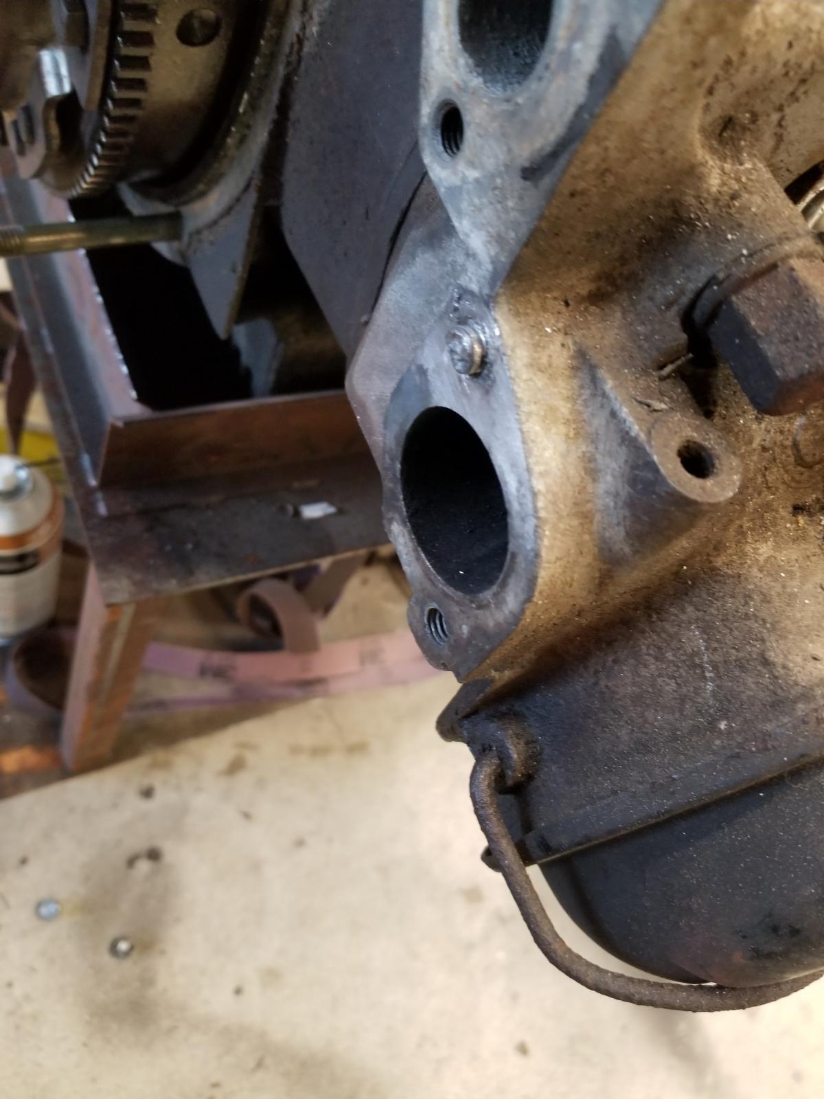

one of a number of issues was a rusted out cross over pipe that started pissing coolant after flicking it with a screw driver
the coil loosing its oil:
8 broken bolts and studs that had to be extracted, we worked on this exhaust stud for 2 hours before deciding to install my spare engine
which had some other issues and required a lift home
I did install a set of cleaned injectors as well as Van-Cafe billet fuel rails

So last fall I picked up a set of Alloy wheels for the Westy this spring I cleaned them up and bought 5 new tires and had them mounted because the Westy is not really derivable I decided to put them on the Syncro and enjoy them for a while. now that progress is happening I need to put the Vanco's on the steel wheels back on the Syncro so that the Alloy wheels can be put on the westy.
at work I asked for a little help from the tool maker and he helped me take a 2000 coolant manifold and mill the added sensor boss flat and drill and tap it for the VW gauge sensor
style used for modification:
proper gauge sender installed in the coolant manifold:
I have also been working on painting some parts of the donor engine to make it look prity
today at 2:00 I had a running 1.9 wasserboxer still in the van one last start and run to take a video
and I finished the day with a very empty engine compartment time to put the engine in tomorrow:
