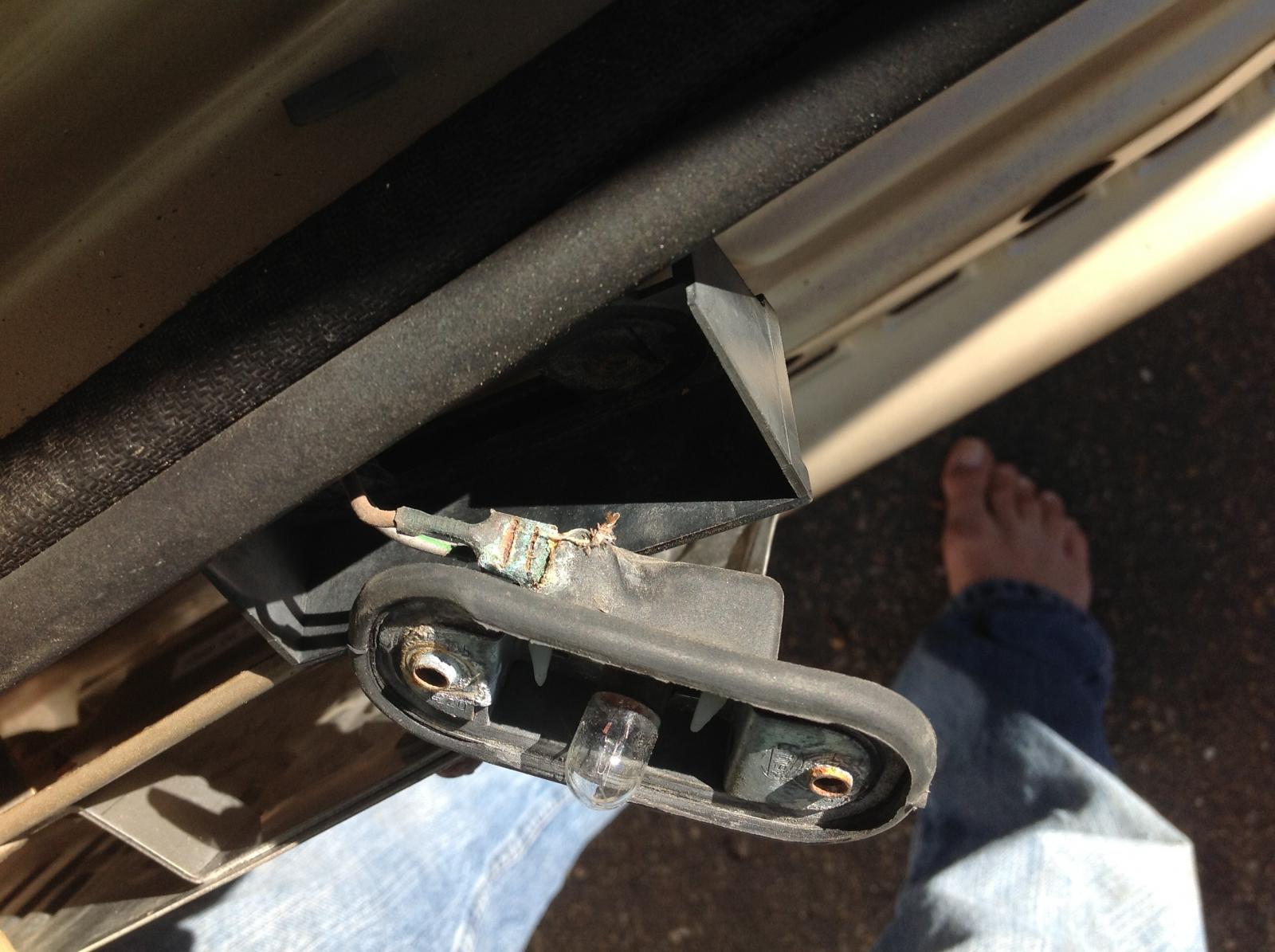

Disassembling license plate, rear side marker and taillights for some sandblasting and minor rust repairs.
Again.......... extreme corrosion!
I ended up cutting the terminals from the wires rather than risk breaking the light sockets!........I'll install new terminals......
Interesting, one tail light, no corrosion, the other...... Corrosion ONLY ON THE BROWN GROUND WIRE TERMINAL.
Why? Why the ground wire? There is no dissimilar metal contact here, brass to brass.???.......

ragnarhairybreeks
Joined: October 26, 2009
Posts: 1945
Location: Sidney B.C. Canada
ragnarhairybreeks is offline
PostPosted: Sat Oct 12, 2013 4:44 pm    Post subject: Reply with quote
The reason you are finding corrosion on the ground connections is due to the electrons that have just passed through the device being powered telling the electrons in the metal contact just how much fun the ride was. So the valence electrons of the metal join up and head on to the battery.
The metal contact loses electrons, oxidation, and thus corrosion is the result.

There is no Ground system on an automobile, the chassis is a return path. The vehicle is isolated from ground effectively by the rubber tires. As badly corroded as your return system is it indicates something sacrificial is occurring with the chassis. Perhaps you can utilize a sacrificial zinc electrode to act as an anode tied directly to the ground terminal of your battery and alternator. It will deplete instead of your ground corroding.
There is enough difference in the reactivity of the metals in the pins and wire terminals to cause corrosion due to the current flow. Galvanic corrosion requires current flow, it can be self induced flow or can be applied by an exterior force such as your charging system.
I am just glad I chose years ago not to live in a part of the country that uses road salts. Wink

Wildthings wrote:
Ok...... So preventative steps to take once I clean everything would be......???
I'm guessing generous application of dielectric grease?
Dave
