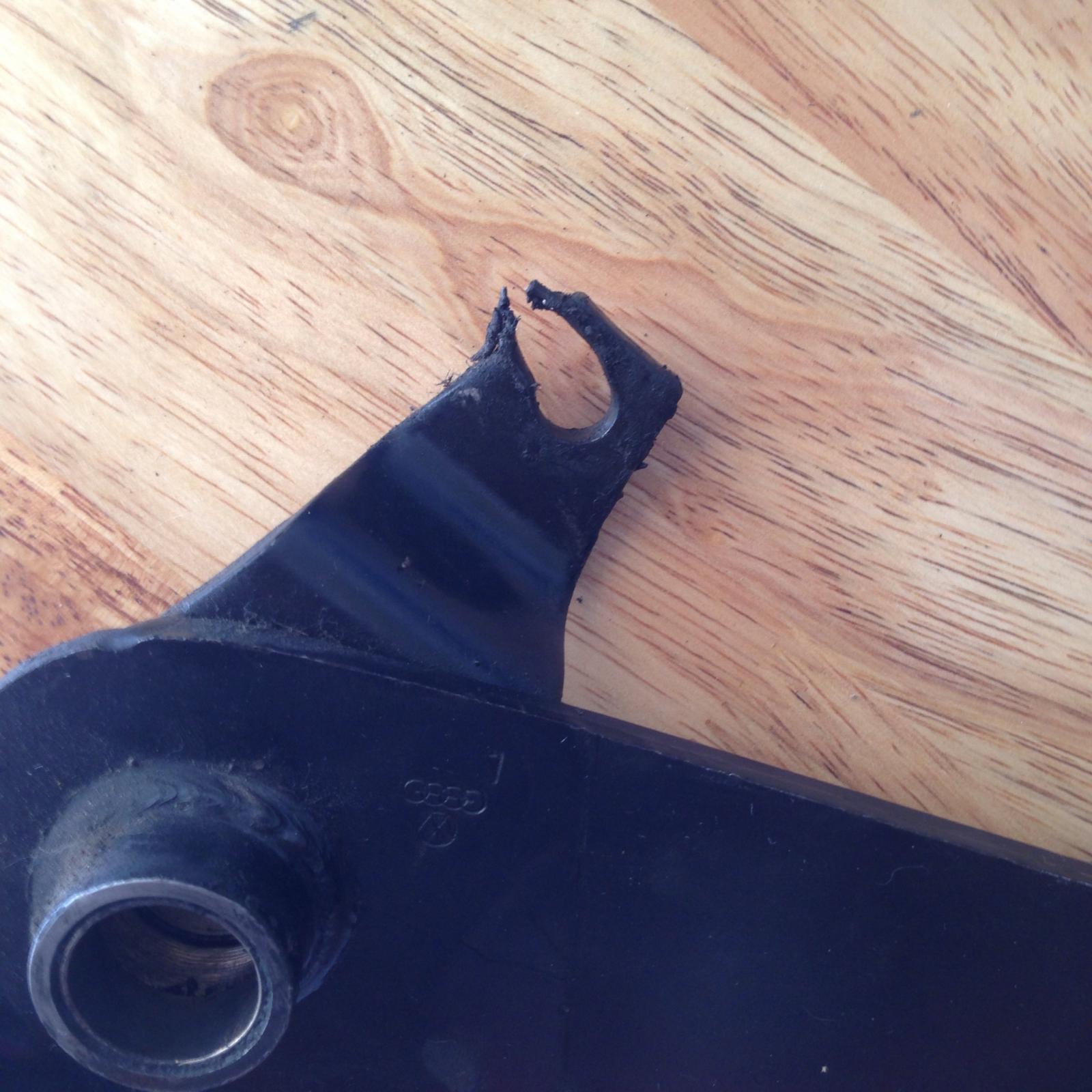

So I just did this job at Blue North Westy's in Calgary on the start of my summer trip. I was lucky enough to get a rehab pedal that syncrodoka made up and had it with me for the trip on a premonition.
Here is what I took out, not too bad but bad enough that my catch point was almost at the floor.
One thing I noted in doing this per the instructions. The shaft did not move with my finger, it was too tight, I had to use a long needle nose pliers to move it. In order to push it back I had to use the heavy ratchet handle end from a 3/4 drive as a 'hammer' and tap it back a gazzillion times.
But the most important thing I learned is that the roll pin at the brake pedal end of the shaft can hit a weld on the brake pedal if is at 3 (or 9) o'clock. That will not allow the shaft to fully go back and will not allow enough of the groove on the clutch pedal end to accept the circlip. I had to roate the roll pin to be straight down and then all was well. I hope this helps some in the same boat.

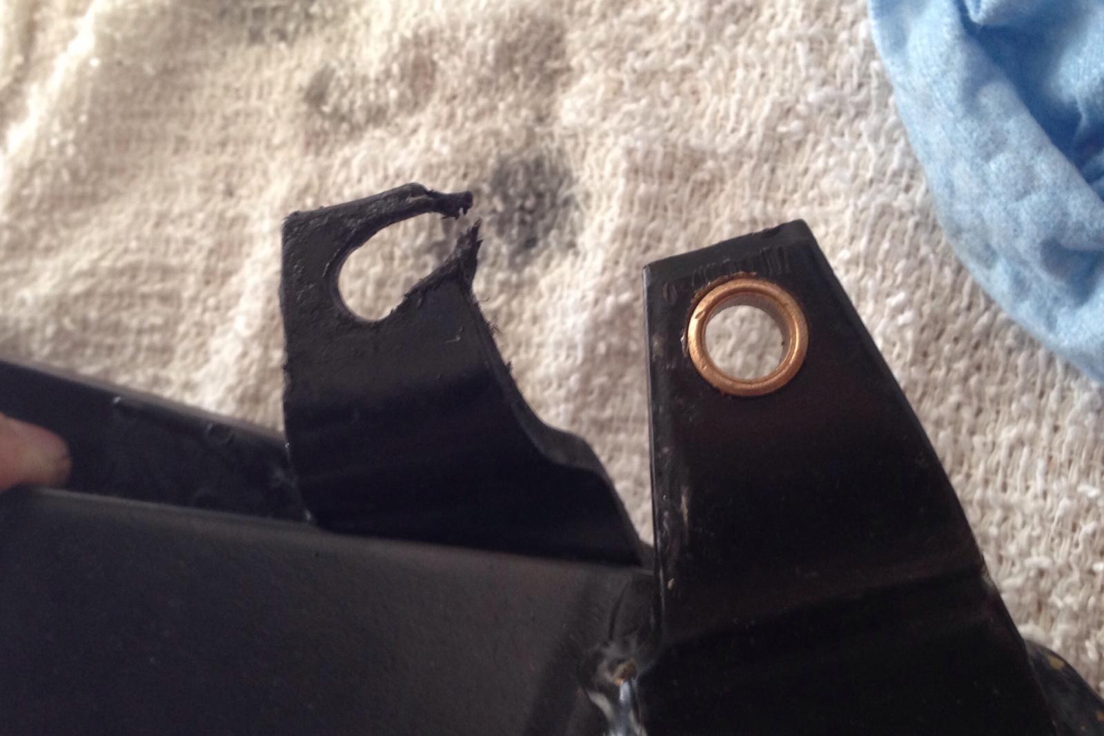

Good timing on this thread bump. I just did this job on Thursday. 40 mins to drop the old pedal out per the above instructions. So glad I did, look how close the clevis was to breaking through! The scary part is my clutch engaged and disengaged pretty well. The only real sign was some minor squeeking and about and inch of play in the pedal. Took about an hour to get the new pedal in mostly. But it took me quite a while to get that circlip into place. Man that's a tight fit up there. Clutch action is like butter now. Thanks to all those who posted above, this would have undoubtedly put a damper on our road trip next month when the clutch failed.
