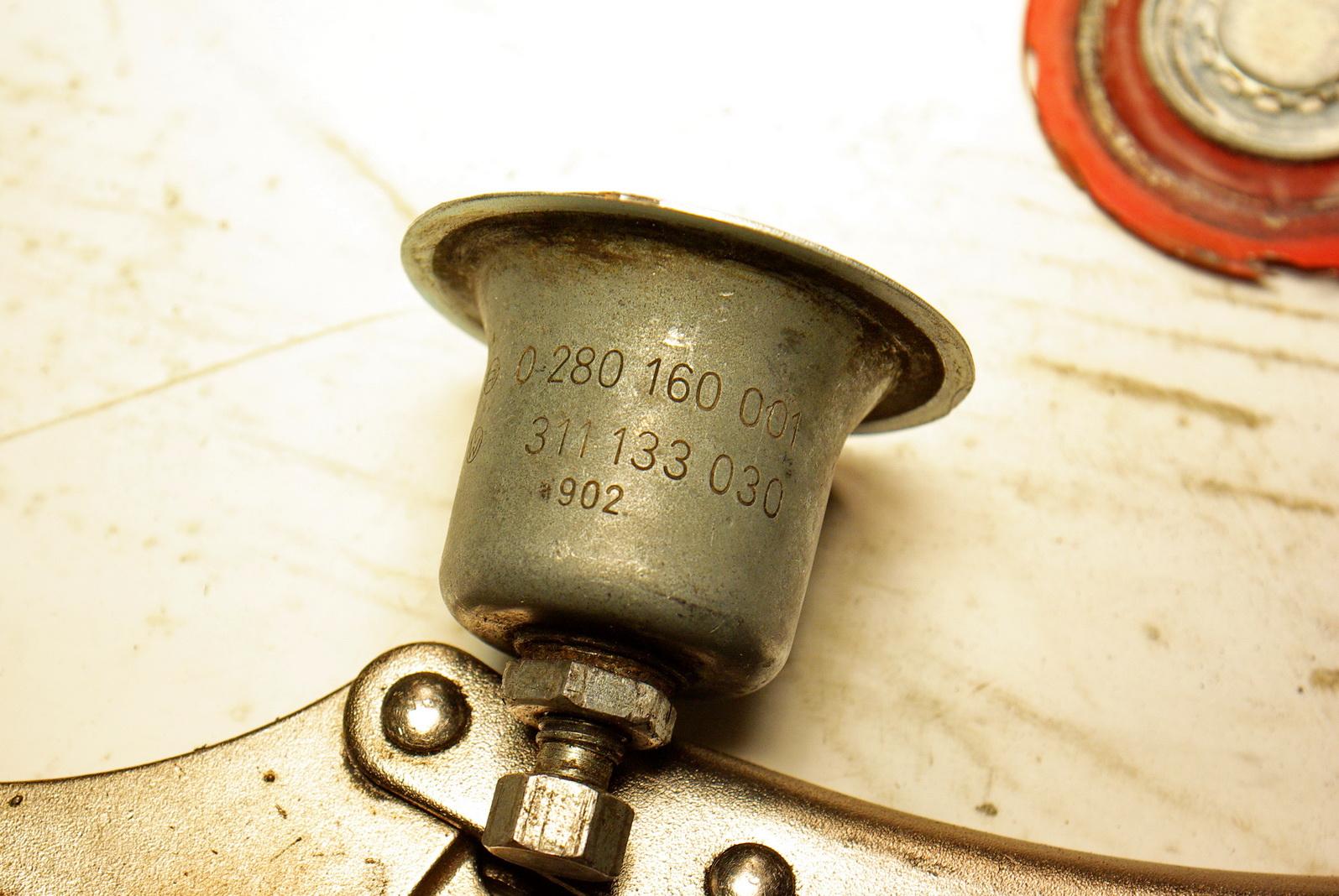

The gallery Part # 0 280 160 001 / 311 133 030 :
Historic note about this fuel pressure regulator: This one lasted quite a while and was installed after I had sorted out injection timing and fuel pressure issues.
After about 1 year…about 60K+ miles….it started leaking down excessively. Immediate drop to about 19 psi after shutdown and morning after readings of about 6-8 psi. I figured it was a rust fleck or vibrational wear starting.
The pressure drop never got worse because I was backstopping it with another worn regulator (good trick) set to about 3-4 psi less. But when it got to the point that at idle it would develop a harmonic hum…I got a new one….so….let’s see what is inside.
This is the top/spring side.

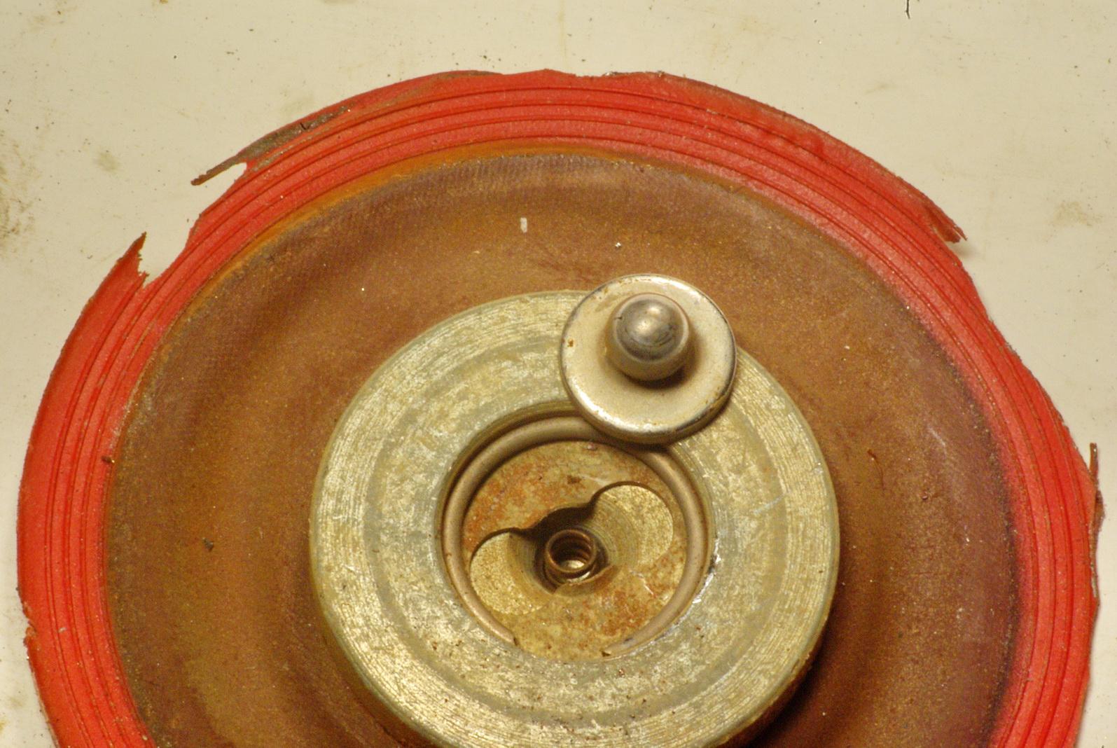

Looking into the top half showing the spring, the spring seat and the adjusting screw in the center
Spring removed
Spring and seat

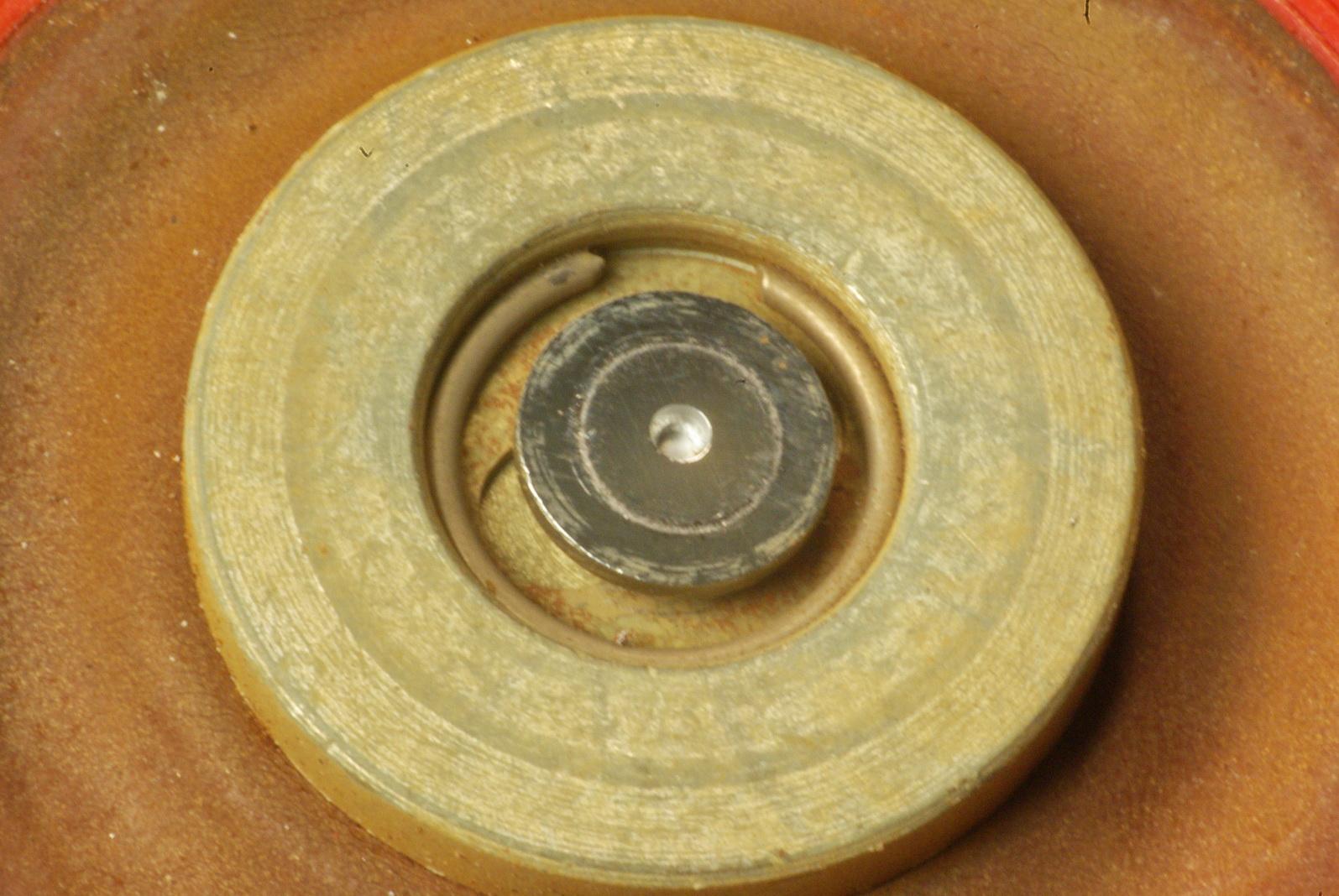

Diaphragm, spring and seat. Notice the detail of how well the diaphragm is crimped to the spring seat. These are very well made.
The metal button in the center is the metering plate. A very useful design feature is that the metering plate is installed in a clip with a spring and has a ball guide on the back…so the metering plate is self-correcting for any angle so it has precision fit against the outlet orifice. Very well designed.
A close view. The ring you see on the metering plate….is primarily EROSION…..and some corrosion. This is mainly from the harmonic wear I spoke of earlier.
A 60x microscope shot
A series of three 220x microscope shots of different segments of the erosion ring.

By the way......and I meant to post this point back when I originally posted yhis thread and the regulator microscope shots.
When I showed the black flecks of rust on the machined metering outlet of the regulator.......I meant to "get back to" the reasons they look so deep and black like they are.
The very shiny surface of that metering outlet orifice......is either nickel electroplate or "electroless" nickel plate.
This is significant because:
1. Nickel plating DOES NOT RUST.......
2. Nickel plating....especially electroless nickel plate.......is very, very hard and wear resistant after they plate it and bake it. Like about 70+ Rockwell.
3. The problem is.....that unlike a zinc plating which is a sacrifical anode and prevents rusting over a wide area......but is too soft of a metal for a high frequency wear area like this..........nickel is NOT a sacrifical anode.
The nickel itself will NEVER rust. BUT......if the plating is cracked, chipped or gouged to make any kind of opening through the plating to the metal below........the metal underneath the nickel plating.....will rust in all directions.....creating a crater or erosion cavity behind the nickel plate.....and eventually there is no metal left to support the nickel plate.....and that spot cracks asay leaving the effect you see in those microscope shots.
So what causes the original cracks in the nickel plating inside of the regulator?
I suspect......that its just the violence of the millions of cycles of harmonic opening and closing.
But.....its also the fact that these were PROBABLY....nickel ELECTROPLATED back in the day......and not ELECTROLESS nickel plated.
Those fine machine marks are little valleys. When you are doing electroplating.....the current follows the path of least resistance. It would tend to flow to the high peaks of those fine machine marks.....depositing thicker nickel there....and thinner nickel in the valleys.
Electroless nickel.....does not use electricity. It uses an acid or base mixture to cause electrochemical reaction at the surface of the ferrous metal part you are plating. In short....it makes its own electricity for plating.
So.....the electroless nickel plate.....gives a surface thickness uniformity that is many times better than standard nickel electroplate.
Its also damn expensive....solution wise..... and was probably not in as wide of use back in the 1960s. Ray
