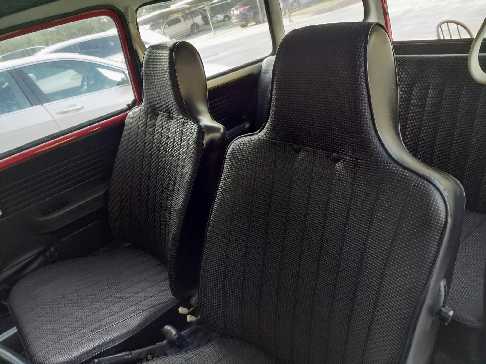

Hey guys, Just picked up this little guy today.
This would be my very first type 3, after owning 4 Type 1 Beetles over the past 6 years.
Lets have a little history of the car.
Sat in a storage unit since 2008, It was found as a single owner car at an auction (for the storage unit) A local transmission shop purchased it, and rebuilt the transmission.
They could not get the Fuel Injection system to work so they cleaned the gas tank and put on some Empi dual 34 EPC carbs.
Seems like the seats, carpet, upholstery are all OG.
Right now, it runs like absolute crap however still manages to drive and shift fine. Due to the carbs saying "not usable for vacuum advance distributors" I assume I should swap out the factory FI distributor for a 009?
I got the carbs to sync up however it tends to idle at 1,200-1,300 rpms, then drops down to a "really rough feeling" 850-900 RPMs when in Drive or reverse (at idle)
Any thoughts, comments, and things to look out for would be really appreciated.

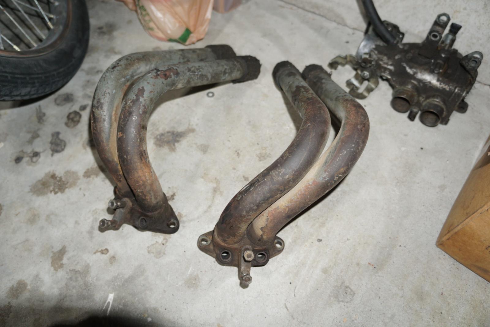

No 009.
Let's get the fuel injection and a correct exhaust on that puppy. I can help you with parts.
You'll be glad you did.

I have to agree 100% with Tram. The AT cars seem to run/work better with FI than carbs. I'm not saying they can't work with carbs, but the seem to perform better with injection.
Also, that is the absolute worst muffler you can put on a type 3, especially a Squareback. They reduce HP, and let fumes into the car thru the rear hatch seals. Just a heads up.

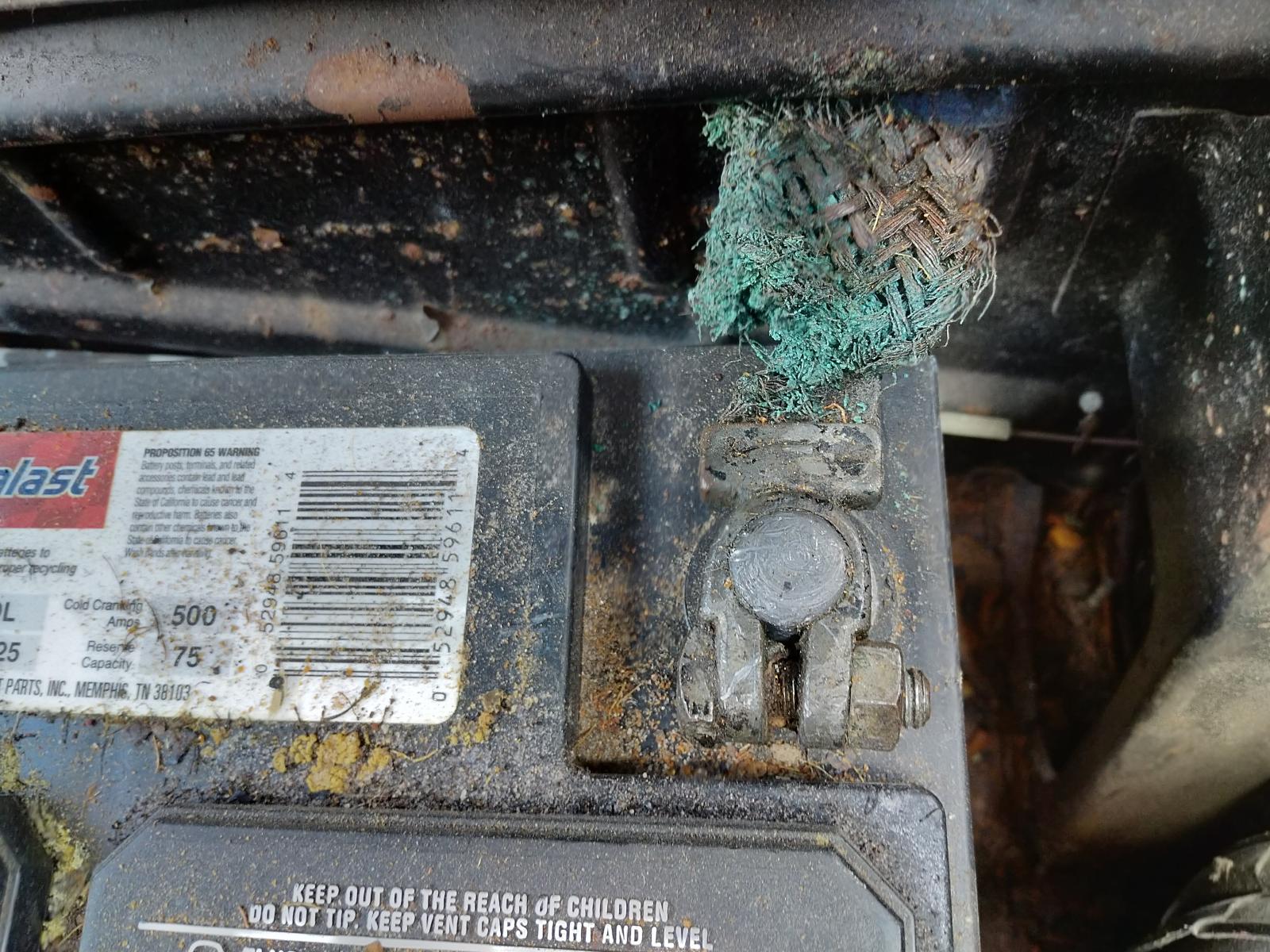

I will need a new ground strap.

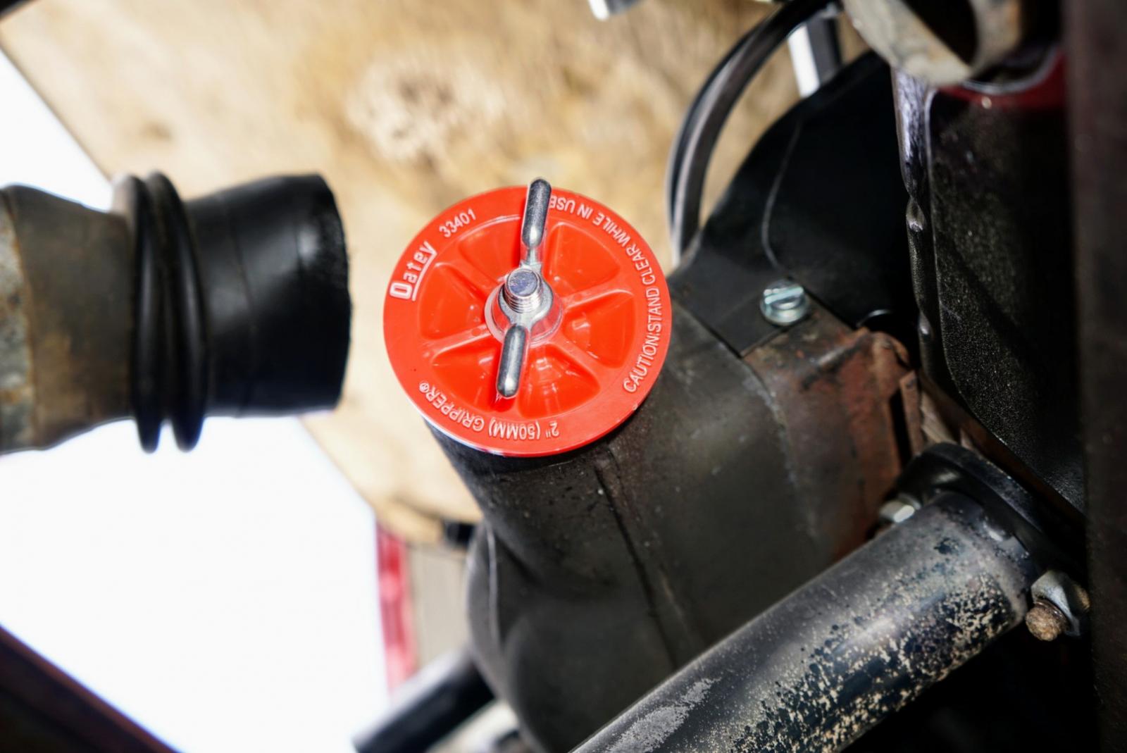

Installed a new fan air intake boot from WCM as the old one was torn in various spots.
Also installed fan shroud block off plugs as the heaterboxes are not connected.
Old boot:
New boot:
Block off plugs:
