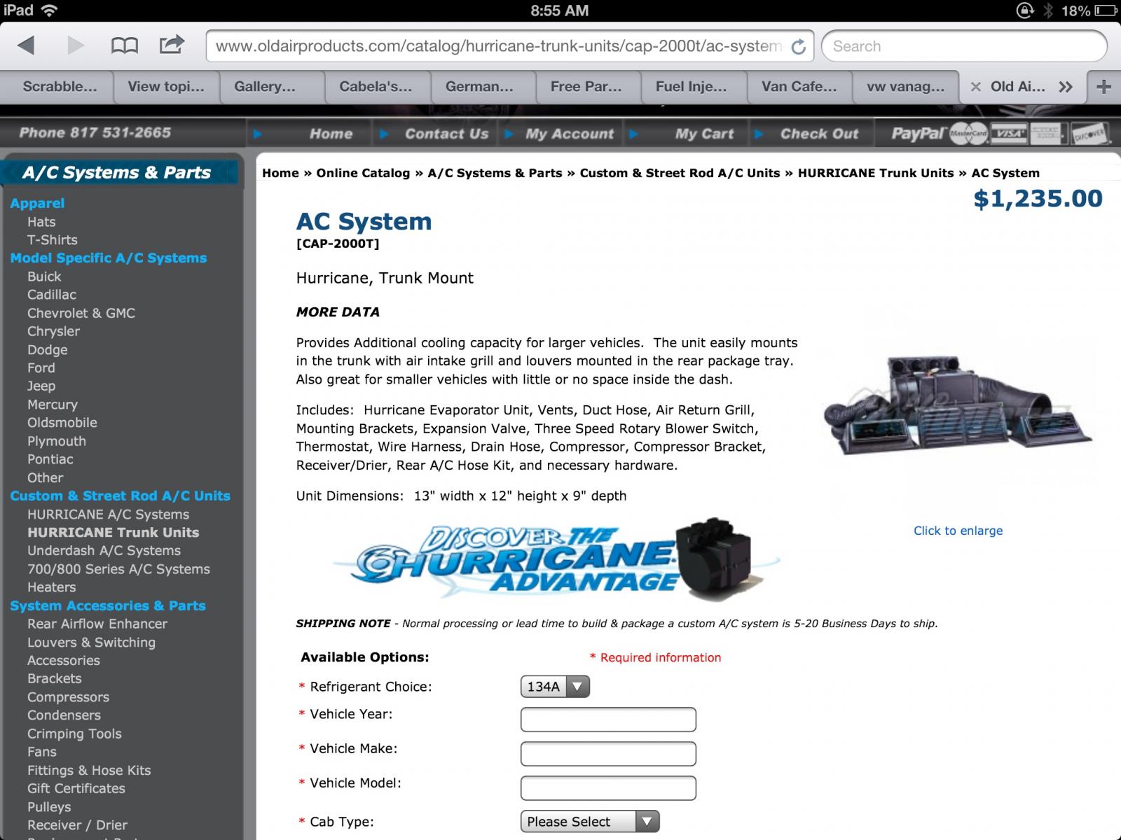

I've located another unit that doesn't have the heater core in it and is just AC. The unit is the same height and depth but is only 13" long...........
It is from Old Air Products and just the Evaporator IP2000-T is $575, well above Vintage Airs unit at $375!
Excuse the picture, best that is available but it looks very similar to the Vintage Air unit.........

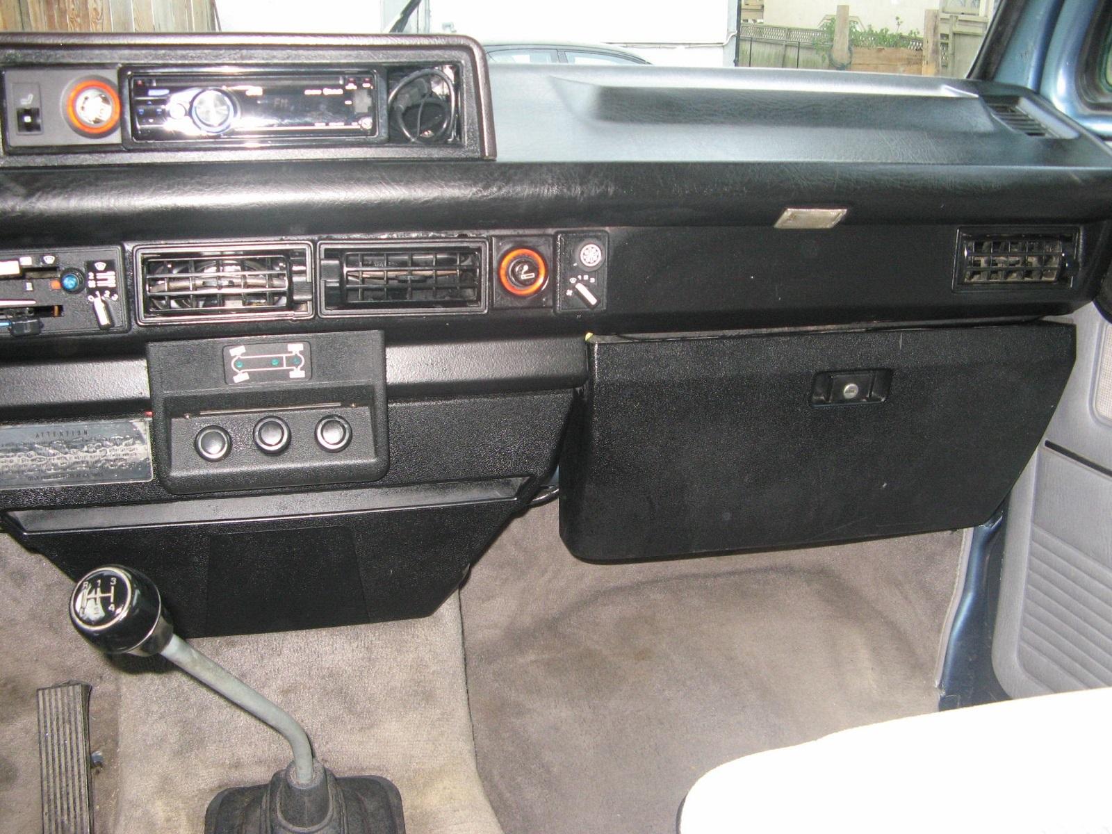

Here's my DIY front AC system. Since you already have the compressor and condenser, it should be easier for you than for me since my Westy did not have AC to begin with.
I have actually been curious as to how much interest there would be if I made a kit for this install. I would have to get a plastics shop to make an injection mold or make a fibreglass mold to replicate the tight fit needed for the evaporator box.
I would do two different kits, perhaps three. The "A" kit would be for installing front AC in a vanagon with factory AC. The "B" kit would also be for a factory AC Vanagon, but allow the user to retain the rear AC and add the front AC unit. The "C" kit would be for front AC on a non-AC van.
The idea would be to provide a complete kit for any such install together with proper instructions. Anyone wanting to replicate my design in my thread (see here: http://www.thesamba.com/vw/forum/viewtopic.php?t=535444&highlight=diy+front+air+conditioning ) is welcome to do so, (if you are as frugal as me), but I think there might be some interest in a plug-and-play solution for the Vanagon. This would not be a charity for me, but I would price competitively.
Anyone installing a front AC system has to take into account the tremendous importance of re-sealing the factory heater/air distribution box to prevent ambient air ingress and installing a proper heater control valve to keep all hot coolant out of the front heater core.
This unit has unbelievable cooling power as I have installed it, but I used an aftermarket high-efficiency condenser and also used RedTek as a refrigerant.

My system (and any kit I would make), is configured as follows:
1. The factory heater and heater box is retained.
2. The outlets from the heater box to the far right and far left vents are not used and instead, those vents are used for AC air.
3. The AC flows out of 4 vents being the two existing ones plus two added at the centre;
4. I could replicate the Audi part that my radio sits in. I got it at an Audi "pick-n-pull". I have never seen another one before nor since. This requires a fairly large opening to be cut into the dash, but looks fairly "factory".
5. I now know how to make my install work with a completely stock Vanagon heater/air box. I modified mine for clearance, but later determined I did not need to.
6. I specifically decided not to go with electronic flap controls because I like the Vanagon factory system that allows you to blend floor heat flow, defrost flow, and heater temp. Electronic mode controls are usually on/off, not blending.
7. My AC system is not at all connected to the Vanagon heater box and runs as a stand-alone, but is a great de-humidifier to use on foggy/rainy days along with the running the factory windshield defroster at the same time.
8. I used switches in VW or Audi bezels to look "factory". I covered a hole in the dash face (from the old cig lighter location) with an escutcheon and 12V outlet from a '90's Audi.
If I made a kit, I would want to simplify and integrate a bunch of parts that I made by hand.
