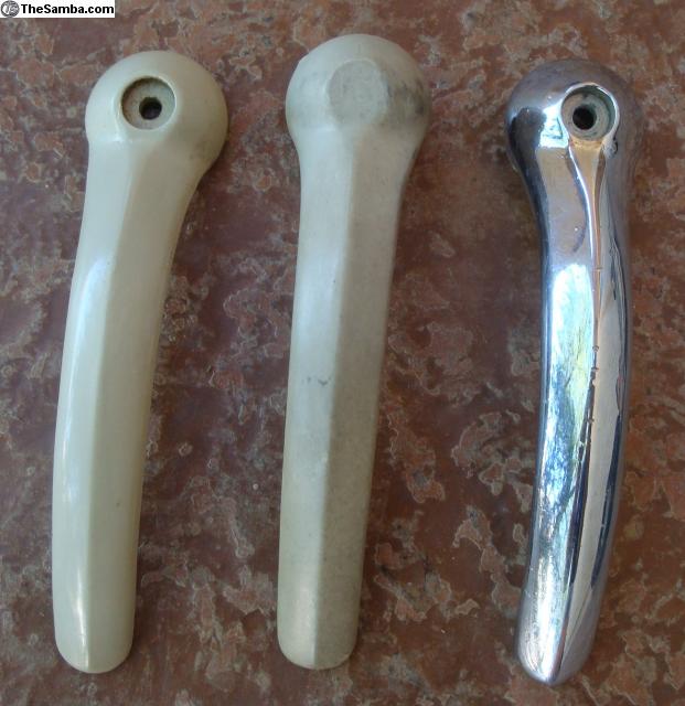

Inner Door Handles:
Early Buses, up to 16 Mar. 1960 VIN # 584674 used a chrome handle with a rib down the center as seen below.
Exception:
1959 Deluxes use the large chrome handles seen below as "60-65" Buses.
More photos:
http://www.thesamba.com/vw/forum/album_search.php?search_keywords=Ribbed+front+inner+door+handle
60-65 non-Deluxe Buses use a larger plastic door handle.
59-65 Deluxes were chrome.
Push-button front doors use an inner handle with a screw in the center.

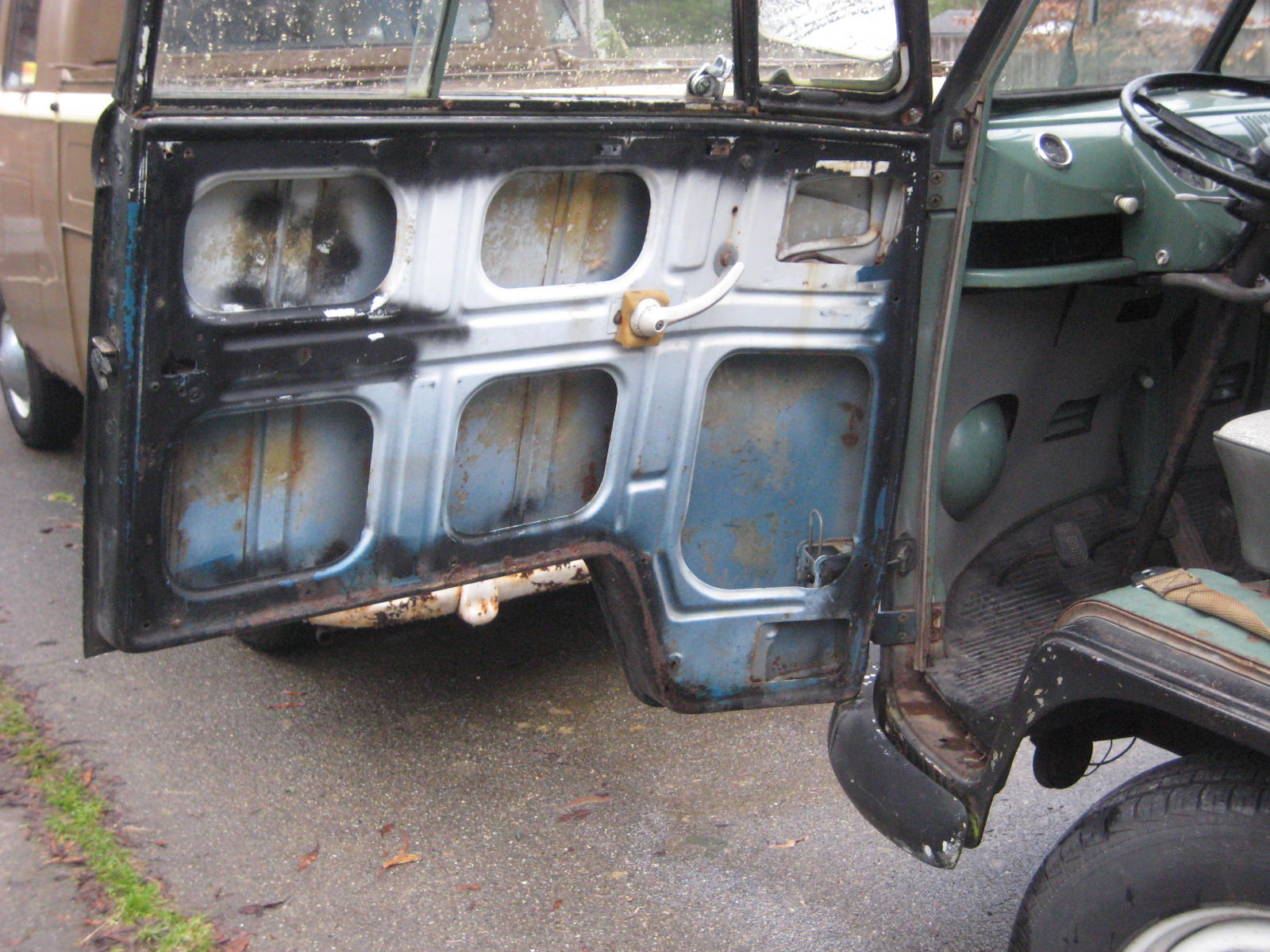

66-67 Buses use a small "flipper" front inner handle:
http://www.thesamba.com/vw/forum/album_page.php?pic_id=860772
http://www.thesamba.com/vw/forum/album_page.php?pic_id=860771
The small flipper inner door handle was introduced at VIN 216 046 096 on Oct 19, 1965. Early 66s have the larger inner door handle
When the flipper was introduced, the doors got the door pull at the top.
The door pull takes up two of the spot that were used by the door clips, so an early 66 takes 21 door clips, and late 66 takes 19.
The door pull is attached with two screws that go into little metal bracket (speed clip?) that clips onto the door, as on this door
(This is a later 66 door on a Sept 65 built bus)
this door has the pressings for the clips, but is early 66 and never had the clips installed
If you are installing door pulls, put the metal speed clips in before you install the door panels.
IIRC, the earliest push button doors do not have the square pressings, though I am not sure when the pressings were introduced. They were introduced before the door handle change.

Everett--
Could somebody show a photo/diagram of how the 66-67 door handle
interior reinforcement piece goes into the cab doors? When my Westy
was restored, the body shop neglected to reinstall them. I've never seen
a photo/diagram of how they go back in..

FWIW, the small flipper inner door handle was introduced at VIN 216 046 096 on Oct 19, 1965.
(this is a later 66 door on a Sept 65 buildt bus)
Inner Door Handles:
Early Buses, up to 16 Mar. 1960 VIN # 584674 used a chrome handle with a rib down the center:
60-65 Buses use a larger plastic door handle.
