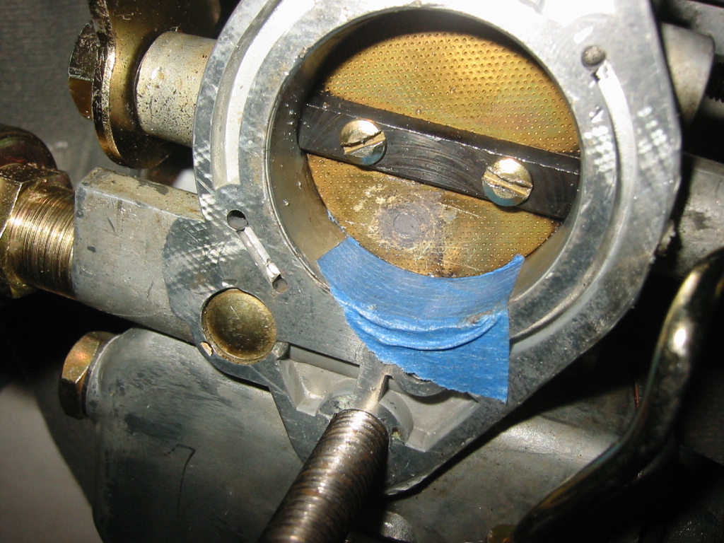

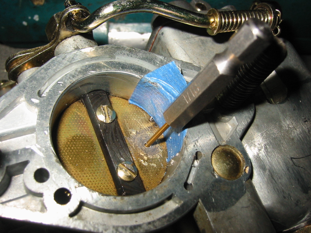

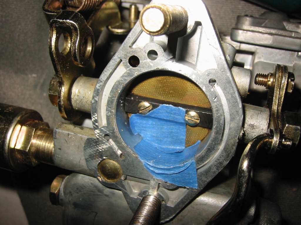

I can also verify this works. Riveted the throttle plate hole with 3/16 aluminum rivet and the car ran better. Then replaced the 127.5 main jet with a 130 ($5.00)- now car runs way better and has noticeably more power.
It's a pretty easy mod to do. The main jet is about an inch and a half inside the carb BEHIND THE BOWL DRAIN PLUG. I used a golf tee as an installation tool with the carb still on the car, but you could do both mods at once with the carb off.
