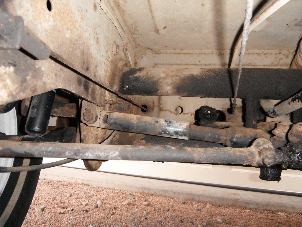

OK I know this is from an old post but it shows what I need to ask.( I have been in the search mode most of the afternoon) I have a 63 with the 1 ton front end has no damper at all just the bracket on the link the tie rod ends attach to. It has the same damper mount as in the picture . I have read in a few other posts that this model/ year has a frame mounted bracket for the other end of the damper, can anyone confirm this. Thanks, and if anyone has a picture that would be cool.
Posts: 71858
PostPosted: Fri Nov 09, 2012 4:03 pm    Post subject: Reply with quote
My 7/63 Bus with 1-ton option
My Bus has no clamp-on bracket, it bolts through the pivot point for the tie rods. It does have a front-beam bracket for the other side.
Since I was outside, here's my 8/60 Bus too, it has the clamp-on bracket. The othe side is on the frame instead of the front beam:

I looked up this change in Progressive Refinements and here's the listing:
3 Nov. 61
Chassis # 851 390
Steering Damper
Now: Lighter action. Directly
connected to swing lever and
a bracket on the low axle tube.
Formerly: Connected with clip
on swing lever and bracket on
the front frame-side member
Big Bill

Thanks EV, shows just what I needed to know. You are the Man!!!!!!!!!!!! My panel is 1100171 with this earlier type setup, but has a refurbished front-end. I bought it this way, so Iam not sure if it is the OG front end. I will check tommorow to see if the frame has holes or if a bracket was welded on the frame. The axle tube shows no signs of a bracket welded on it. I belive it to be a 1-ton as it has 20mm link pins and 27mm spindle nuts, if I did my research correctly it is a 1 ton.
