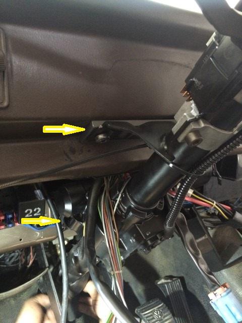

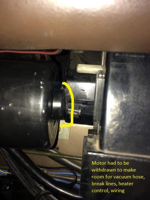

I started into my project this morning and have been at it all day.
First, to answer libby, I don't know for sure about the turing radius of a stock PS van VS a manual steering van. I did hear that it's less on a PS van but have never owned one. I was doing some research several years ago about adding the VW PS and read that it did change it which made me not want to go that route. Apparently there is no difference as you stated.
My install is going nicely but I can't seem to get the gearbox and control module tucked in as far as I'd like. It seems to be hitting the brake booster a bit but I may be able to do some clearancing of the lip at the bottom of the dash and get some more room. This has caused the angle of the steering column to be slightly steeper. I sort of like the new angle as I have a Jetta wheel and while it feels more comfortable than the huge stock wheel, I couldn't see the turn signal blinker lights or much of the speedo either. The new angle provides a nice view of everything and feels more like a truck - I like it.
I'm going to work on it some more tomorrow and see about getting the column angle back to stock as I'd rather not have to hack on the upper plastic cover. However, I may leave the current angle and carefully trim the cover if I feel brave. The lower cover will take some serious chopping for obvious reasons and I may have to cut the heater cover a tad to clear the end of the drive motor.

I received the e-bay "automatic" controller yesterday afternoon. The seller/manufacturer is in Portugal and it took ten days to arrive - not too bad.
Included in the small package are two pages of simple wiring instructions with color photos. The instructions also state that the ECU can be mounted remotely and the seller will provide details on request.
I have requested those instructions because the ECU is hitting the brake booster and is also keeping me from rotating the drive motor to a perfect horizontal position which bugs me a bit.

Many of the units sold on e-bay are the motor and gearbox only. I chose one with the column and two u-joints so I could make a flexible connection without too much hassle. The unit also came with the upper column which included the female spline shaft which I welded to the stock VW shaft (shortened 11-1/4")
My first mistake was to make the u-joint assembly connect to the rubber flex affair near the floor - the one that connects to the VW steering box.
This put the u-joint too close to the tight radius tubing bend coming out of the clutch master cylinder.
I have since removed that rubber flex joint entirely and extended the splined u-joint assembly for a direct connection to the steering gear - much better!
Hopefully, the stock rubber boot will cover the lower u-joint without too much hassle. I may have to fab up an extended boot connection plate but oddly, I really like doing this stuff.
One of my biggest concerns is getting the plastic covers to fit well. The lower cover will need to be shortened and sadly, the process will remove the metal tube clip stand-off. I'll need to provide another stand-off up higher inside the casing. I'll make a new one out of aluminum and use a single screw through the clip.
I won't be providing many dimensions or details on what to cut or where but hopefully the photos will be of use to the adventurous. I was hoping to not modify the Saturn unit's splined shafts in case it ever needed replacing but I did end up shortening the input shaft by 1-3/8" to allow room for the cut VW steering shaft (wheel end) and steering lock slots.

Waiting for the sun to come up and hopefully the drizzling rain to stop - figured I'd add a bit more info while I wait.
Here is a shot of the unit I purchased on e-bay for 200 bucks
Another showing the connection between the VW steering column tube (shortened by 4-5/8") and the shortened 3 bolt flange tube that came with the unit. This I cut at the end of the outer column tube of the Saturn unit.
One fits inside the other 1/4" thanks to the lathe and I am using a band clamp to hold it in position for now.
The plan is to weld it once I have the rotation of the gear-motor where I want it.
And here is the female spline end which was cut from the Saturn column shaft just below the bulged area of it's locking slot, turned for a press fit into the end of the shortened VW shaft, bored to receive it, and welded.
I believe this weldment needs to be axially true as there are two bearings involved - one at the worm gear of the Saturn unit, and the other at the top of the VW collum.
In my opinion, the EPAS system is a reasonable alternative over fitting the stock VW hydraulics as it costs less, requires no hoses, pump, belts, pump brackets, re-alignment, steering rack, and other bits. Plus it only requires power when needed (bound to save some energy/HP). That said, it's another odd bit in the character of this "grossly defiled" vanagon Wink
I like this vehicle's versatility, it size, its turning radius, its overall character. Power steering will bring it close to ideal. Power windows, a 5 speed (waiting for rebuild time), power door locks and mirrors, and a bit more sound deadening will be the ultimate - oh and a truck fridge and interior re-do as well. The last time I was bored I was 6.
82 Vanagon Westy - AAZ 1.9 TD, HE200 Holset, WAIC, 27.75 dia tires, Electric power steering, 5-speed AAP w/.078 5th
Oversize spare carrier - stock location (no longer for sale).

Project is going slow but very promising. I removed the ECU and am in the process of carefully soldering about 18" of wire to the four that connect to the torque sensor so I can remote mount it.
Without the ECU box the motor tucks in nicely and is now parallel with the dash. I can even get the top plastic cover on - woo-hoo!
The angle of the column is now close to stock but tilted just enough to allow a clear view of the dash between the spokes of the Jetta wheel.
Also, the rubber boot at the floor fit over the u-joint assembly just right. All I had to do was punch a slightly larger hole in the rubber.
Pics to follow
