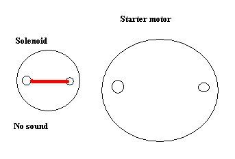

6.) Gapped the solenoid terminals as per Muir, no sound
Is this the same thing? I got a spark, but didn't notice any sound. Is it loud? the starter and motor are two separate "tubes" right?
This is what I did.....

You should get more than a spark, either a solid CLICK or motor noises.
Jumping between the big terminal with the cable from the battery on it and the spade should give you a click and turn the engine, jumping between the two big terminals should give you at least a whirring noise.
Make sure it's out of gear.
I'm unfamiliar with the spade. Which part is this?

The spade is the small flat male post sticking out of the front end of the solenoid that the female spade terminal on the small wire fits on to. This is where the start signal arrives at the starter/solenoid. When you make this spade hot by jumping from the big B+ wire on the starter your solenoid should engage and your starter should turn over.

So I thought I may have gapped the solenoid towers wrong, so I tried it again… just pretty sparks again, no click or sounds.
