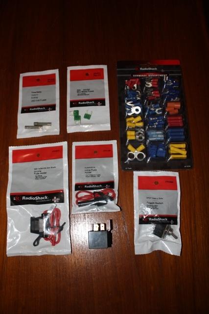

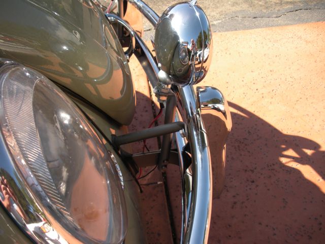

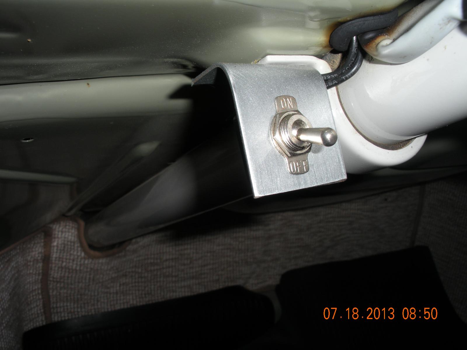

I did this a few years ago. Yes, use a relay for all the reasons mentioned. Mine is in a 12v car...I believe I used 12g wire. I didn't want those heavy chrome mounting brackets so I made my own using stock VW bumper supports. I wanted a dedicated switch so I bent a piece of flat bar put a hole to mount it with same screw used by steering collar and put simple switch in it. I'm sure I put a inline fuse in. Took some time, but worth it.

this last diagram is the one I used...make sure all circuits are fuse protected as in diagram... I use automotive wire from O'Reilly's the covering on the wire seems tougher than the cheap radio shack stuff...I got the relay and switch at radio shack. Make sure wire size is adequate for amps and distance http://www.amplepower.com/primer/gauge/ use soldered connections or good quality crimped connectors don't do the twist & tape crap. Neatly done secure wiring is best. Run wires to minimize chances it will later get accidentally cut or severed.
Kim

Well, based on Volkswagnut's easy to read diagrams I think I've been able to acquire what I need to get the light to light up Smile Here's the list of what I've picked up and the specs. I hope Volkswagnut is out there and can take a peek at my specs to make sure I didn't get anything that will explode Wink
1. Relay - Sumeng, JD1912, 12V, 40A (It said it would work with both 6v and 12v)
2. Inline Fuse Holder - 12/24VDC Mini Blade, 30A
3. Mini Blade Fuses - 32VDC, 30A
4. Inline Fuse Holder - 250VAC, 10A, holds 1 1/4" x 1/4" fuses
5. 1 1/4" x 1/4" fuses - 250V, 5A
6. Switch - DPDT Heavy Duty, 3A @ 125VAC, 1.5A @ 250VAC
