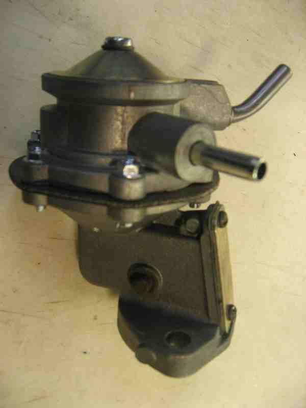

Airtex makes a copy of the VW-Pierburg fuel pump. The 1070 is the correct one for pipe attachment but I prefer the 1071 as it's easier to remove in place.
Several companies sell them; this is one.
Here's what it looks like.

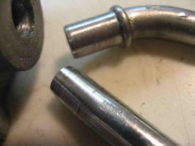

The pumps come with bad pipe attachments and flashing chips inside so it's best to disassemble them. The bottom end has to come apart to get to the diaphragm and spring. The fulcrum pin just knocks out with a light tap and a 16 penny nail.

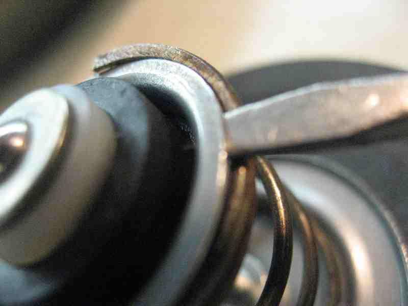

This is the culprit sring that is too strong. Take it off by starting the winding over the lip and spin it off.
Here's the diaphragm and spring separated. Now you need a correct spring.
Find a good used original German Pierburg.
Here's the spring you're after. Take it off like the other one.
You can see the bad longer spring in this pic. OG spring is shorter and less strong but correct.
Put on the German spring doing the opposite of removal and pry it on at the last turn. Easy to do.

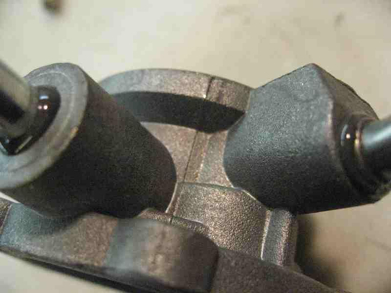

Now it's time to make the pipes safe as they come not safe. Pull them out with careful twist of pliers near the body and sand the ends with fine sand paper.
Sand the holes with a rolled up little piece of sandpaper.
Mix epoxy and toothpick it onto and into the sanded areas. Make sure the outlet pipe is aiming up. When it's almost cured poke a pipe-cleaner in there to clear possible ooze.
Here's the pipes all safe and cured.

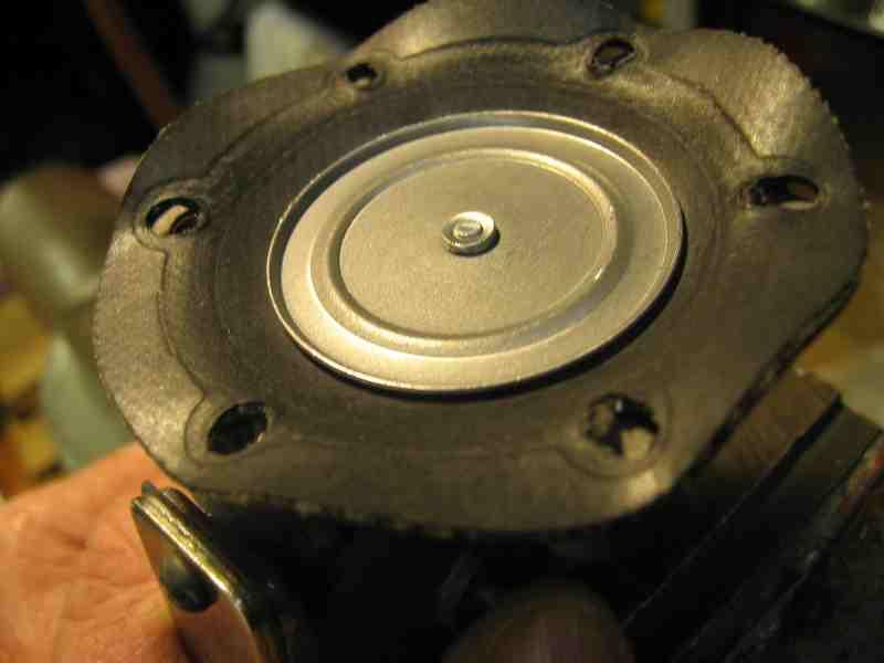

Almost done but the diaphragm need to be preloaded to keep it from stretching at the holes and tearing. I use a block of wood set in a vise that will push up the lever 12 to 13mm. The book says 14mm but I've found these thick diaphragms don't like it.
Here it shows how much the diaphram gets pulled down prior to tightening the top chamber on.
Clamp the pump to the vise over the wood block if you don't have someone to hold it for you while you tighten the screws.

There's your safer, correct pressure, new pump ready to install. I like to bench test them but that's up to you.
