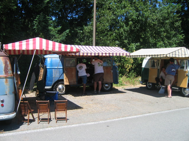

Roof brackets may be for the awning/ tent, like this:
There is a pole that goes onto a front bumper bracket, and another into a hole in the rear bumper.
