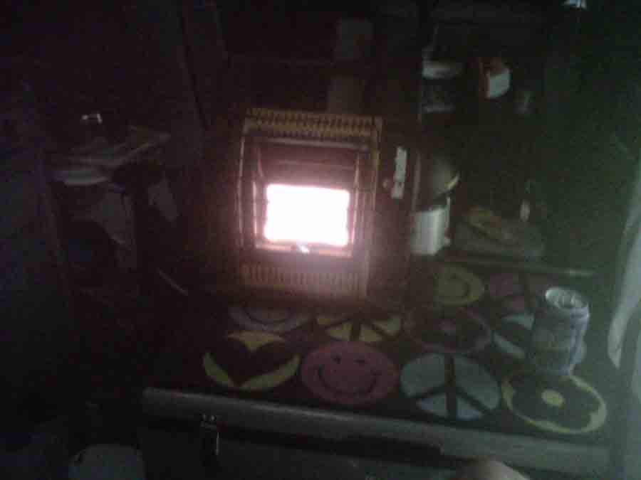

My Heater Buddy has come in handy as of late, works as its suppose too!
The last few camping
trips it has made an appearance and kept my Westy Toasty-warm. I can't speak of anyting at
altitude, as I am at sea level but the heater works for me.
Here it is in action, sitting on my fridge.
