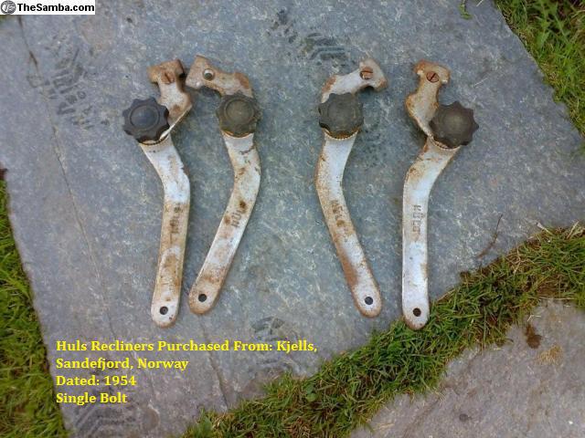

Huls Recliners Single Bolt Dated 1954: Cutting the frames to make it all fit and look nice…This is my question. Ive searched and looked at photos, and seen instructions.. The instructions I see are for different variants of Huls Seat Recliners..i.e Type 3 etc..but nothing on the cutting of the frames to make the recliners fit for this style of recliner. I have not seen a thread on this process as well, just threads on styles and opinions.

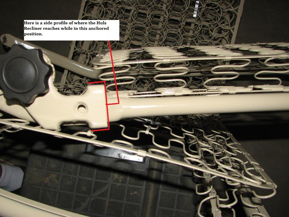

B: If I mount the Huls Recliner to the original seat frame anchor hole, and position the recliner to the position of the seat frame. I get a slight obstruction at the cross tube and single bolt mounting hole, creating interference. I see that in a few photos in the gallery that the recliner seems to have been dropped down some. But is this just a guess or was this a factory modification?

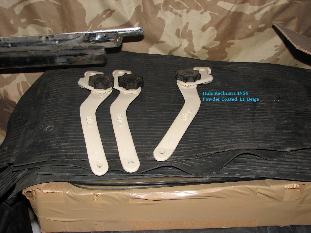

Well after researching for a while and asking everyone I could about the installation process of the Huls Recliners.. Heres my step by step for cutting and installing.. I havent seen any documentation or instructions, everyone I asked was pretty much, measure ten times then cut and grind to fit.. Here you go.. 1954 Dated Huls..

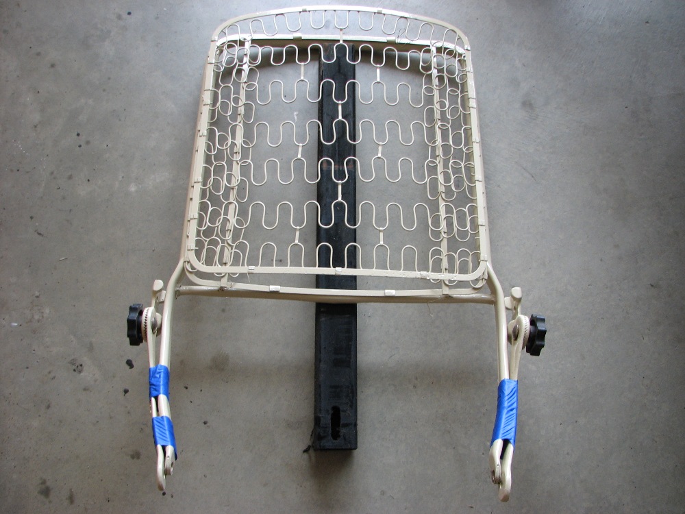

Step 1: Your Early Upper Back Rest, hold back the tears... for once its all over.. you'll be okay..

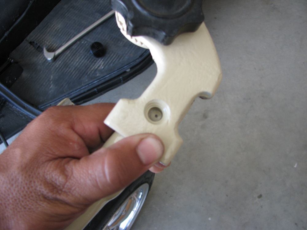

Step 2: I taped the recliners to the arms that there were replacing on the upper back rest. I wouldnt recommend measuring from the existing holes where the arms mount to the nipples at the seat bottom.. What I did was drop the mounting hole just below as you can see in the photos. Doing this gives you the hole to drill through on top.. If you used the existing holes to measure, you would be trying to bolt your recliners through the cross tube, which wont work. So dropping it just a tad bit, gives you that extra to bolt through..

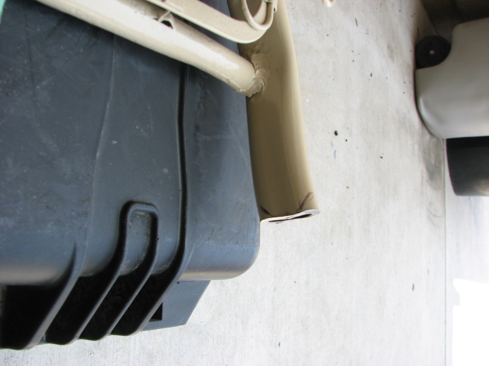

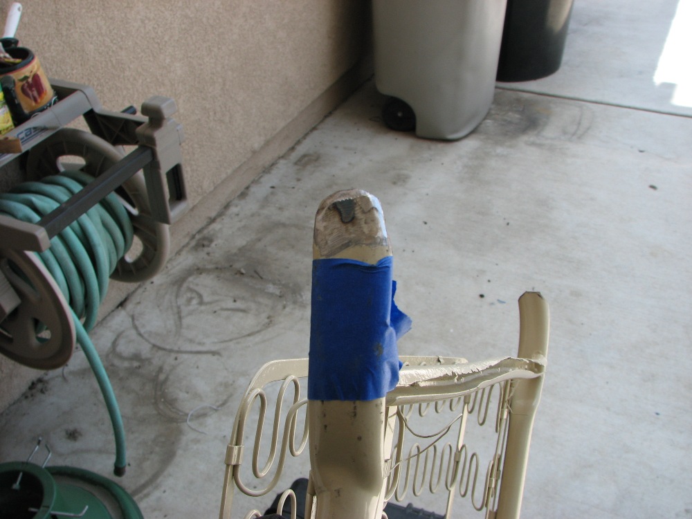

Step 3: Once you have got your measurement, tape it up and verify one or two more times before you make that cut.. When you do cut, try to cut below the tape, this way you can grind down to the tape.. If you cut it short you cant add on.. Scary I know.. Heres my first cuts..
Step 4: After the straight cut, your going to need to cut angles on both sides. This will cut down time for grinding, as the bottom of the huls pocket has a tapered inset. This is where your going to need your recliners at your side, and grind to fit..
Step 5: After the arms from the upper back rest fit into the huls pockets, put some sealer or some type of coating.. Or if you do this before you powder coat no need to worry... Your going to want to center punch the hole for the bolt that goes through the arm and the recliner. Mount your recliners onto your arms and center punch.. Now Im ready to drill my first hole using a small bit, working my way to the correct size..
Step 6: Time to mount them.. Set them in the arms, line up the bolt holes and insert hardware and tighten.. German Torque of course.. No need to get all buff...
Finally, install them on your ride.. Heres mine..
