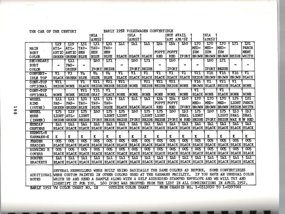

PostPosted: Fri Jun 22, 2012 10:40 pm    Post subject: Reply with quote
Source: Garwoods Car of the Century
Bill

Bengt, I have seen cars with lighter green color wheels like yours, but my wheels really looked L11pastel green, if not even a bit darker... i'm confused.
Also do you know for the benzin tanks and the covers in the front ?
oldsplitvw, i don't know what credit can we give to those "auto show" pictures, as you may know, the car displayed were prepared for those show. Sometime different color combinaison or more shiny paint...
ZwitterND : would you have the same for sedan cars ? no kabriolet. thanks/

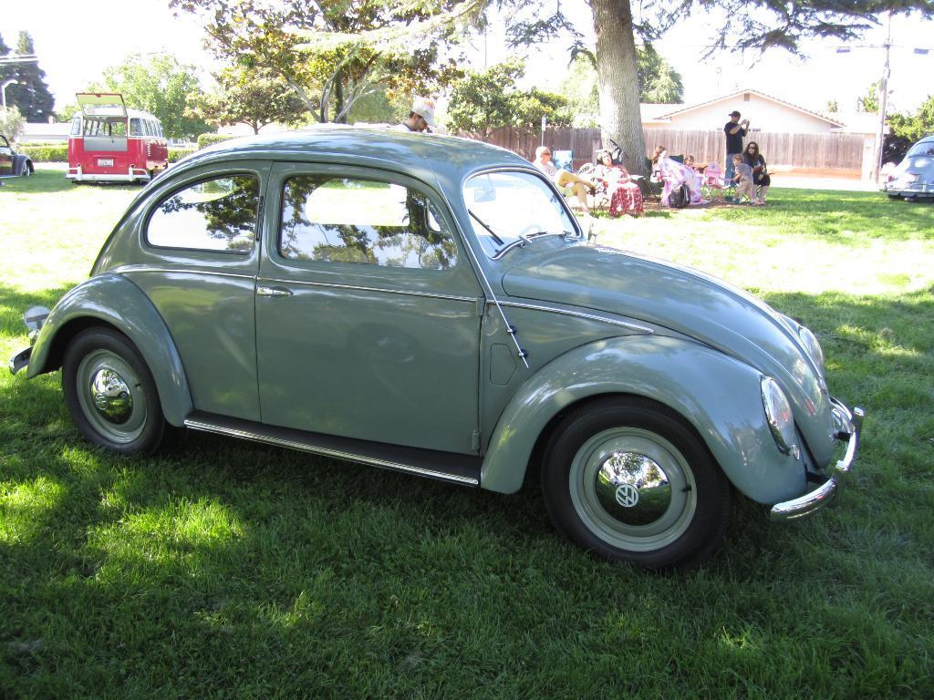

Below is a picture of my Oct' 50 11G. It has L11 painted wheels, (just like the car) and I believe that's how they were painted on the 1950 sedans and went to 2-tone wheels in '51.
Regards,
Jim

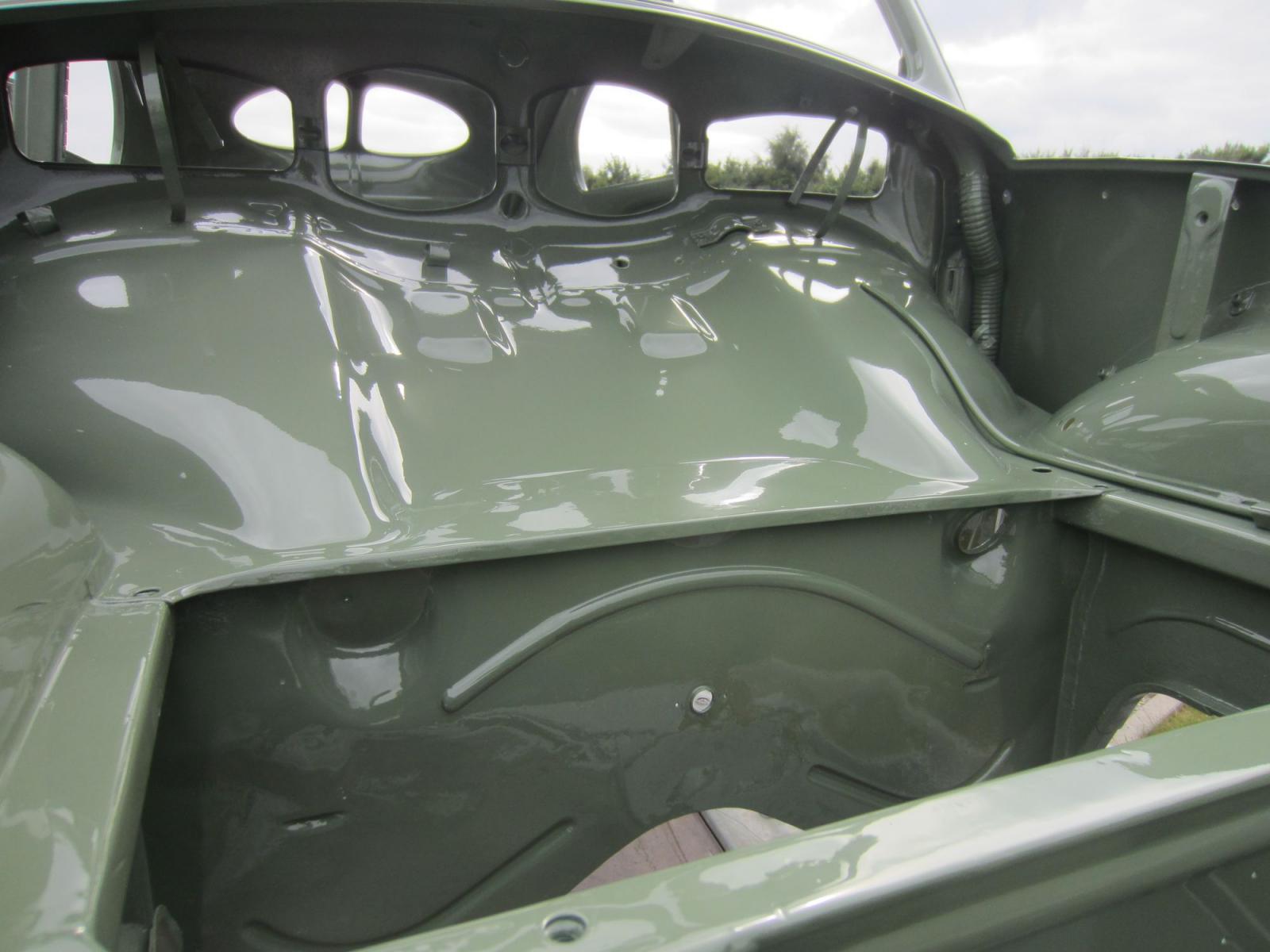

PostPosted: Sun Sep 30, 2012 1:31 am    Post subject: Arlette is painted ;) Reply with quote
Here are some fresh pictures of Arlette jsut been painted L11 pastel green. After years of resto and collecting parts i wanted to share to thanks you for your helps and advice.
For the wheels as my car is october... almost 51... i have decided to go on with 2 tone wheels.
The benzin tank and the cup will be painted L11.
I'm still wondering what color i will use for the VW sign on the babymoons and the bumper rib... L11 also or Black ?
ok... here are some pic Wink
