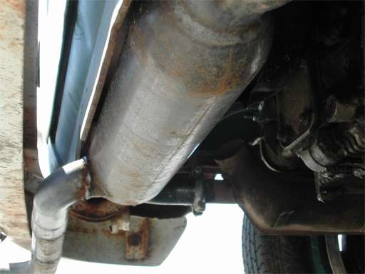

I have been working on a new muffler/header for a split or up to 71 bus with a 1600 or larger engine.
We will be testing it on a dyno on some bigger then stock engines to see how it works. It did make a noticeable difference on the stock 1600 SP in the test/fit bus and will be testing on a 1776 and 1800 this weekend.
A few more tweeks and they will be ready for sale.

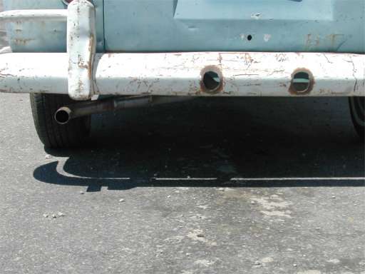

tailpipe comes out in stock position
pic of exhuast

By the looks of this muffler, I am assuming it's less restrictive than stock. If so, how "big" could you go with this muffler?
It's quieter than a header with a single quiet pak
The whole purpose is to make something for bigger then stock engines and retain a somewhat stock appearance.
We will be testing them on a
1776 with heater boxes
1800 stroker with heater boxes
and for shits and giggles a 2087 (welded flanges and J tubes)

will that work with a non bent rear apron?
The apron is not bent (only one little spot on the right in the pic), it only appears to be because of the angle I took the pic.
One of the mods is the muffler is being moved closer to the engine and also up a little more to hide it a little better and to get some more clearance between the apron and the muffler.
This is the fist one that was test fit and the mods are now being made for the production versions

In the "raw" version, are you using stainless or plain steel? Confused
There are no plans for stainless. They will be available raw (not painted) or ceramic coated
