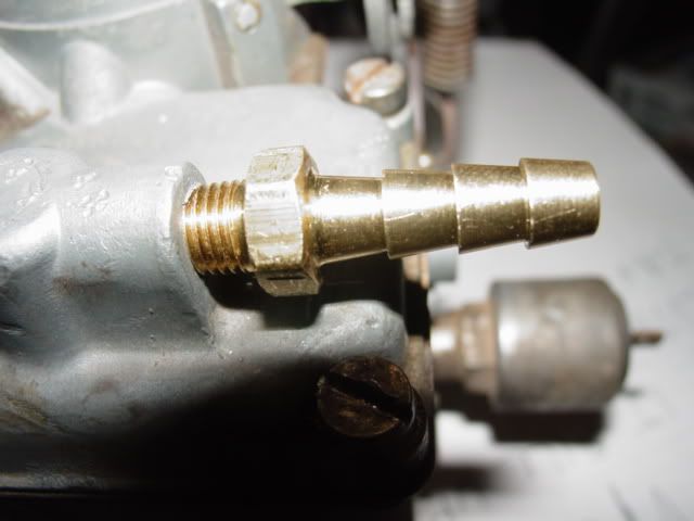

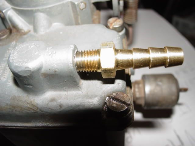

I read about this on the forum a while back, finally got around to trying it.
Acquired a 1/4" hose X 1/16" NPT barbed fitting for a whopping $4.06
Acquired a 1/16"-27 NPT National Pipe Taper High Speed Steel Pipe Tap for $5.90 through Amazon.com
tried it out on my spare 34-PICT3
Everything you need to do the job:
thread just started:
fully seated by hand only. four threads in when cranked down
take the top off and clean the aluminum bits out of the bowl, you can't keep that crud out by holding the carb inlet down. and use a larger tap handle; you have to beef it a bit.

I think where is going on this is 1/16 inch NPT pipe thread is about .100th or 3mm smaller in diameter than 1/8 inch NPT thread thread... Real issue may be finding 1/16 NPT tap...

as Dale aid, it's about diameter. the 1/16 NPT tap works without drilling the original Solex hole.
