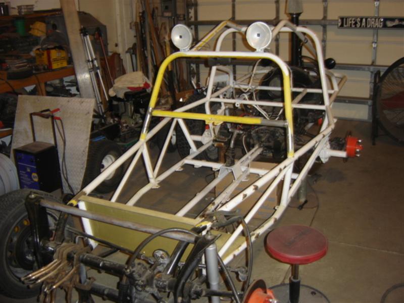

First pics

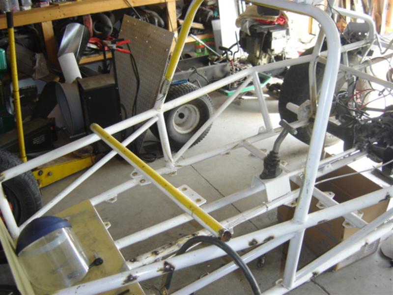

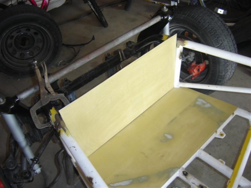

A little pic catch up, Rip out done.
Toe box mockup

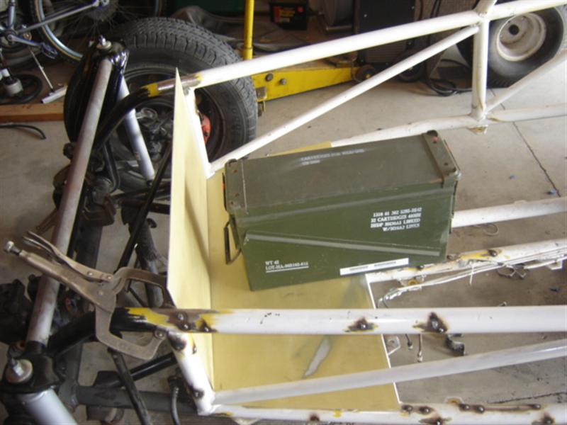

A little dry storage?

ammo cans work great for storing stuff in! i always put the wallet and cell in it. small tools as well

Well, yesterday was a pretty productive day. I got the "knee bar" raised 3 inches. (much easier for an old fart to climb in and out, lol)
I got the toe box bent up and bolted together, just have to fab mounting tabs, an it's done. Welded in a stiffner for the shock towers, a good place to hang the headlights...

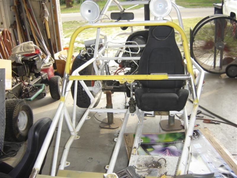

Had a pretty good day at the boneyard. I scored a pair of seats from a late 70's Alfa Romero. One mounted, one to go...

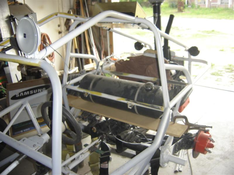

The gas tank mount is next under the knife.

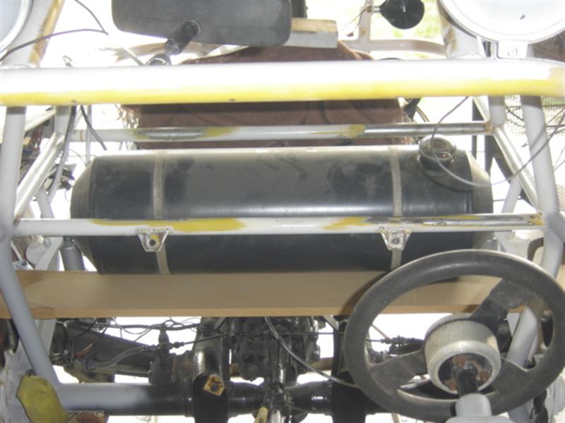

I want to lower the mounting position of the gas tank, relative to the CG, and make room for a small custom stowage box above it.
This is as low as I can go with the 10 gal, 10 in dia. tank. I'm planning a 2 bar, hanging type, setup. (new bars spanning the existing cross bars, fore and aft, with the tank hanging below them) A 4 inch rise, above the cross bars, leaves the tank bottom ~ 1 3/4 inches above the front trans mount strap and plenty of wrench and wiggle room for the starter.
Questions:
Opinion. Will two, 1 inch square tube (11 gage wall) mount bars, with the existing strap type clamps, be strong enough to support the 78+ pound tank (full) Or should I add a third bar and hanger clamp ?
How best to rig a rollover fuel stop vent ? (Tank has a vented cap now)
How best to control fuel slosh in the tank ?

your not going to control slosh unless you get a tank that is baffled or foam celled.
1 inch tubing should work but add gussets where you can and braces between the two bars lower than the tank. if you can add a brace down to the horns or torsion housing then that would be a plus.
just add to your wish list doing a custom tank/rack.

The tires that came on the rail are 28 inches tall (at 35 PSI) I guess I'll just have to try 'em and see.
There ain't many hills to climb here in SW Florida anyway, gotta go damn near to the Ocala Natl. Forest to find a hill over 6 feet high. (The highest point of land , here in town, is the post office steps. The local Barney's are a little touchy about the kids skateboarding on them, so I think I'll keep the rail on the street, lol)
I have a notion to extend the filler neck with a piece of tubing, weld in a bung for a rollover valve and a non vented cap. Anybody have a source for the valve?
