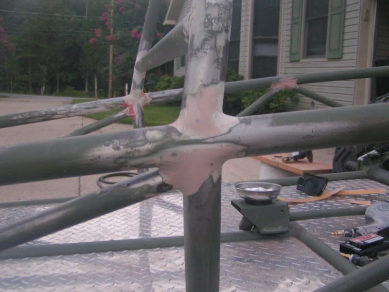

i stripped the yellow and then sprayed etching primer, then used body filler to smooth out all the welds for that super smooth look(not totally finished with that yet)

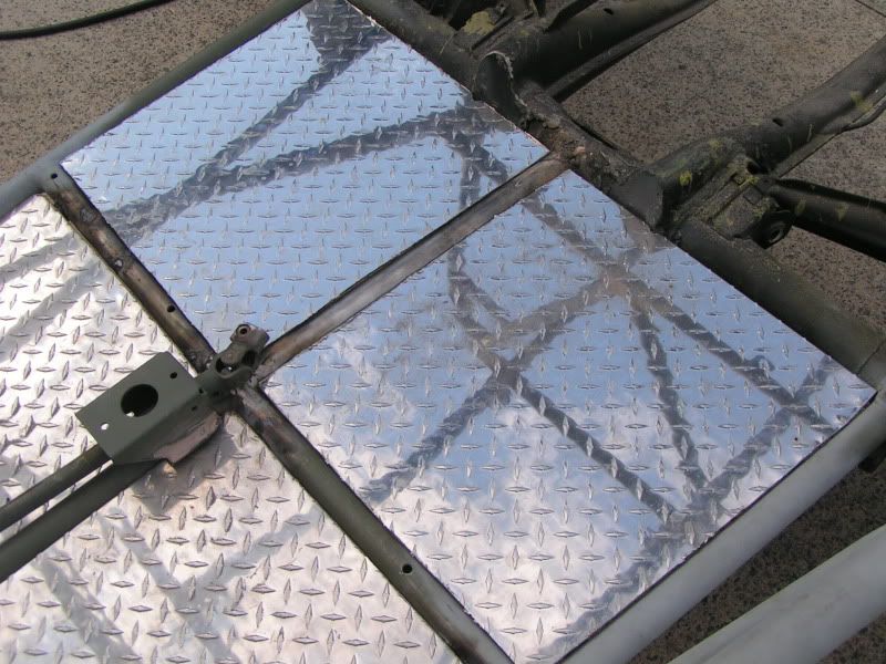

yesterday i finished installing the floor pans and installed the two seats.

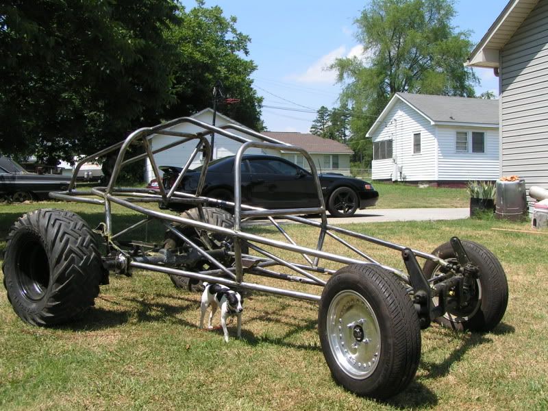

clean frame (and my dog & mustang Cool )

example of my smoothed out welds, this was after using a grinder, but the welds were gorilla welds strong but ugly. even after grinding i still didnt like the way the looked. im pretty picky

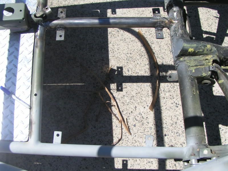

I welded the horizontal pipe in at the top of the picture. this is for the seatbelt to mount to. i had to fab up some new floor pans because of that.

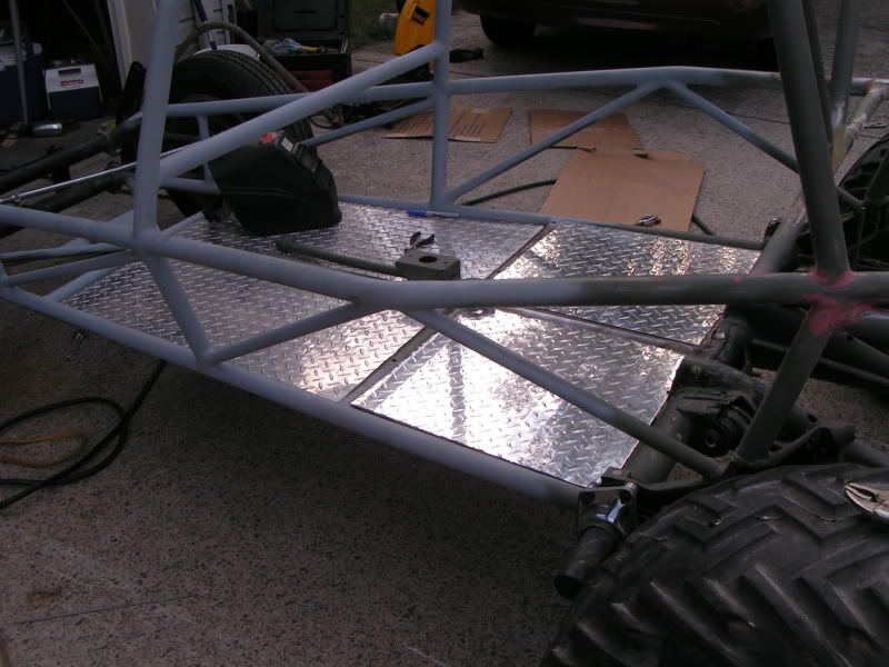

After making cardboard templets, the panels are in but need to be trimed up. Its easer to take off than to put back on Wink

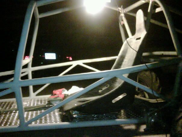

This is what was accomplished last night. i Mounted the driver seat with an adjustable sliding mount, well it didnt work like i hoped it would and turns out that i didnt really need it in the first place because if your much taller than me your screwed anyway. so i ended up just mounting it to the floor pan.
today i mounted the passenger seat and mounted all of the floor panels. i also soda blasted the front beam since it wont fit into my blasting cabinet, and checked to see if the PO rebuilt the brakes like he said.... and he did. that brings us back to my question of bed liner or black paint for the front beam?

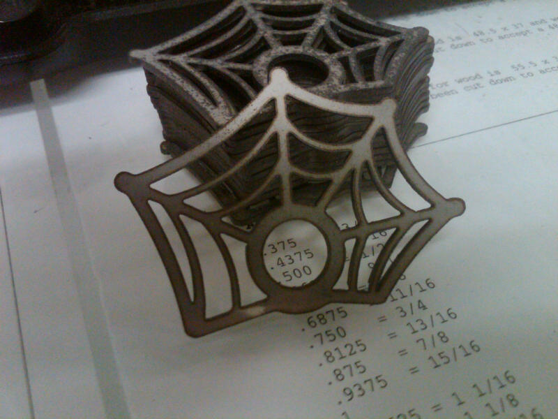

Sweet rail build. Now would you like some neat washers that look like your Avatar for the floor decking ?
these are my washers

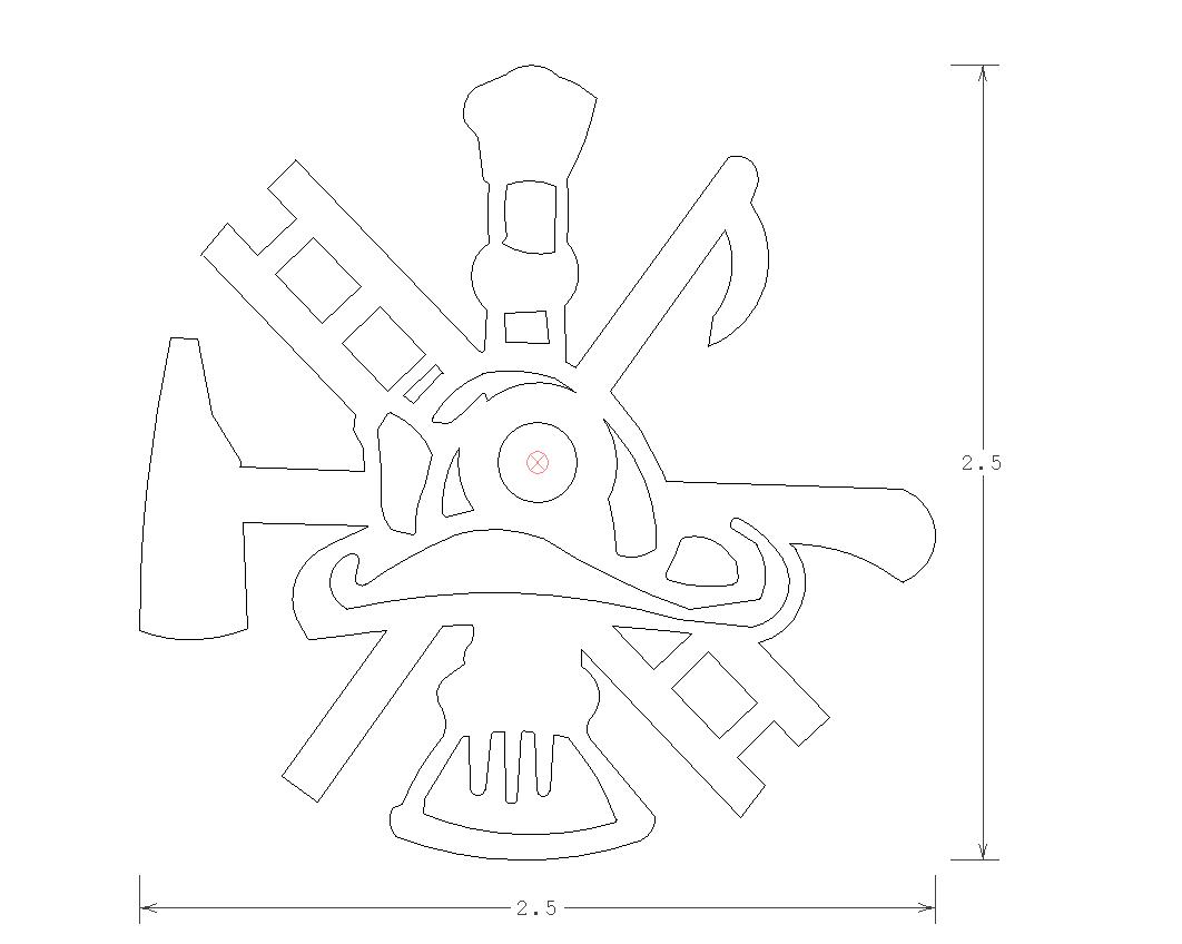

that would be awesome. so im guessing you have a water jet? i dont know if i would use them on my diamond plate but i could find somewhere to use them. would something like this be a little better though?
just the cross not all the detail inside. i dont know what would look better..
what would it cost me?

I work for a laser cut company. They would be cut out of .0625 stainless steel. This way you could polish them or paint them. That would be your choice.

ave to design the parts first . Give me till Monday to get the price to you.

Fire washers
tell me which one you like. I will get a pricing on them. I need to know how many you want too.
