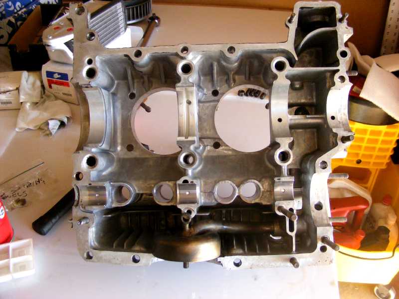

Here is where yours may be broken .....the bolt comes up from the bottom oil plate and breaks the aluminum boss that hold the oil pick up tube in there...the bolt that holds it can bee seen on the side of the engine, drivers side just above the pushrod tubes in sort of a little crater.....
The oil tube will soon fail to pick up oil and the engine will sieze.
You need a new case if that did indeed happen.

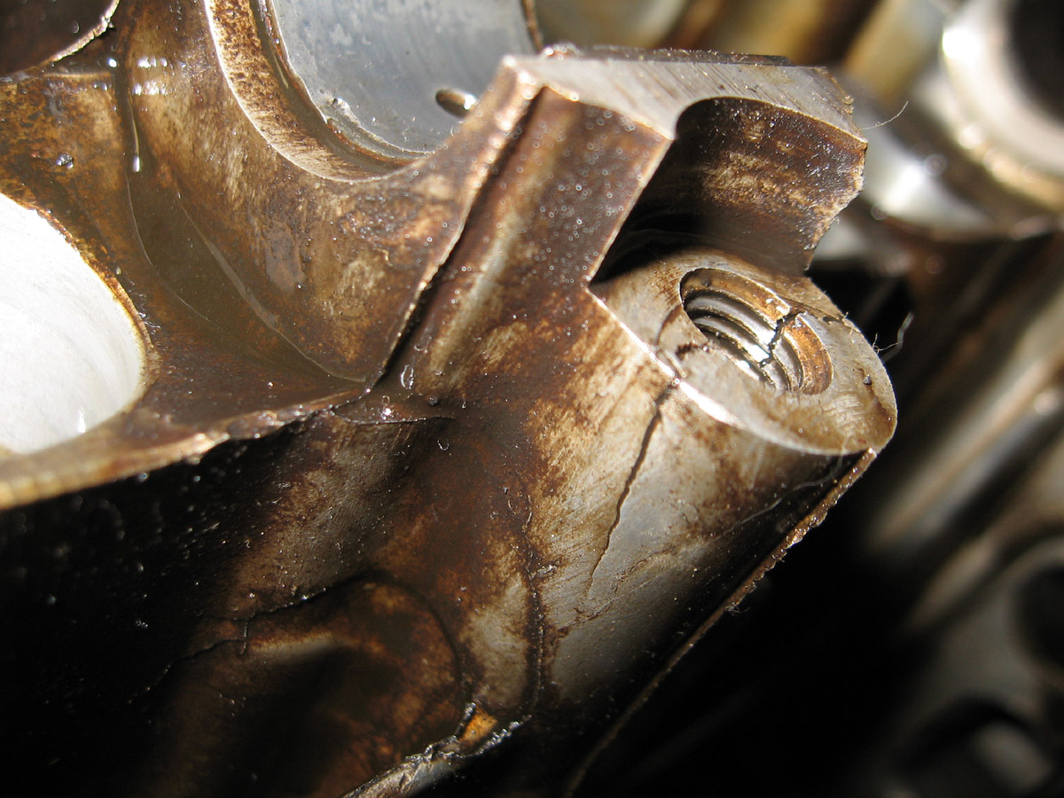

NOT SO FAST, rockdog2877. Before slitting your wrists, read this thread and take heart.
http://www.thesamba.com/vw/forum/viewtopic.php?p=2726729&highlight=#2726729
My engine had the same problem - unbeknownst to me for a few years. I don't know when exactly my bolt got cracked - I may have done it myself in the first 3 or 4 years that I owned the bus and before I became a Samba member and learned about the importance of the sump plate. Or, it may have already been like that when I got the bus. I ran the bus in this condition for at least 5 years, possibly more.
Before I removed the engine to fix an unrelated problem (exhaust studs - see the above linked thread), the engine ran fine, no oil pressure problems, no overheating problems, etc. Granted, I'm in Canada, not the Arizona desert, and I only used it summers for camping, not a daily driver.
I took much more flack for the condition of my camshaft. Laughing
