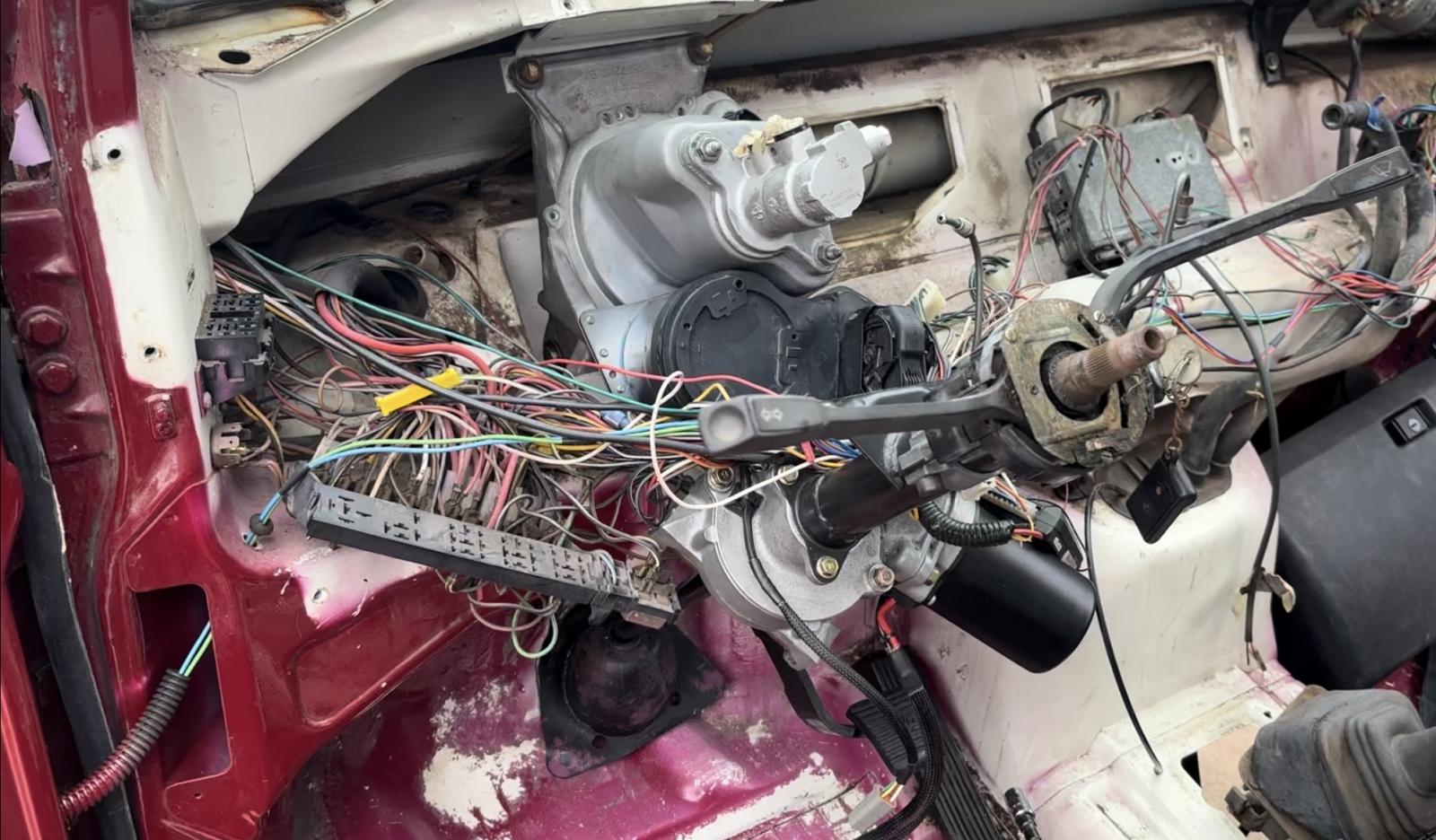

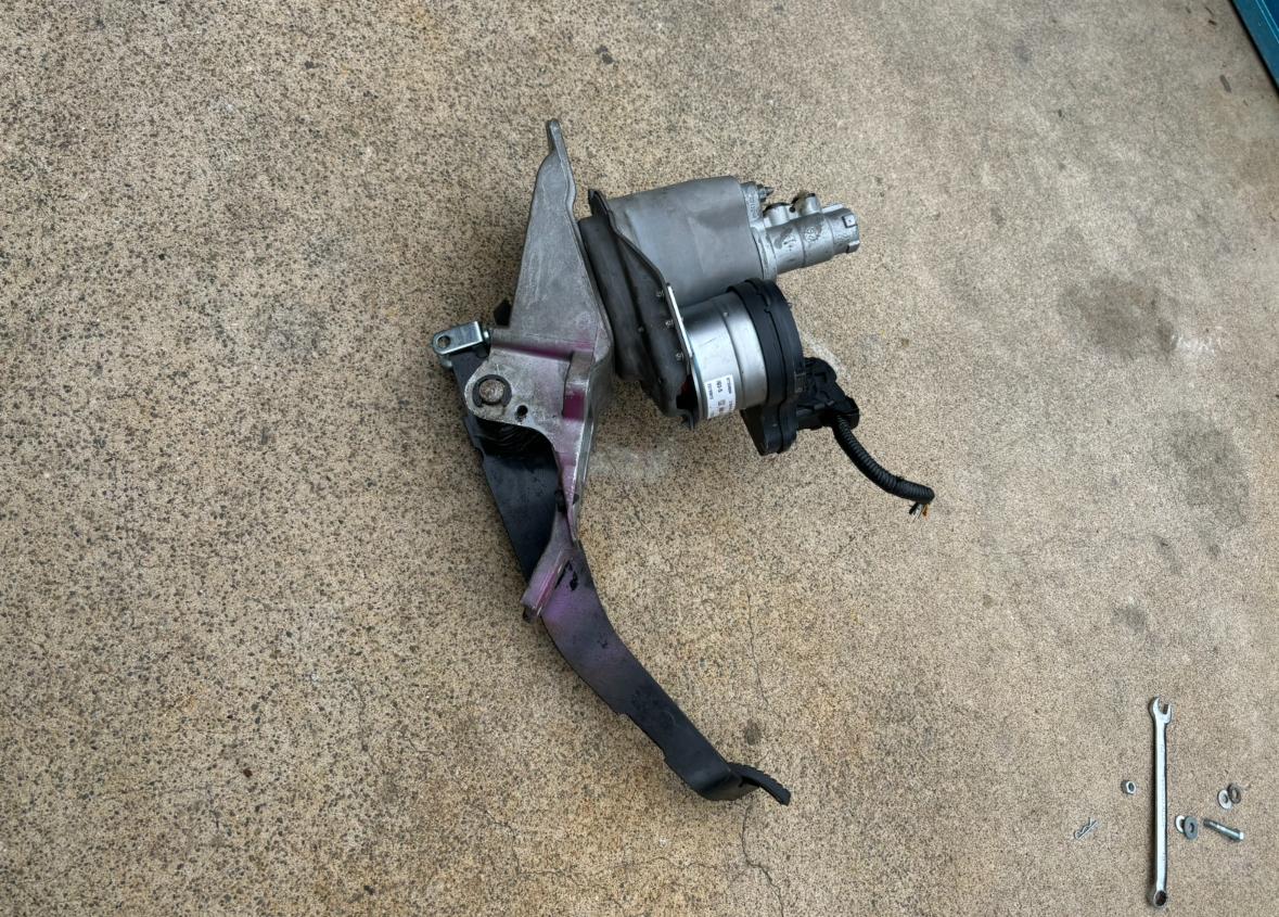

PostPosted: Mon Jun 10, 2024 10:56 am    Post subject: Re: Vanagon Electric Brake Booster Install Reply with quote
Here's a sneak peak! I am putting all my pics and advice into a comprehensive how-to.
Biggest take away: Most of the stock brake fluid reservoirs that come with any version of the iBooster won't fit our vans.
HOWEVER, there is a master cylinder from a different car that is a direct bolt-on to the iBooster which fits perfectly in the Vanagon and works with the stock brake lines.
More on that later after I 100% confirm the compatibility.
