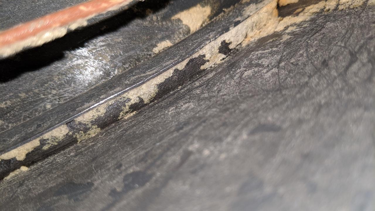

PostPosted: Wed Jun 24, 2020 6:45 am    Post subject: Re: What year did " Death foam" first get used? Reply with quote
Here is a picture of the seal.
Could you help me see what I’m looking at? I’m about to remove my foam, and if I can repair that seal while I’m at I’d love to

PostPosted: Wed Jun 24, 2020 9:24 am    Post subject: Re: What year did " Death foam" first get used? Reply with quote
creative native wrote:
When people make this foam/rust repair, is something else used to replace the foam with or is that cavity left empty?
If you leave the cabinet empty and still have a bad seal, then water will still enter the cabinet and collect further south down by the rocker panels. Probably not a great option. Address the source of the problem (the seal).

PostPosted: Wed Jun 24, 2020 9:28 am    Post subject: Re: What year did " Death foam" first get used? Reply with quote
To my knowledge, that seal cannot be repaired - it is embedded between the body and the vent window panel. Instead people are applying generous quantities of sealer both above the seal (access through crescent vent opening) and below the seal (access through the hole you need to cut from within). You can then test it by dumping water in there and see if enters the cabinet.
I'll add a picture with a better description of the seal. My paint is dark blue making the black seal hard to pick out.

PostPosted: Wed Jun 24, 2020 9:55 am    Post subject: Re: What year did " Death foam" first get used? Reply with quote
Here is another picture of the seal. This seal is in good shape, and I had no rust in my '71. I spent a day removing the foam on both sides to find out.
To take that pic, I needed to insert my cellphone into this hole and point up.
