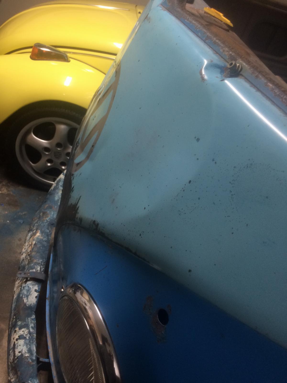

My intent with this bus is to keep it as original as possible and will be doing my best to do a preservation rather than a restoration. Hope to drive the wheels off this thing once it's all together. This bus is believed to be a Westfalia painted bus, and had one repaint sometime many years ago by a VW dealership in Saskatchewan, Canada so they could resell it on the used car lot.
Had a little extra time during the holidays so started playing with stripping that had already been started. I'm lucky, the wife loves it as much as I do!
I Went to Home Depot and bought a vast array of solvents, scotch bright, gloves and steel wool! Also read the whole og paint thread, but most of the name brand products we don't have here, so settled on the nearest thing. Long story short, but by far the best combo I found was acetone and 0000 steel wool. Softens the repaint but doesn't affect the orig paint. This took about 4hrs and about a gal of acetone, as it flashes off so quick!
After a little more clean up, and a quick hand application of cleaner wax I was amazed by the shine! I think wih lots of time, dent repair and touch up, the orig paint will be saveable. The westy paint is very fragile as compared to factory VW, and is very thin, especially the lighter blue.
More to come

Have a few days off during the holidays so have been working on the bus as much as I can. I'm not very good at taking pictures while I work, gonna have to make a point of that! Did some more stripping on the roof, and have mixed feelings about it, not much paint left. The westy applied paint is super thin! I'm being very gentle and using acetone and 0000 steel wool, this isn't removing any of the og blue under, there was just a lot of areas where it was either sanded or worn down to primer before it was resprayed. It's slow going and I'm working in the garage doors closed as the high today is freezing. From reading the og paint thread I figure lots of people go thru this, wondering what they've got themselves into....
