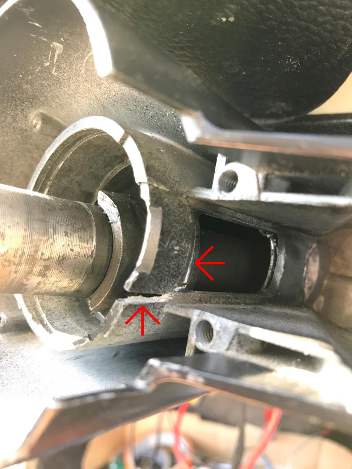

PostPosted: Thu Aug 17, 2017 2:10 pm    Post subject: Re: Steering column wiring Reply with quote
and yet more steering column grief -
after dismantling and repairing the ignition i moved to adress the excessive up & down slop in the steering column, only to discover that the aluminium/magnesium housing around the column is badly cracked. the lower third is almost split off so he bearing doesn't sit tight and the column + bearing moves up & down. somebody has previously used excessive force to dismantle it or maybe it's accident damaged? i'll need to fix it somehow in order to be able to replace the (missing) circlip. tried a hose clamp but they aren't quite strong enough. photos here, arrows indicating the cracks:
the main issue however is the column itself. the thick curved steel plate attached to the right side activates the steering lock, but the column won't go far enough down the housing to enable the bearing to slide in past the circlip groove. has anyone encountered this before? i really don't want to have to take the fuel tank out in order to remove the steering column, but grinding down the edge of the plate seems to be my only option so i may have to.. the rest of the column is undamaged and everything below the ignition was undisturbed. a mystery.

PostPosted: Fri Aug 18, 2017 1:10 pm    Post subject: Re: Steering column wiring Reply with quote
It looks like 2 things are happening, or have happened. 1) the column head is sitting too far down (away from the steering wheel), and 2), the column adapter at the steering box is extended too far out. To correct the 2nd part, loosen the bolt holding the column adapter, and slide the column down on it some more and then tighten the bolt. To adjust the column head, you'll need to loosen the 2 bolts holding the column head to the dash, and the clamp bolt at the end of the column head. Then just pull it toward the steering wheel and tighten the fasteners. You'll need to pull the column head off to repair the cracks, or replace the column head. To remove it, take out the fasteners that I mentioned above for loosening/adjusting the column head.
I hope this helps.

PostPosted: Fri Aug 18, 2017 3:31 pm    Post subject: Re: Steering column wiring Reply with quote
Bobnotch, that's really good news, thanks! i'll try removing the column head first since i need to fix the cracks. not sure if it's alu or mg, but i'll try to tig weld it. and then adjusting it should solve the issue, i only need a few mm.
i'll post results when i'm done.

PostPosted: Thu Aug 24, 2017 2:13 am    Post subject: Re: Steering column wiring Reply with quote
here's the fix, hopefully this may be useful for someone else:
i couldn't manipulate the cracks closed without risking breaking the part since magnesium is so brittle. perhaps heating the whole part would make it possible to bend the part back and weld the cracks, unfortunately not within my current range of abilities. i managed to get an alu shim in there to hold the bearing solid and tight, using a hose clamp thin enough to fit without getting in the way of the indicator assembly. the circlips should fit once i get hold of some.
the small plate covering the ignition will not fit but since this is also missing i'll address that issue later. for now the steering is solid and functional.
someone has royally abused the whole steering assembly, sad that people can't use a little more intelligence and sensitivity instead of violence.
