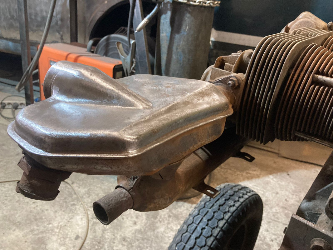

We completely rebuilt the rear engine air duct and the air duct sidewalls that make up the engine bay itself;
Installed trunk floor amplifiers;
Welded all the previously removed (and missing) elements of the mudguard and amplifier of the engine compartment;
Cleaned up all seams and welds.
After that, all seams were treated with acid, then with acrylic primer. Of course, everything will be sealed and painted, but you can’t leave bare metal inside (The boiled soil is a wonderful thing, but it burns out especially at the welding point).
In addition to the seams on the side of the engine compartment, the painting of the inside of the engine air duct had to be completed.
Despite the fact that the panels were partially painted before assembly, they touched the welding ground along the joint.
All burnt places on the welding soil were completely cleaned.
The existing paint on the planes was matted with scotchbright, and the air duct was painted according to the scheme:
1. Acid primer on bare metal
2. Acrylic paint 2k
3. Epoxy primer Dupont P7
4. Sealing seams and joints with polyurethane sealant
5. Acrylic paint 2k
We were very happy (no) when we did all this in such a narrow and curved space.
Most of the work was done with a mirror.
It turned out terribly difficult, long and multi-staged.
Quality needs to be expected!

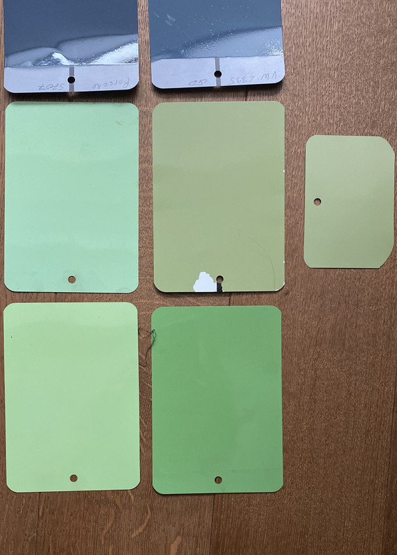

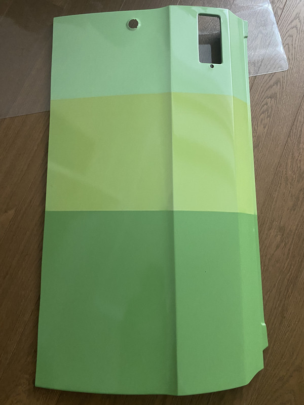

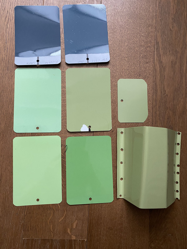

At the same time, I decided to search for color.
Earlier, I had already started looking for a recipe for Avocado green paint.
But the search turned up nothing, no one knew the recipe for the rare Australian paint.
The manufacturer of this paint was Dulux, and I decided to look for contacts of this company.
Dulux in Europe no longer deals with car paints.
Dulux is part of AkzoNobel Corporation, which owns Sikkens. They continue to make car paints.
I contacted Sikkens Russia but they couldn't find any information on the code.
Then I wrote an appeal to Dulux and Sikkens Australia.
But they couldn't help either.
I began to study the Australian paint market and discovered that there is a company called Dulux Automotive, which is just engaged in automotive paints!
I wrote to them and they still have the old archive! Hooray!
Huge thanks to Chris Lee, he sent me the paint recipe and even offered to make a colour card for free and mail it to me! Wow!
Unfortunately, since February 2022, it has been very difficult to send anything to Russia, and Chris did not manage to send the parcel either by mail or by DHL.
Chris sent me a photo of the card, but I was embarrassed to ask him to look further for possible shipments. He has already done quite a lot for me.
With the paint recipe and color card photo, I decided to write to Sikkens Russia again. They were very surprised to learn that I got the archive code and a photo of the paint.
But again they could not help with the manufacture of the paint. Because they don't have the Autosolv base in which the code is written.
Ok, I decided to look for someone who has this base in Russia.
But I didn’t find anything, apparently no one uses it here.
Then I decided to choose the color according to the colour card (I understand that it’s a bad option, but maybe it suddenly works out).
I found colorists and we started experimenting.
Made 3 paints. They all looked like Avocady green, but it still wasn't the same.
We also painted a car door to look what it like.
I was upset and for half a year I forgot about the paint.
After half a year, I accidentally found a friend of friends of friends of friends who lives in Australia Cool
I asked him to write to Chris, in case he hadn't thrown out the colour card yet. And try to send it to Russia.
Chris kindly agreed to help and found it! hooray!
Another 2 months of waiting and I had the card.
The color was very different from what I tried to do myself.
It looks great in the sun and will fit the car perfectly.
Here all colours that we were choose.
With Indoor lightes, the color does not look as cool as outdoor. I'll take new pictures later.
Hope I will choose this colour, but who knows Rolling Eyes

The clean up and new fabrication look great. Some of that is the hardest areas to work on, on these cars as they're known to have little traps or pockets that are nearly impossible to access.
Hopefully the color you choose is the one you like the best. On my own car, it was Ruby Red, but I ended up doing a color change to a BMW metallic medium blue. I've been happy with it for over 20 years now, and haven't regretted the color change. But then I'm not a purist either, and built my car for me to enjoy.

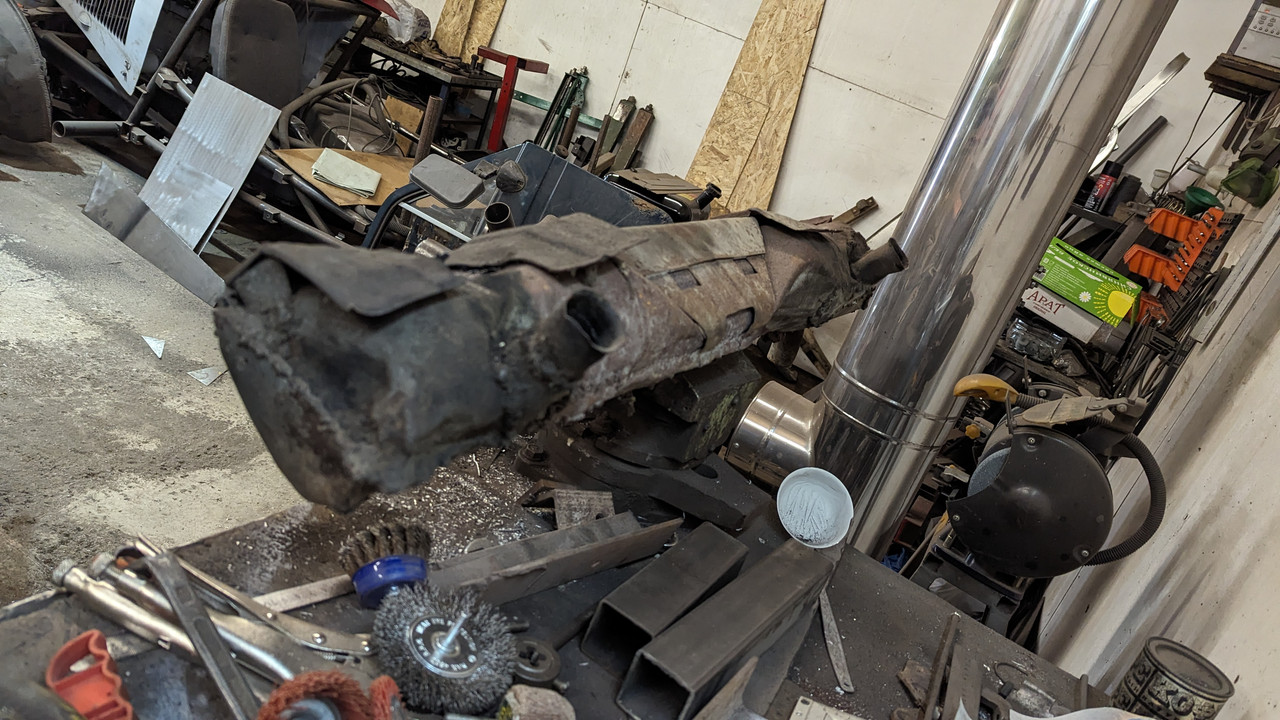

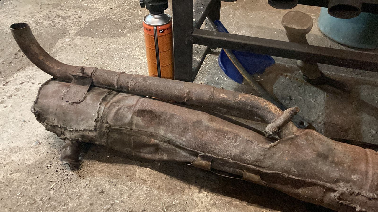

Gentlemen, I need Your help!
We started to explore engine and restore exhaust system.
But I had some questions about exhaust: what kind of muffler will fit my car?
My muffler looks like this:
But i am not shore that it is from my type of engine.

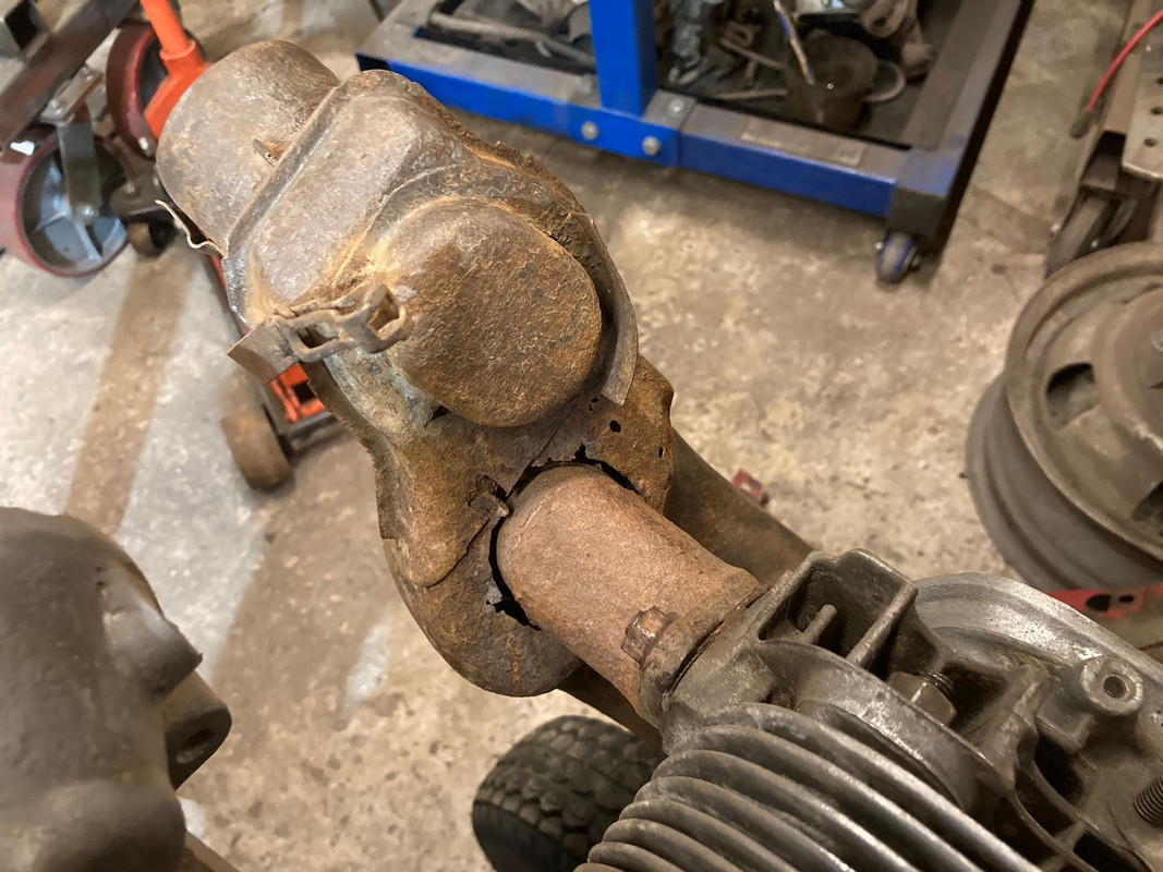

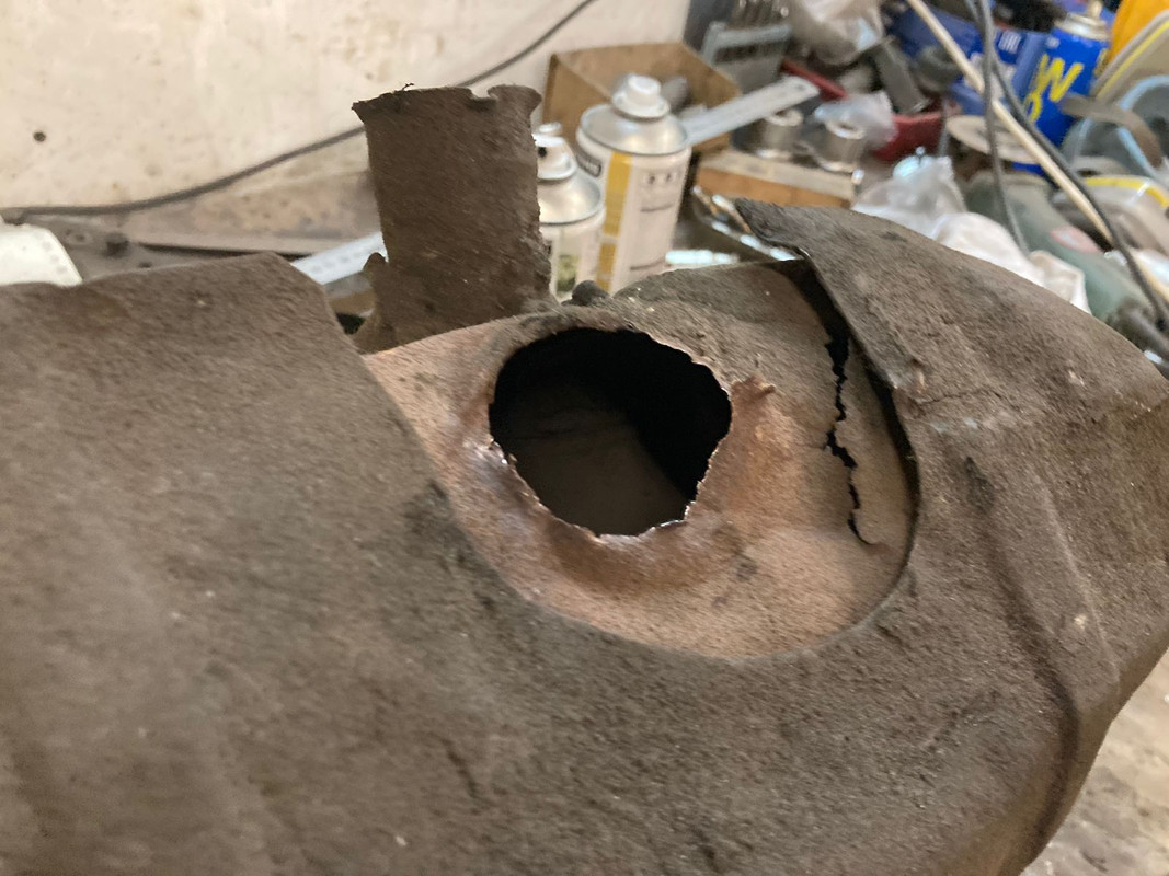

i have twin carb and Eberspächer system, and i want to save heater system.

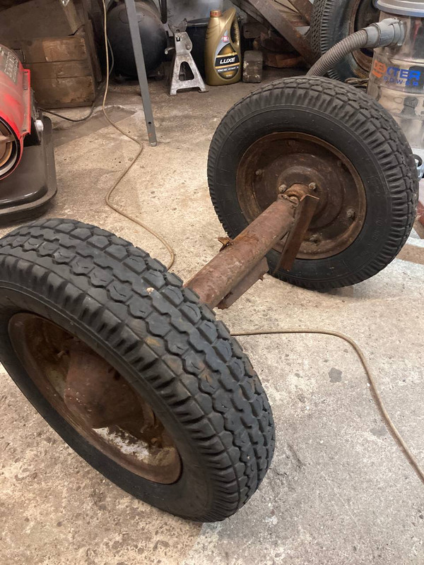

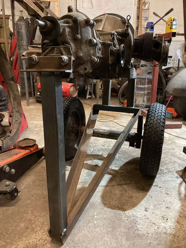

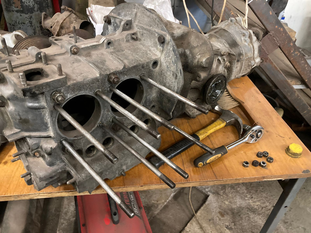

The engine is assembled for fitting and troubleshooting.
Some parts were mistakenly painted by the previous specialist, but they are faulty and need to be repaired.
And also here is some photos of engine:
heimlich Premium Member
VWNOS.com
Joined: November 20, 2016
Posts: 7429
Location: Houston, Texas
heimlich is offline
PostPosted: Mon Mar 25, 2024 7:07 am    Post subject: Re: 1972 Squareback from Russia Reply with quote
What are you needing for the muffler? Is it the part number for a new one?
splodge
Joined: May 27, 2019
Posts: 53
Location: Russia, Saint-Petersburg
splodge is offline
PostPosted: Mon Mar 25, 2024 7:27 am    Post subject: Re: 1972 Squareback from Russia Reply with quote
heimlich, part number will be great!
or maybe someone have it for sale in good condition.
I found some ads, but I don’t know which one is suitable:
https://www.ebay.co.uk/itm/114835512176?itmmeta=01...SwIAVjTuwV (looks like mine)
https://www.ebay.com/itm/403350289045?chn=ps&m...Gkiol2wpDI
https://type3headquarter.de/epages/7b2adfc2-5ed3-4...HQ2G51B051
VWNOS.com
Posts: 7429
heimlich is offline
PostPosted: Mon Mar 25, 2024 7:43 am    Post subject: Re: 1972 Squareback from Russia Reply with quote
That one in the UK looks like the best deal. It looks new. It is also the best manufacturer - Leistritz. They always had the thickest metal in the mufflers. It is closest to you as well so the shipping would be easier.
It definitely looks similar to yours. You'll need to match it to your car somehow.
splodge
Posts: 53
splodge is offline
PostPosted: Mon Mar 25, 2024 7:45 am    Post subject: Re: 1972 Squareback from Russia Reply with quote
heimlich, Thank you! Your advice is very important!

PostPosted: Mon Mar 25, 2024 2:07 pm    Post subject: Re: 1972 Squareback from Russia Reply with quote
Yes, that's the one you want. What's not on it are your "pre-heater" boxes that you already have and have cleaned up (the large nuts screw into the muffler), and you're missing the tail pipe (on yours it's one piece and a large diameter pipe in &out). It's for a 72-73 type 3 only that you're looking for. Part number 311 251 061F and tail pipe (dampener # 311 251 153C ). I hope this helps.
