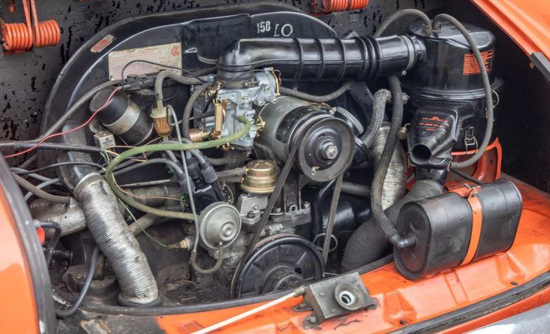

The transport company is delivering our '72 Ghia Coupe today. We're pretty excited!
I want to do a basic tune up and replace the fluids right out of the gate (the transmission fluid debate post was very enlightening and entertaining Shocked ). But I've noticed there are different distributors, and being new to VW's I'd like to ask a couple of dumb questions.
First, I noticed there are ignition parts available for several distributor types - 009, 050, and stock Bosch. How do you identify which distributor you have?
Second, I also noticed references on the vendor sites to Type 1 and Type 3 engines. What's the story on this, and how do you ID?

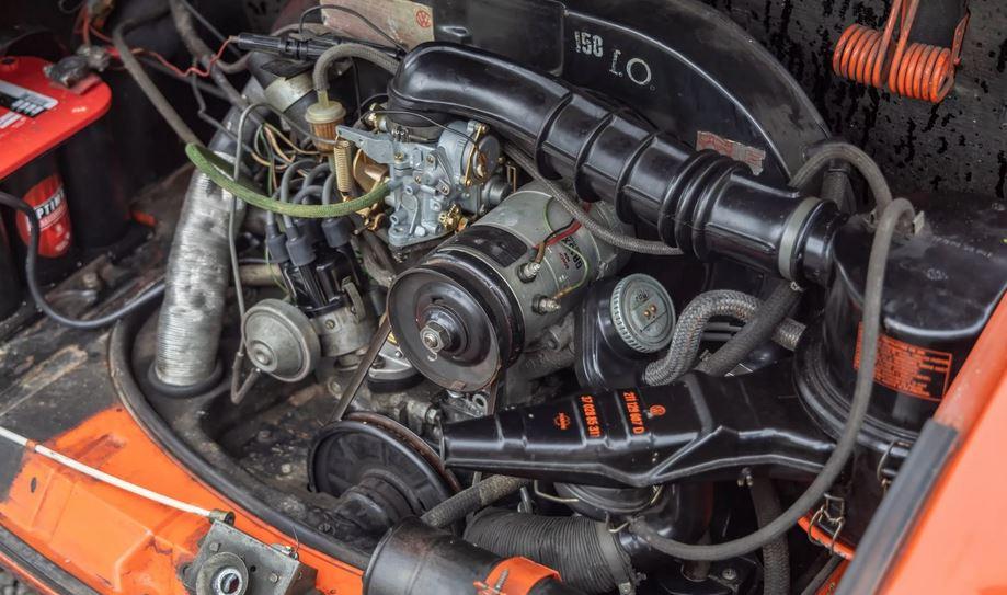

I've included engine bay pics from the BAT listing, since the car hasn't arrived yet. Thanks in advance for helping a VW rookie!

You have a Type 1 dual port engine. The carb and distributor will have part number on the side of them.
Yours looks to be the correct one foe your year, a DVDA, meaning it has both vacuum advance and retard along with mechanical advance.
Double check the distributor number but it looks to be a 113-905-205AN.

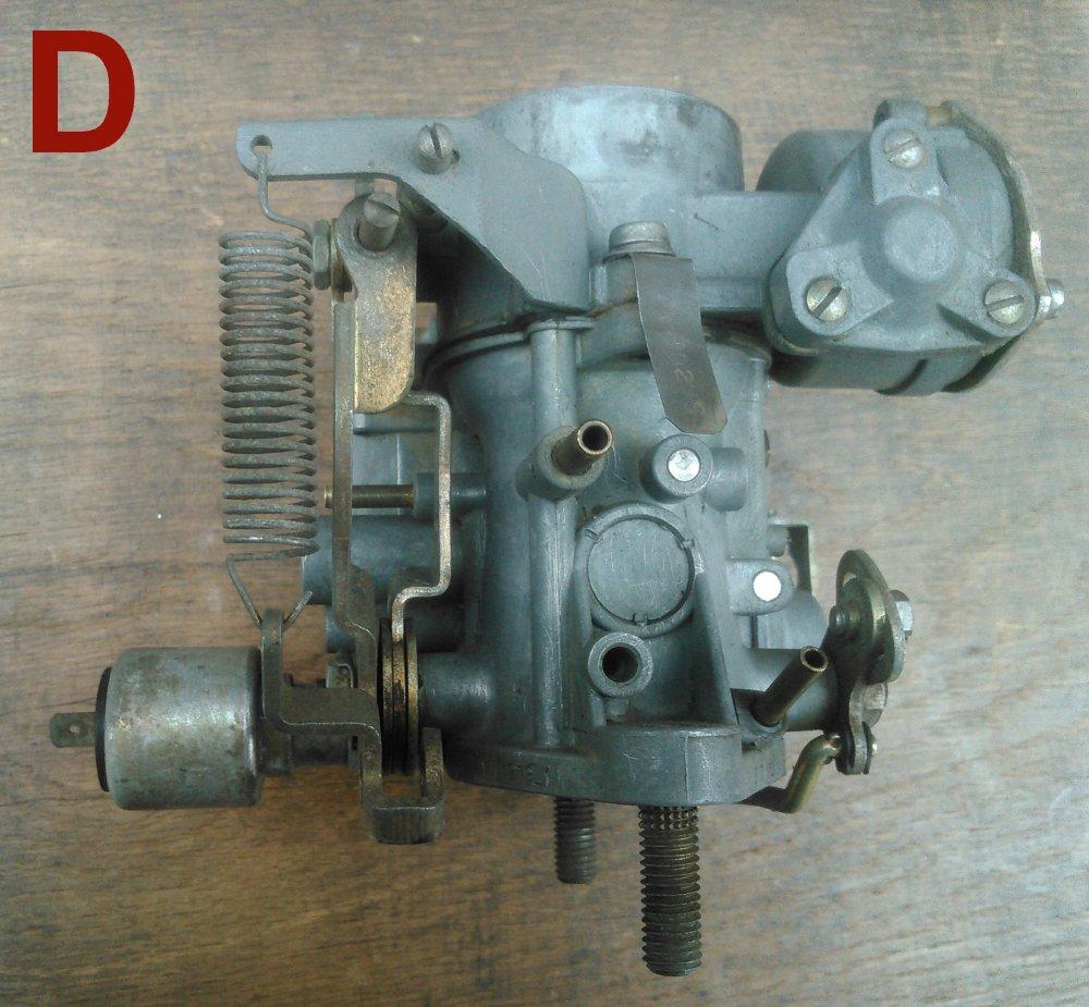

One thing to be aware of with your DVDA distributor, is that it requires a DVDA-compatible version of the 34pict-3 carb to get maximum performance. The DVDA-compatible version has a larger size hole in the throttle butterfly, and you can determine if it is compatible or not by the base flange number on the carb. Alot of people poo-poo the DVDA because they're trying to run it with an SVDA-compatible version of the 34pict-3.
I can't quite tell from the pic, but it looks like you might have an aftermarket replacement carb. If so, it might be worthwhile for you to track down the correct carb for your DVDA distributor. If you find one that needs rebuilding, contact Volkzbitz.com
Any carb that matches with the 205AN will work
Or conversely, you could pic up an original German Bosch 034 SVDA to go with that carb you have. Several folks in the classifieds rebuild them if need be. Don't buy an aftermarket SVDA though. The advance curve from the aftermarket vac canisters aren't the same as original.

Looks like you have an original distributor. The numbers should be on there. There will be at least a Bosch number. You may also set another set of numbers that are three sets of three numerical digits followed by one or more letters. If you could write down what they are I can provide you a list of tuneup parts.

That's a very original looking engine right there with the factory stenciling on the fan shroud still legible. I love original survivor engines. It does have an aftermarket fuel pump where it should have a German Pierburg square top fuel pump installed. It's missing the throttle positioner on the carb.
As the other poster noted, the carb looks aftermarket and if so, its not a correct match for a DVDA distributor. The hole in the throttle plate is too small so it will struggle to idle when timed to 5° ATDC. [email protected] will have the correct rebuilt German Solex carb if you want to get it back to bone stock.
However, the DVDA distributor was one of the three parts of the smog system. Your carb doesn't have the throttle positioner installed so your altitude corrector isn't hooked up either if it's still in the engine compartment. If you don't plan on running those smog items, you don't need to run the DVDA distributor and you could transition to a restored Bosch SVDA distributor which will work with an aftermarket 34-3 carb. Very few VW's still on the road are running the smog equipment anymore. Usually the altitude correctors are inop as the two diaphragms inside them dry up and blow out.
I don't know that it was always the case that DVDA dizzy and carb setups had to have the throttle positioner. Tim recently rebuilt this carb for me. Base flange number 377-2 and it doesn't have the vacuum port for the throttle positioner on the lower right.
This carb from the gallery is also for use with a DVDA, but it does have the port for the throttle positioner on the lower right.
I haven't been able to find details on exactly why this is, or what setups were used when, or possibly for different markets. Maybe someone can shed some light on this.
1972 was the last year of the throttle positioner and altitude corrector. Your 377-2 is a 1973 carb. VW still used the DVDA distributor 113905205AN in 1973 but discontinued the throttle positioner and altitude corrector.

Your generator is clocked wrong, it needs to be rotated CCW 1/4 of a turn for proper cooling.
Its correct as is.

Era Vulgaris - I was finally able to get under the hood and take a look around, and confirmed the distributor to be a 113 905 205 AN. The carb is a Bocar (aftermarket?) 34 PICT-3 , and the tag says its a part # 113 129 021 P. I'm not sure how to cross the Bocar number over, searched online and didnt see anything. Any thoughts on how to confirm compatibility of this carb to the distributor?
Runs well in the mid- and high-range, but struggles at times when starting off in 1st or reverse, and will sometimes bog down and die. Then I have to floor the accelerator to restart it, and it takes 3-5 seconds. 3rd gear can seem a little dogged at times.
I have a Bocar with a similar DVDA distributor. They work well together. You can adjust the distributor to work well with the carburetor.
Good to know, thanks. I'll see what I can find on setup, tuning, etc. for the Bocar. I assume it would be the same, as it appears to be an exact copy.
Good to know, thanks. I'll see what I can find on setup, tuning, etc. for the Bocar. I assume it would be the same, as it appears to be an exact copy.[/quote]
It should run nicely with the Bocar. Bocar is OEM Mexico carburetor. I know other people who run the DVDA and SVDA interchangeably. I have yet to meet anyone who can fully commit that there is a significant difference in how they run with the different butterfly. I'd like to find that person.
