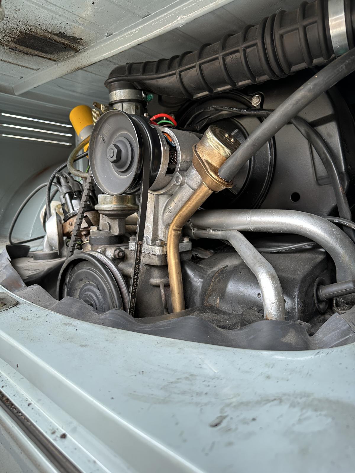

PostPosted: Mon Feb 20, 2023 8:48 am    Post subject: Re: Blown Engine (1500cc Air Cooled) - Advice Needed Reply with quote
Here are some pictures and video.
Dusty1
Joined: April 16, 2004
Posts: 2096
Dusty1 is offline
PostPosted: Mon Feb 20, 2023 9:14 am    Post subject: Re: Blown Engine (1500cc Air Cooled) - Advice Needed Reply with quote
O.k..
Considering what you likely paid for that Brazilian Bus we shouldn't be able to find fault with your motor. But...
It shouldn't be oily. It is.
All of the lower engine tin should be in place. It isn't.
There should be OEM pushrod tubes available for chump change in Brazil. Your motor has a set of mix 'n' match pushrod tubes.
And...
Bent and broken fins on the heads indicate it was assembled out of floor sweepings. Brazil was the last place that manufactured new OEM heads.
Next, the 35E. Last time I drove though there I near got run over by Texas sized trucks and SUVs in a big hurry to get where they were going. I don't know where they're all going. They're going to be way early wailing up and down the 35E between midnight and daybreak.
Maybe they're rushing to West for a fresh batch of kolaches. Very Happy
It's 80 miles from San Antonio to Austin. Google Maps says it should take me an hour and twenty minutes. I made it in under an hour with the Texas plates on numerous duallies and Texas sized SUVs centered in my rear view mirror, pushing. Or maybe they were drafting?
Point is if you drive an old Bus like that you're goin' to blow your new motor right quick.

PostPosted: Mon Feb 20, 2023 11:03 am    Post subject: Re: Blown Engine (1500cc Air Cooled) - Advice Needed Reply with quote
Why do all the Brazilian busses have that clear vinyl tubing (with no hose clamps) for fuel line? That thrown rod may have saved you from a fire.

PostPosted: Mon Feb 20, 2023 11:17 am    Post subject: Re: Blown Engine (1500cc Air Cooled) - Advice Needed Reply with quote
no heat risers on exhaust?

PostPosted: Mon Feb 20, 2023 1:43 pm    Post subject: Re: Blown Engine (1500cc Air Cooled) - Advice Needed Reply with quote
No thermostat, either.
That engine is a dog's breakfast of parts.

PostPosted: Mon Feb 20, 2023 3:53 pm    Post subject: Re: Blown Engine (1500cc Air Cooled) - Advice Needed Reply with quote
Yes, lots of red flags on the outside of this engine, I would expect the inside to have a few too especially as it didn't last very long. If it were my Bus I would just be happy to have a good rust free body, the mechanicals are the easy part to fix.

PostPosted: Mon Feb 20, 2023 4:01 pm    Post subject: Re: Blown Engine (1500cc Air Cooled) - Advice Needed Reply with quote
That plastic tubing is not gasoline-resistant and will melt/catch on fire readily !!!
No tins underneath, not good.
Generator clocked incorrectly.
No loop or shepherd's crook in vacuum advance tubing.
