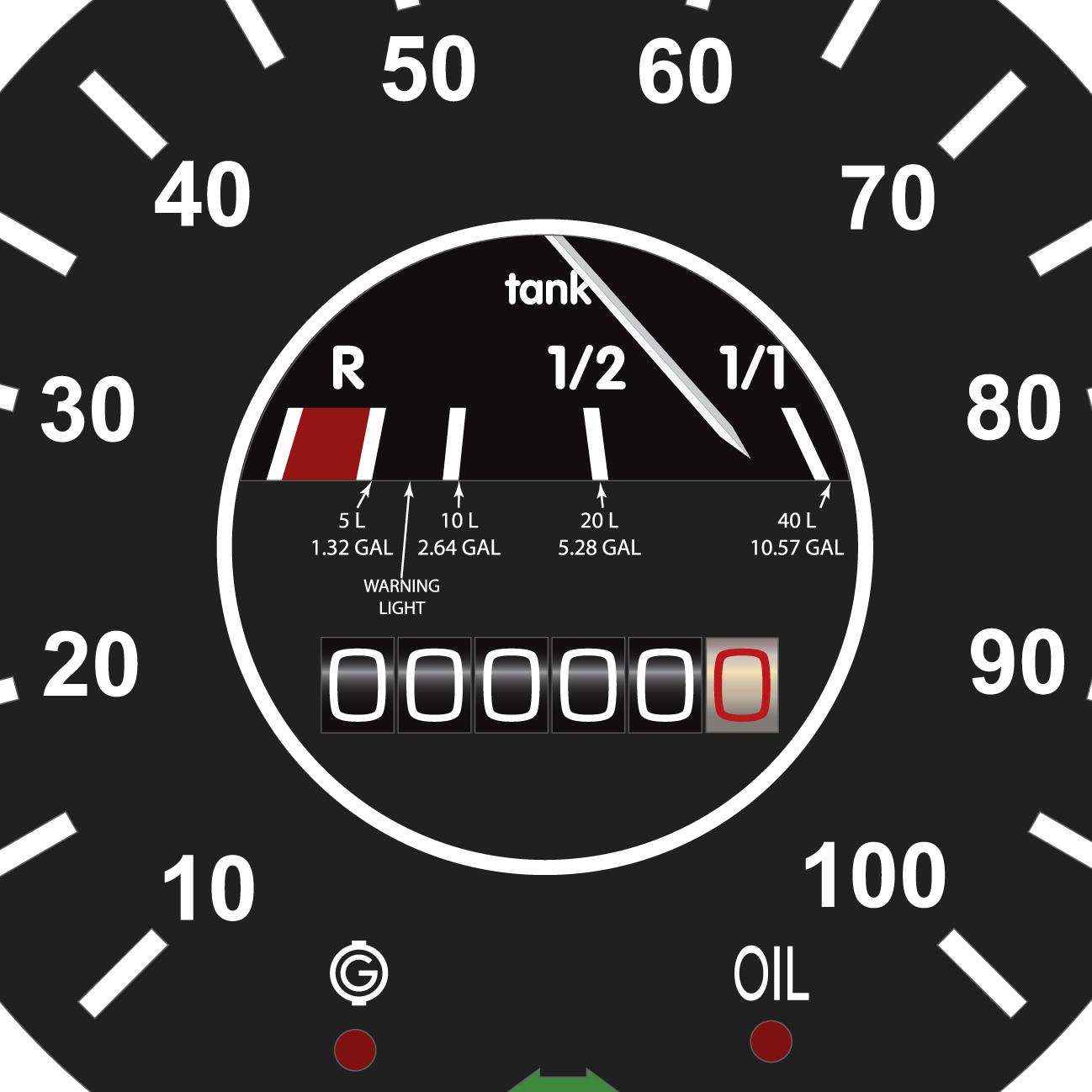

First, I will drain the fuel tank. My Thing’s fuel tank is said to hold 40L. Making my measurements in metric will keep the arithmetic simple.
Next, I will add measured amounts of fuel for each set point.
My four set points will be 5L, 10L, 20L, and 40L.
I will pour in 5L of fuel, and using the MeterMatch, set the fuel gauge to read “top of the red”.
Then pour in another 5L, and use the MeterMatch to set the fuel gauge to read 1/4 tank.
Another 10L for 1/2 tank, and another 20L for full.

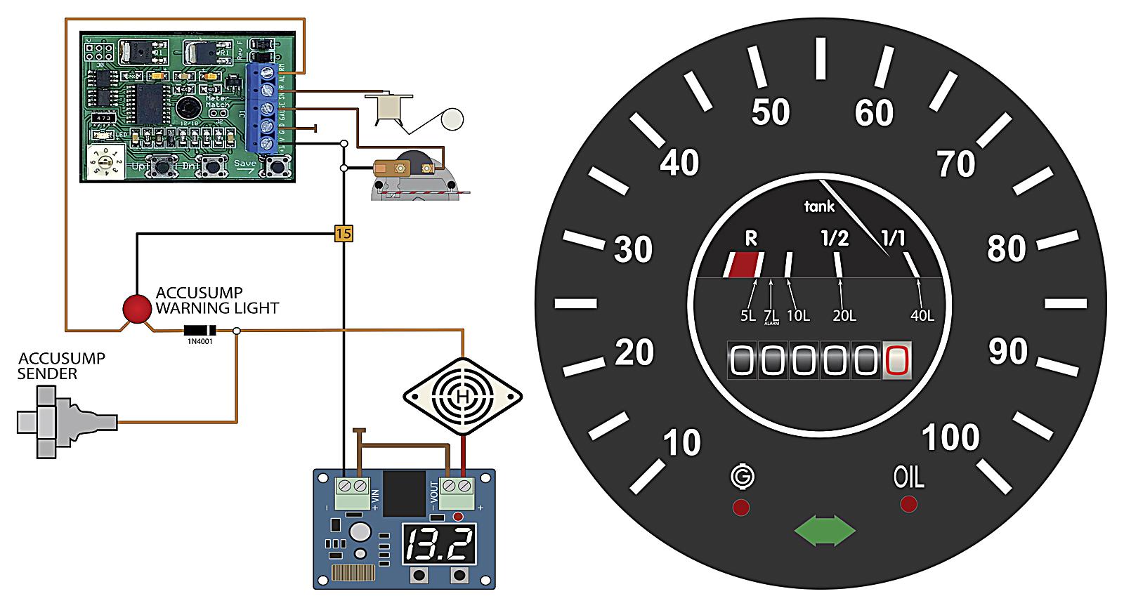

The MeterMatch unit has a provision for a low set point alarm, which I intend to set at 7.5L.
The alarm provision will flash an existing LED indicator already in place on the dashboard.
As an explanation of the wiring diagram…
My Accusump has an additional oil pressure sender which provides a path to ground when engine oil pressure is being provided by the Accusump (rather than by the oil pump). There is also a piezo buzzer which will sound under the same conditions. System voltage is sent to the piezo buzzer through a low voltage cutoff device, so that the buzzer can only sound when the engine is running (and therefor, system voltage is at or above 13.2V). All of this is already in place (before the MeterMatch installation).
The MeterMatch device can be set to provide a pulsing (or steady if desired) path to ground for a low fuel warning light. My intention is to set the MeterMatch device to pulse the Accusump warning light when the fuel level drops to ~7.5L (2 Gal.). The diode will prevent the piezo buzzer from sounding with the "low fuel" warning.
So, in use, when the Accusump warning light is flashing, it indicates low fuel.
When the Accusump warning light is on steady, and the piezo buzzer is sounding, it indicates that engine oil pressure is being provided by the Accusump (rather than by the oil pump).

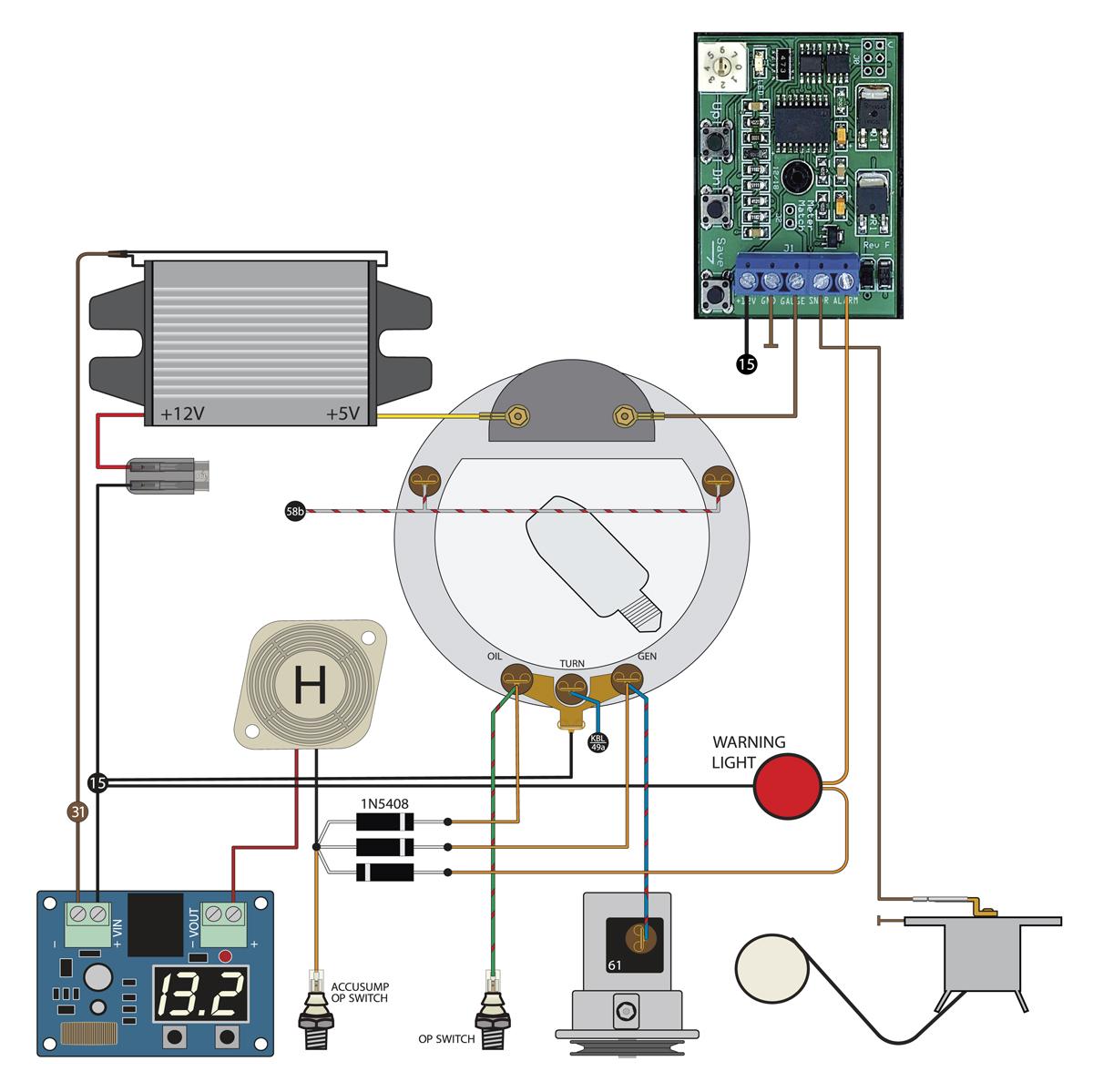

Meanwhile, I have sketched a revised wiring diagram which includes a 5VDC regulated power supply to the fuel gauge. There's some extra stuff in the diagram, but it should be understandable.

So are you planning to use the mentioned later vw 5 volt regulator or something else? Despite my earlier comment I'm also interested in seeing how this turns out, I can think of several uses for such a thing.
mondshine
Joined: October 27, 2006
Posts: 2812
Location: The World's Motor Capital
mondshine is offline
PostPosted: Mon Dec 05, 2022 8:36 am    Post subject: Re: MeterMatch Reply with quote
Kevin-
This is the buck converter I intend to use:
https://www.amazon.com/dp/B07P663XJV?psc=1&ref=ppx_yo2ov_dt_b_product_details
It's about the same size as the standard vibrator, and could be mounted on the back of the speedometer case like the original.
I probably could use a smaller capacity converter (it would have been physically smaller too), but this one worked nicely on my "test rig".
These inexpensive buck converters are more efficient than a single regulator chip (like VW used in the '80's), so heat from the chip is not an issue.

Starting with a drained fuel tank, I added measured amounts of gasoline and set the gauge to read "red", 1/4, 1/2, and full.
Anyway, the Meter Match installation is done.
It seems to have worked perfectly, just as it was designed.
My car has an additional LED warning light and piezo buzzer for the Accusump, which I was able to integrate into this electronic marvel; the envy of the civilized world. Wink
Two more sketches:
