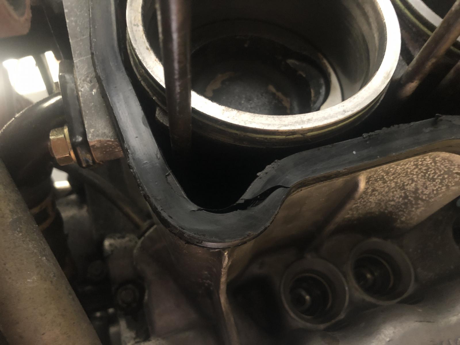

Just experienced the exact same thing with Elring water jacket seals. Evil or Very Mad
See my other post here:
https://www.thesamba.com/vw/forum/viewtopic.php?p=9984453#9984453
1989 Vanagon GL - 2.1 (White - "Northlake" Totaled/Gone)
1988 Vanagon GL Wolfsburg (Orly Blue - "Poulsbo" - Sold)
1989 Vanagon G - 2.1 (White - "Kingston") - Full rebuild underway - Last on the road in 1997

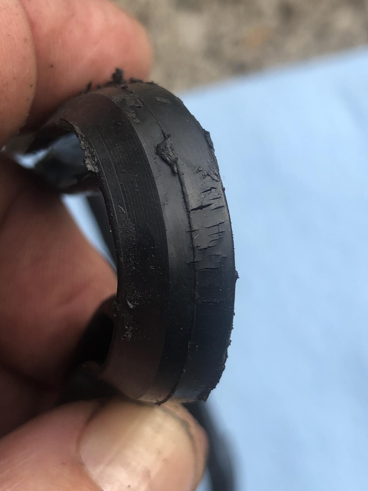

uff ta. those cracks make me sick. i was thinking you had a clearance issue but those cracks scream poor material quality after only 5k miles. would they have cracked similarly prior to install? dunno but might be a possible fore-warning if we 'bend test' new seals. i suspect all would pass initially, that this is a heat issue with poor materials that shows up after baking a while.

The question I have about the gaskets is: Do they have a manufacture date on the package? Last time I did Vanagon head gaskets was about 1 1/2 yrs ago and I don't recall if there was a date on the packaging. The gasket sets were Victor Reinz. Still working fine with near 10 K miles. One of the reasons I wondered about the date of manufacture is that after I got out of full time working on vehicles, I worked at an aircraft company. All plastic, rubber, and silicone seals/gaskets for aircraft (at least in the USA) have a manufacture date and in some cases a use by date. So even if it sits in climate controlled storage in a sealed package, many seals are not to be used after a certain time. Otherwise they may quickly look like the photos the others posted.

Good Morning from Amsterdam. I got a nudge in my Inbox saying this subject of cracked head seals was still alive! To my knowledge there are no date stamps on the major gasket makers for the wbx. Namely VR or Elring. We had a bad batch of Jacket Seals some years back with a whole lot cracking as in your photographs... Elring refused to accept responsibility. Anyway, 3 Engines were affected, EXACTLY as the photographs here. I've come to the endless conclusion that it's a question of luck!...... bad luck. I would advise using the rubber sealant that VR supplies, as I find this very stable. Maybe it's an idea NOT to use too much and whatever is instructed, I use sealant on both sides of the cylinder seal, a very small amount on the lower and 0.5mm on the upper. When the heads are bolted down into position (50Nm), there should be a tiny beed squeezed out, then you know you've done well. Don't use too much as this can cause distortion of the rubber seal. Good Luck..... and maybe stay away from obviously NOS Gasket Sets!......

Thanks for the info from Europe Mark. We've been dealing with WBX head seals for 35 yrs. When the first leaker came in, 1984, a little examination of the parts revealed what was happening. It was clear that the major problem was the coolant getting between the rubber gasket and the head. Then the aluminum would corrode, expand and break the seal. Of course any overheating situation will pinch and break the seals. So our cure, which turned out to match VWs later service bulletin, was to use silicone sealer on the rubber gasket to prevent the coolant from getting in there. We used what, in the USA, is called Ultra silicone or Oxygen Sensor Safe sealer. That has worked well. It was some yrs before Victor Reinz started including the sealer in their kits. On a few occasions the sealer in the gasket kits had hardened lumps in it and was unusable, too old. That was another item that had discard dates on it in the aircraft industry; silicone sealers. Some of them had a procedure where you get a certain amount out of the tube and if there were no hard lumps in it the discard date could be extended.
Funny that I used to worry about buying a new tube of sealer for the head gasket job, but $10 is nothing compared to the whole job and chance of failure.
