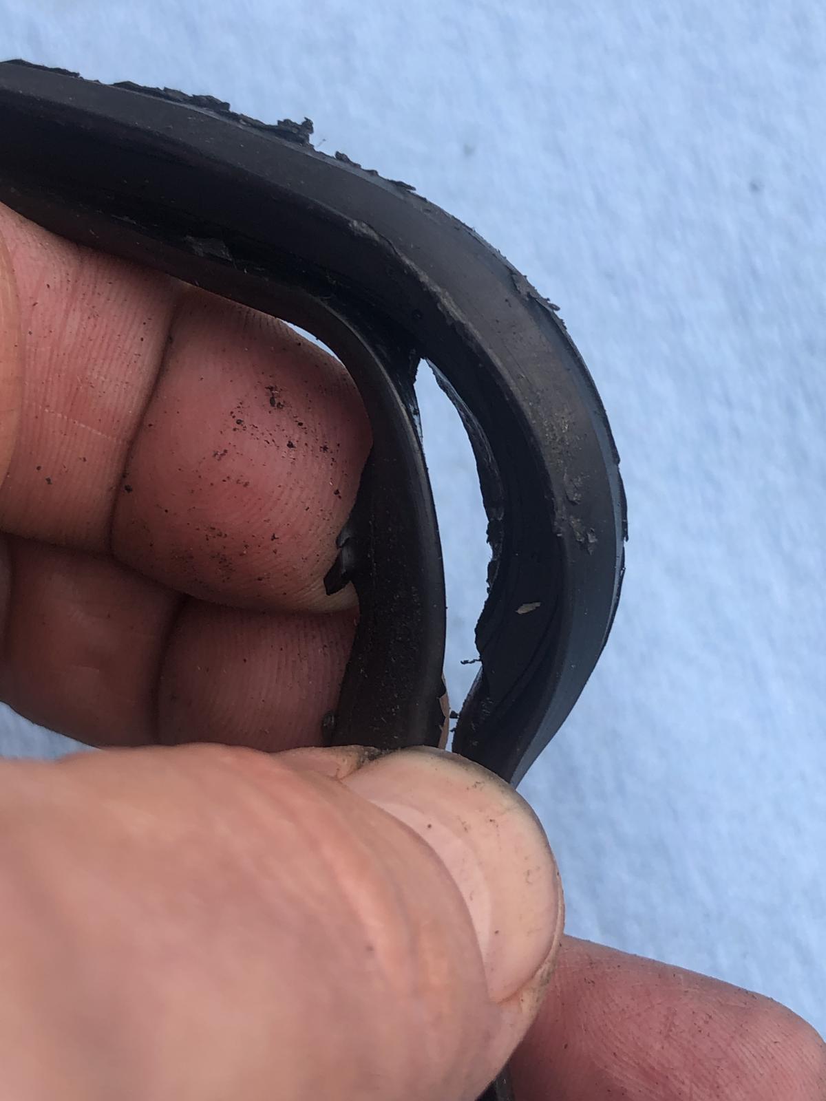

I finally got around to replacing the leaking water jacket seal on the passenger side of my van. If you remember, the rebuilt engine has less than 5K miles on it. I had to replace the drivers side water jacket seal after it failed about 1K miles ago. The first failure on the drivers side was exactly the same as this time. Unfortunately I am getting really good and tearing off the heads while the engine is still in the van. Shocked
The gasket set I used when I originally rebuilt the motor was the Elring brand. The new water jacket seals I installed were Victor Reinz. The following photos show what happened.
Seal bulging out between block and head
Split seal still attached to block
Split in seal
Cracks in seal when bent. These show up all along the seal, not just the in the corners where the splits occurred.
I will be contacting the vendor I purchased the set from and let them know that I think these parts are flawed and prone to failure. I am not a professional engine-builder by any stretch of the imagination. I take my time, keep things very clean, measure, weigh and measure again and in general feel that I am pretty meticulous when putting these motors together. After looking closely at these parts and having similar back to back failures, I am confident the failures were not from how this motor went together.
A word of advice to all who take on an engine rebuild. Check your parts before you install them. A lot of these NOS parts are old and have been sitting on a shelf or in a box for a long time. They should all be checked and thrown out if they are old. Despite looking and feeling okay before I installed these water jacket seals, I should have looked at these parts more closely for cracks and potential issues.
Live and learn!
