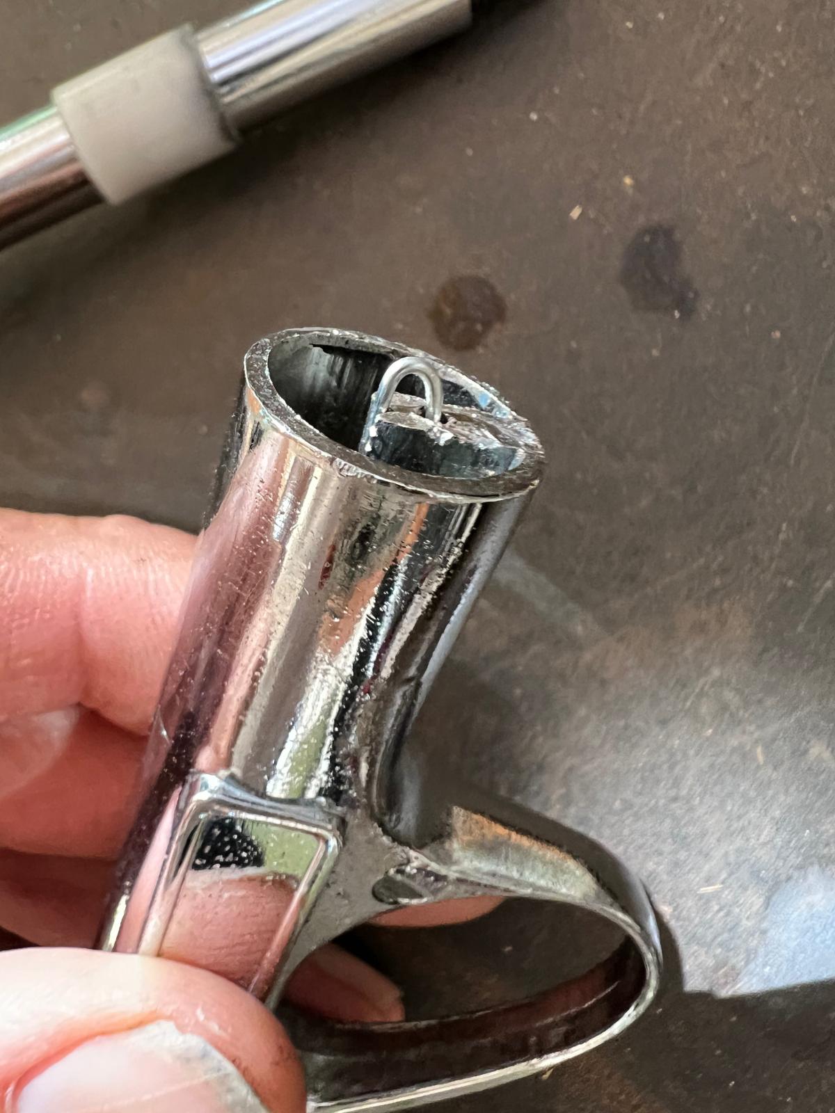

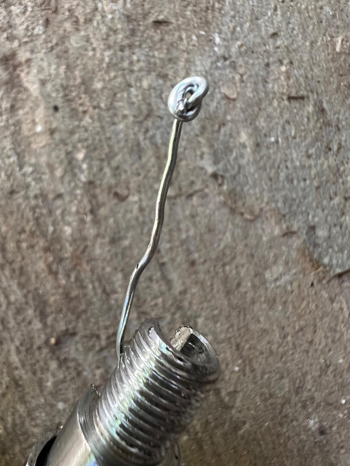

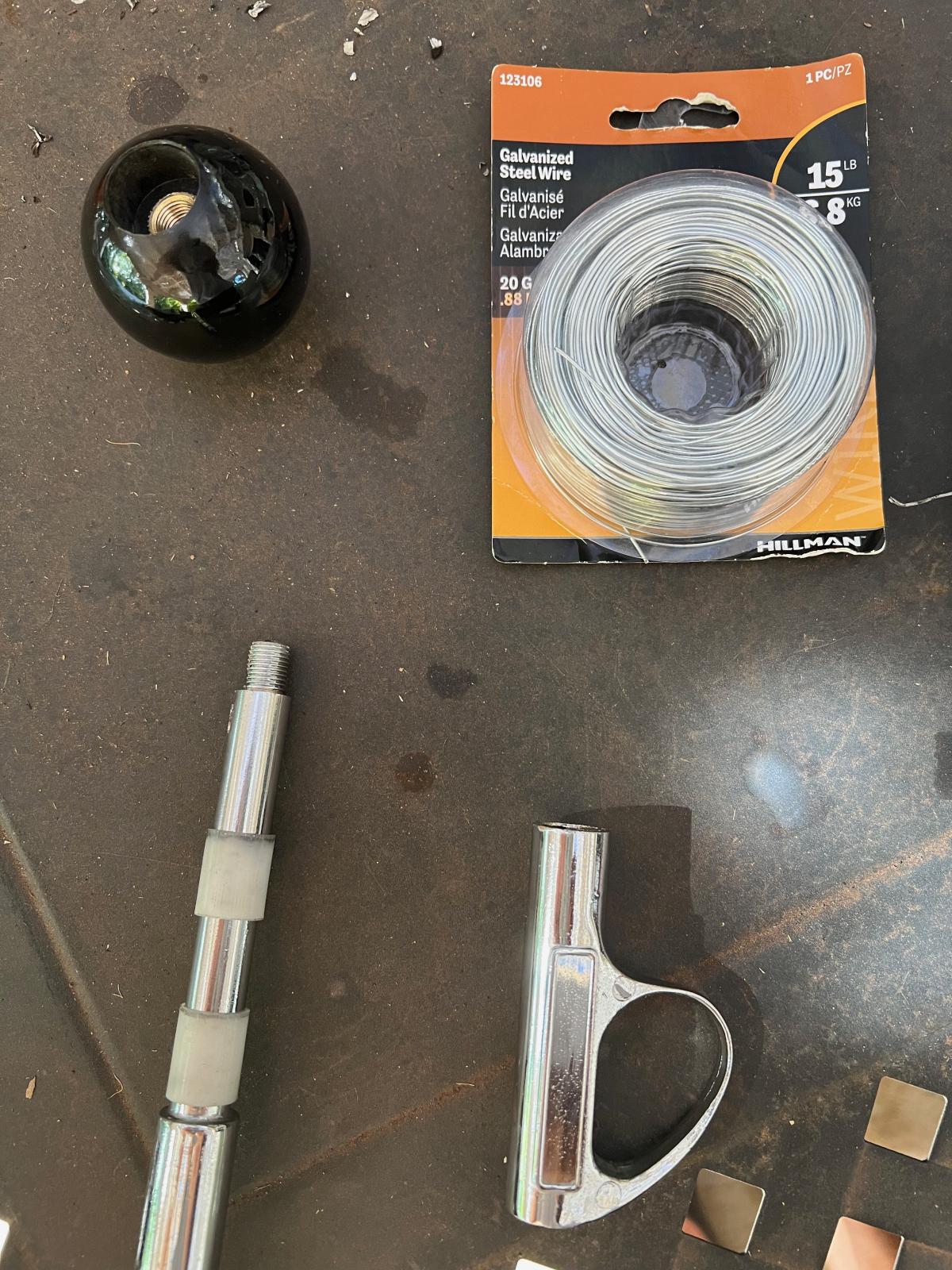

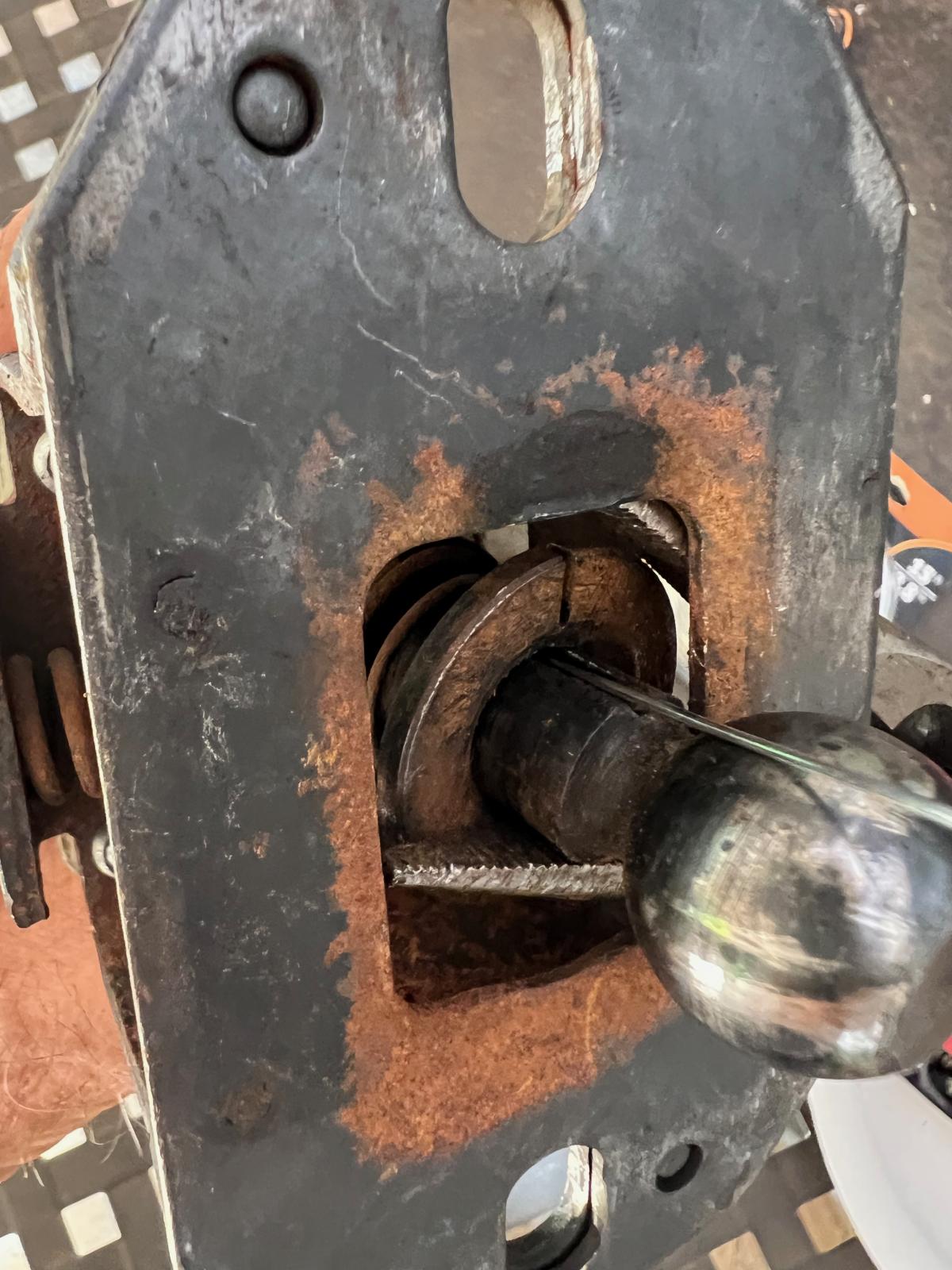

Shifter Reverse Lockout fix
I got impatient waiting for the EMPI shifter replacement, so I pulled the broken part to take a closer examination. Two 13mm bolts were holding the shift plate down, and unscrewing the ball above the trigger mechanism revealed the issue: the wire attached to the inside upper part of trigger was no longer anchored and had broken where normally one would find a tiny J-hook bend. This is what the setup normally looks like and was the first attempt at a fix:
A 1mm steel wire feeds through the hollow shift rod and remains under tension - as it pokes out the bottom near the ball in a small channel. Ideally, this would require a 19 gauge wire to fit properly, but I was able to find some 20 gauge steel wire at the local hardware store. The .88mm sizing is OK, enough to fit through the passages, but not nearly as robust as the OEM wire it replaced. Right next to it is a groove in the washer that is used to lock the wire into place by bending it over and ensuring that all slack is taken up at the reverse lockout trigger. Below you can see that it is helpful to use a pair of needle nose pliers into the spring plate to make insertion of the replacement wire easier.
The new setup was immediately tested by screwing back the repaired mechanism and checking how easily reverse worked. Too easily. The tiny J-bend was not enough to hold the tension and unravelled. The fix was to use the pliable nature of the wire to tie a knot in the end. This held properly. The other subtle adjustment that turned out to be key was to ensure that unlike the setup shown immediately above, is to keep the needle nose pliers inserted with the internal spring under tension, leaving about a 3-4mm gap of "free play" before locking the wire into place This made for a great improvement in shift quality smoothness - rowing through the gears is now quite pleasant with zero binding.

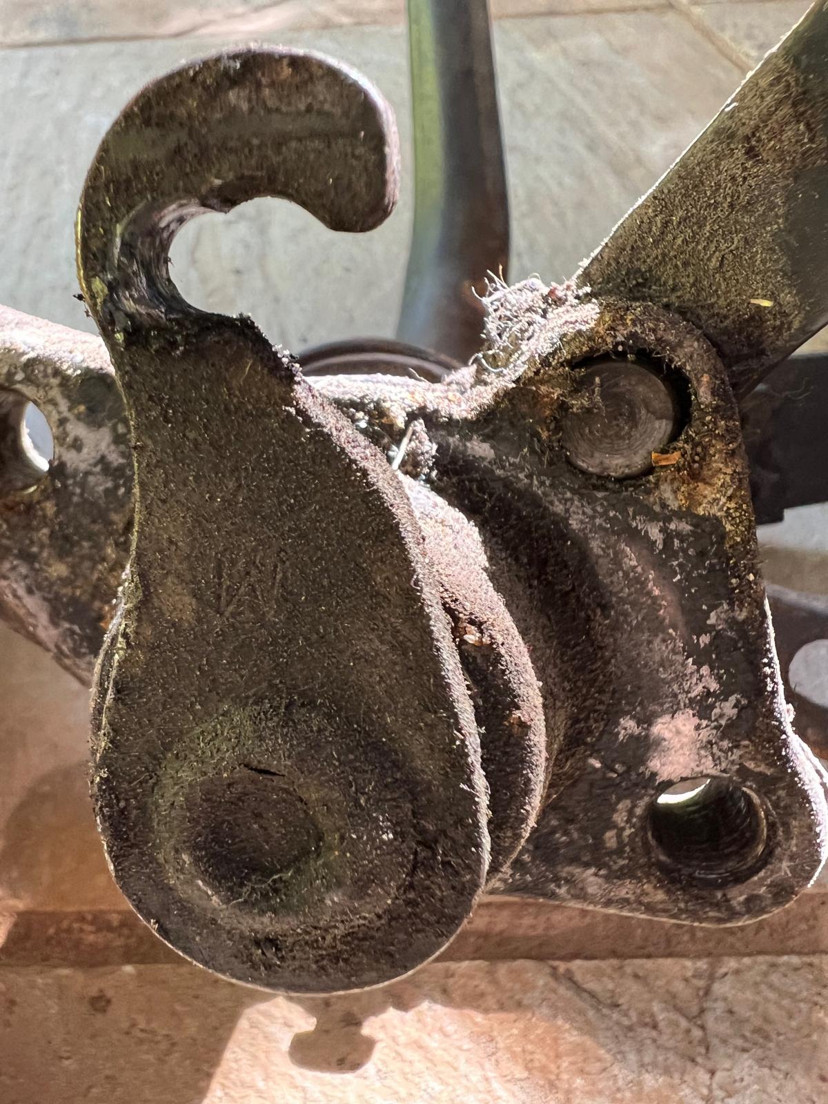

After a couple days of driving with the rebuilt shifter, the clutch mechanism started to fade once again, making it difficult to fully dis-engage the engine. I pulled the pedal assembly and found the culprit: a worn shifter cable connection. This seems to be a common failure point, and the replacement part can either employ the OEM hook mechanism, or one which bolts in place with a sleeve collar to prevent chafing in the future.
While in the same area, I noticed that the accelerator cable was frayed and down to the last two strands holding it into the latching mechanism. Will add this to the parts list on order, but it looks like the Ghia is off the street for a couple of weeks ...

I broke the clutch cable on my coupe a couple of years ago.
Upon removing the cluster I found the clutch shaft hook nearly worn through as yours.
I found these guys, Classic Bug Parts.
They had a great solution for the clutch hook.
I ended up buying the accelerator pedal upgrade too.
If you’re interested here’s their link.
https://www.classicbugparts.com/

thanks so much for the link, @kingkarmann. This is *exactly* what I was looking for - the improvement over the OEM design is clearly visible. The other nice feature is the option to extend the rod length a bit, in order to provide folks with "big feet" a bit more room in the pedal cluster by moving the clutch pedal further left, away from the brake pedal.

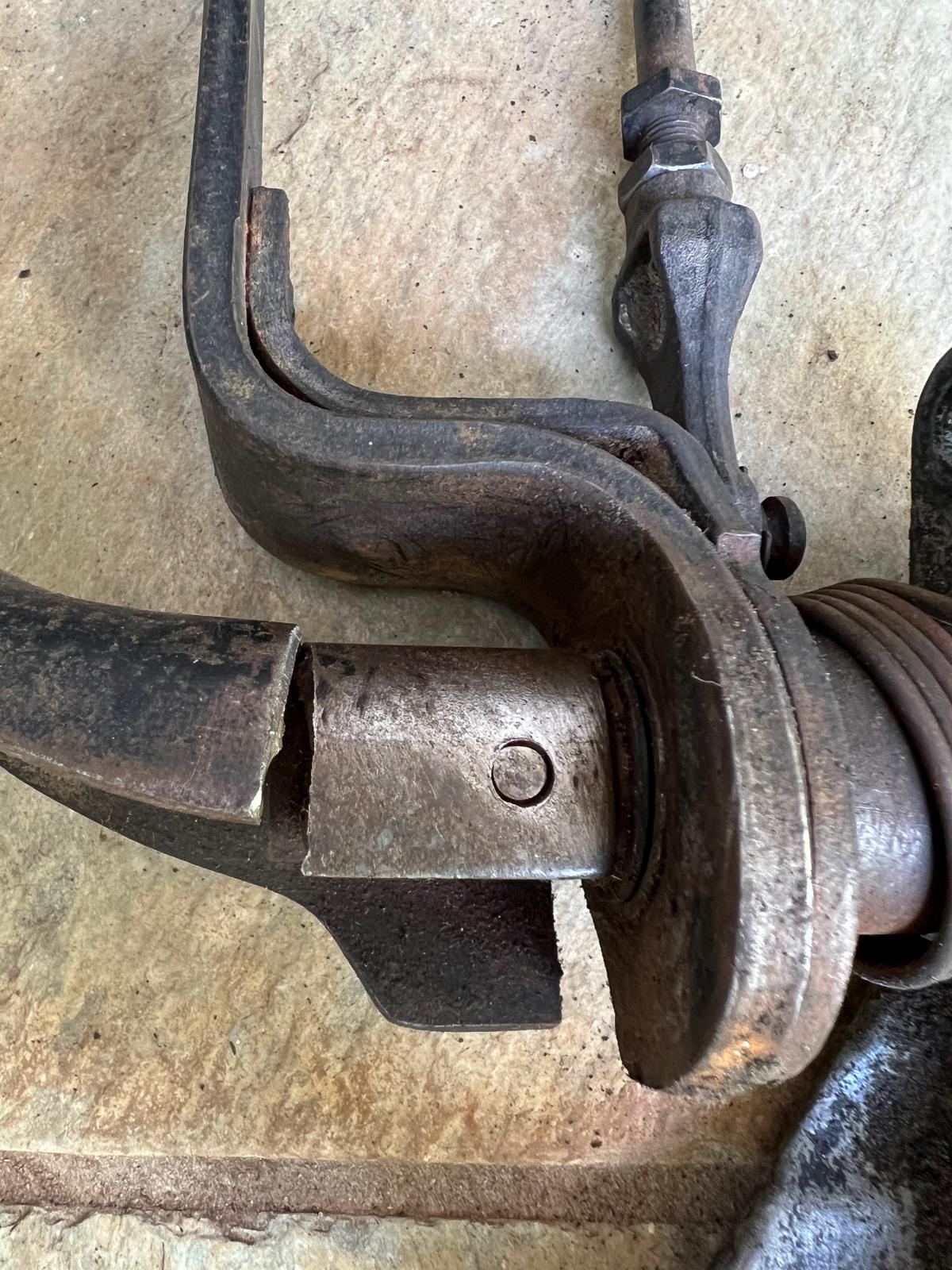

The hit parade continues
Scrubbing the pedal assembly yielded another failure point: the clutch pedal was shearing at the base where it connects with the linkage rod. To a certain degree, I am relieved since this explains the poor pedal action after taking out 1.5" of end play. Presumably that tightened up the cable, but set up another metal part for failure (the pedal). At this juncture, I believe I can avoid having to drop the engine to inspect the clutch throw out bearing. More items for the Ghia under the Christmas tree ...

All the parts for the petal assembly came in and went together without much fuss. The clutch 'hook' replacement from https://www.classicbugparts.com/ worked like a charm, provided very smooth movement, and was very easy to adjust to 1" of clutch play before engagement point. The accelerator cable went in easily and was a timely replacement having frayed to a final strand of wire. Very satisfying fixes.

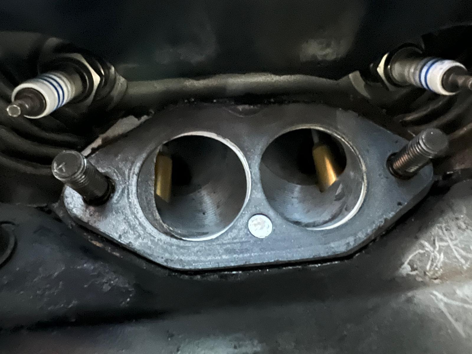

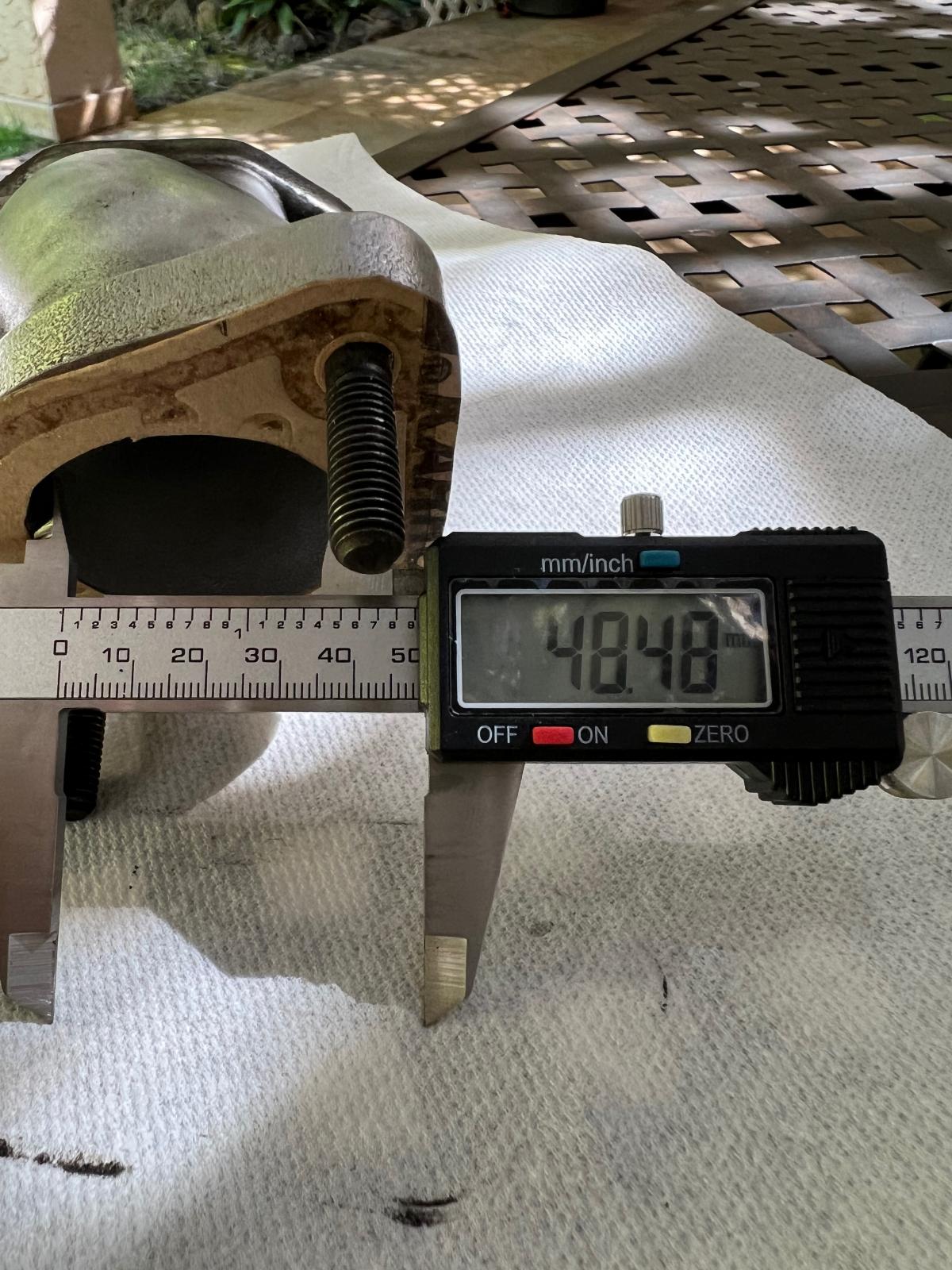

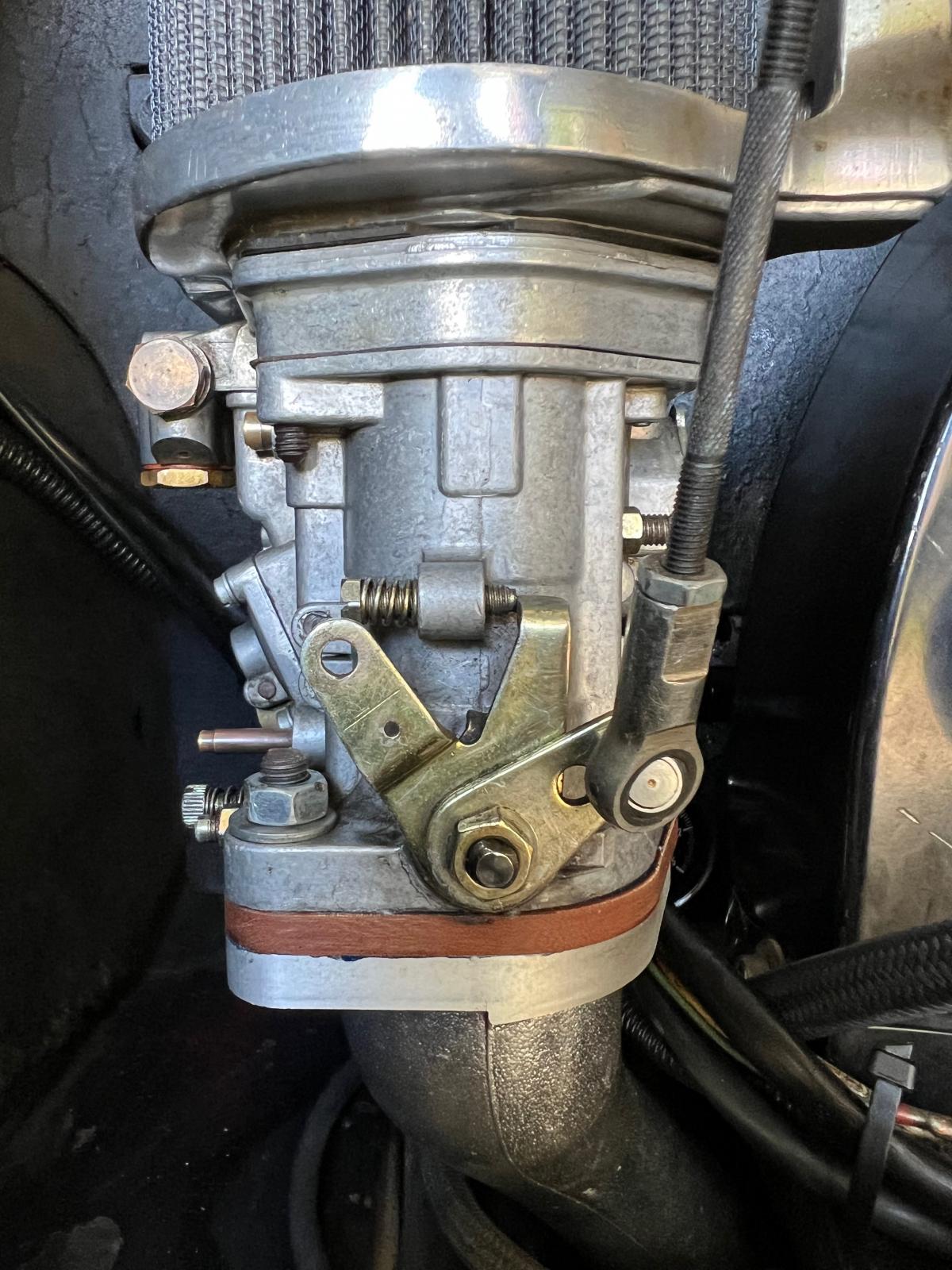

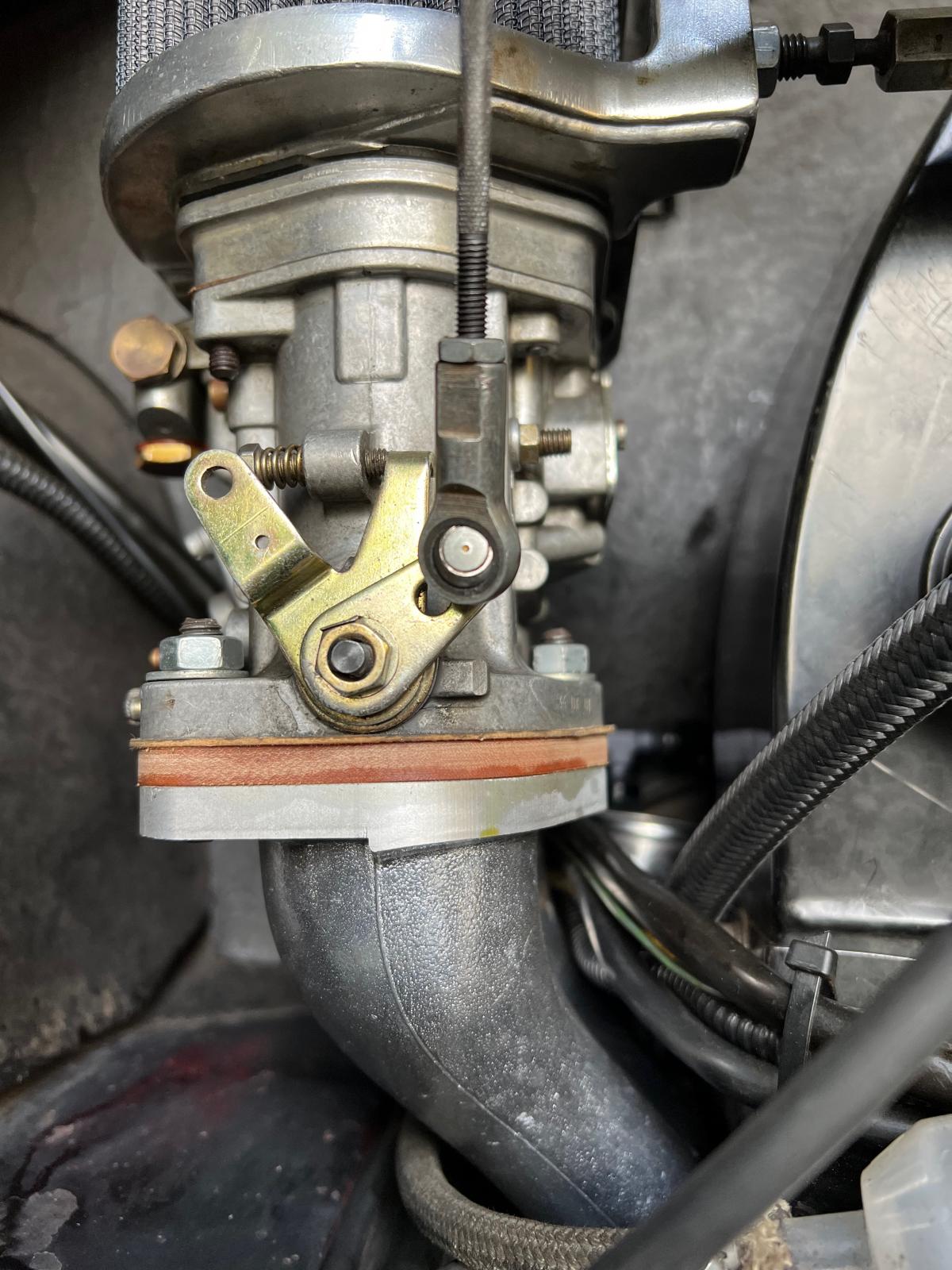

Intake Runners
The opening on the old intakes was verified to be almost 4mm too large - meant originally for a 48mm bore.
The other head scratcher I encountered was the gasket on cylinder #2 - it was completely deformed and reduced the intake volume by almost 15%. Never mind the turbulence to get around the blockage ...
After coming up to temperature, I noticed that the fuel in the bowls were being cooked (evaporated petrol) when the engine was shut off. To forestall the heat soak, I ordered up a set of 1/4" 'phenolic insulating' spacers to manage the exhaust ports as the engine cools. I left the old paper gaskets in place to monitor the fitting, but assume they can probably be removed in the future.
After the new KIPA 44mm intake runners and fresh metal gaskets were installed, it took some fine tuning to get the linkage geometry squared away. The idle jets were dropped in size from 60 to 55, and fresh rubber gaskets fitted. Cylinder #4 came to life - it seems there was a kink in the rubber gasket as the idle jet was screwed in, resulting in a oversaturated non-firing cylinder. This was verified by testing the temperature on the intake - it was previously running much cooler than all the other cylinders. Once everything was tuned, I noticed the oil temperature jumped from 180 up to 200 degrees ... this might be the time to justify an upgraded 1 5/8" exhaust, as @Rome has suggested many times in the past.

Where did you get the spacers from?
The kind I’m using are too squishy.
No matter what I try, the carb base nuts and/or studs become loose.

@jeffrey8164, I know exactly what you mean about questioning the rigidity of the spacers and the seal against the metal mating surfaces.
The current versions were purchased on EBAY from user "ecdezz". You can also try search for "phenolic insulating spacer" along with your carburetor type for further qualification. The material is very solid, and fit is tight - I am monitoring for any leakage at the seams but everything is OK so far ...

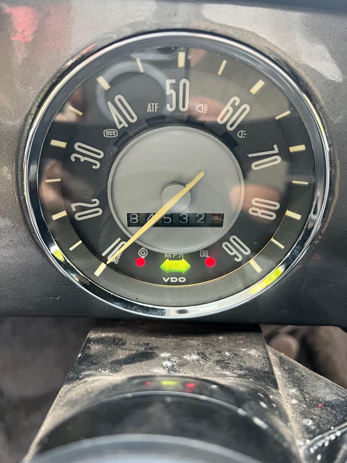

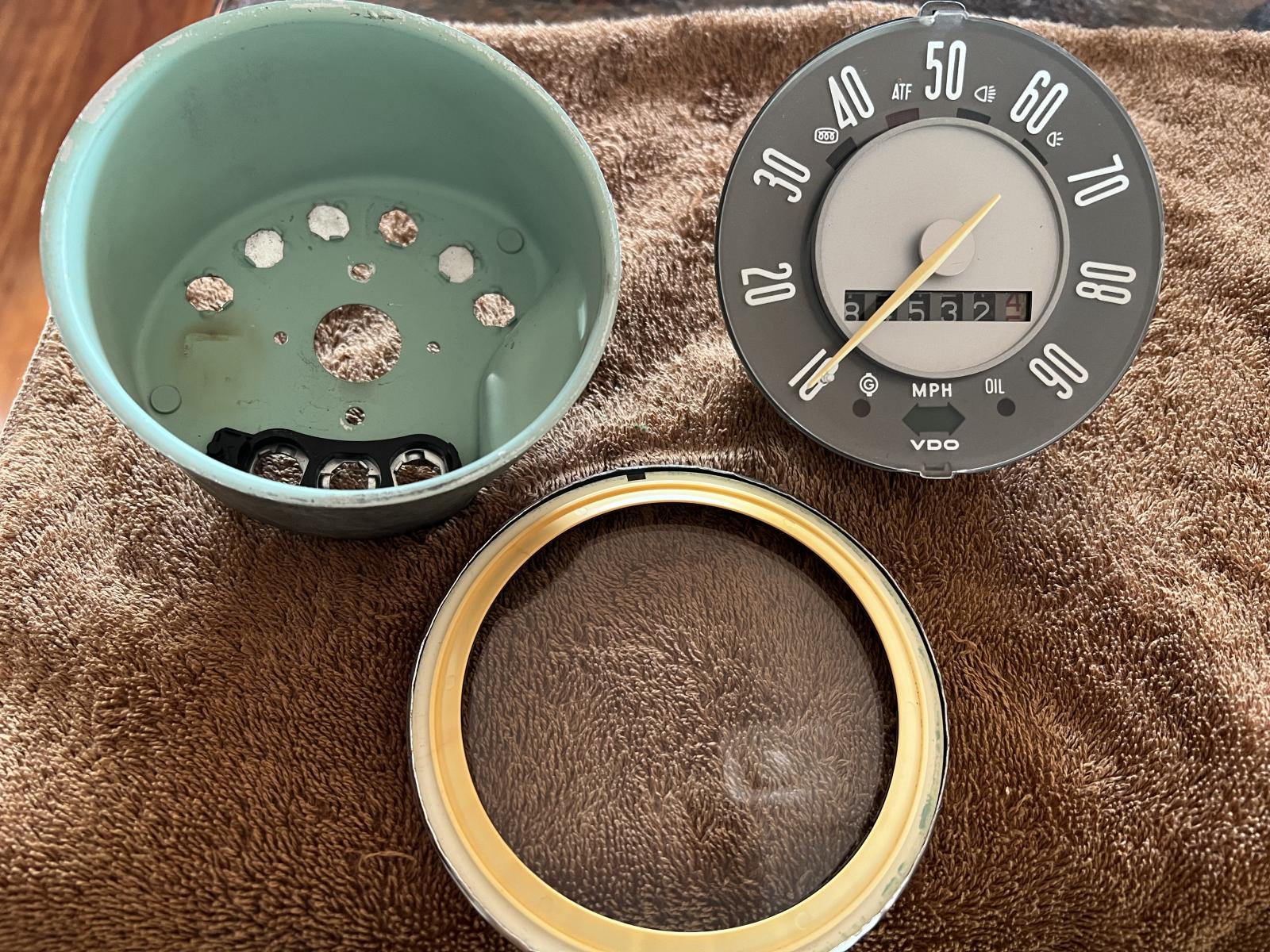

Speedometer Refresh
When I originally purchased the Ghia, most of the chrome bezels around the instrument panel were pitted, the glass would often fog up on cold mornings, and just look a bit dingy with scratches on the inside surface.
Over time, I've monitored EBAY and managed to pick up a speedometer for cheap, since it was originally designated as "broken, for parts only". I pulled the nice chrome bezels (gently prying with a taped-off flathead screwdriver), and cleaned up the glass on the inside with a microfiber towel. Made sure to line up the tick marks on the outside with the numbers, then bent the bezel back into shape.
I also pulled out the worn-out, faded warning indicator plastic and turn signal indicators from the housing by twisting the corner tabs holding the dial face in place a bit and lifting the instrument panel to get at the metal cavity beneath. These were also transferred over to the rebuilt speedometer.
'69 Ghia

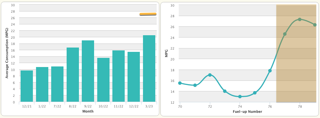

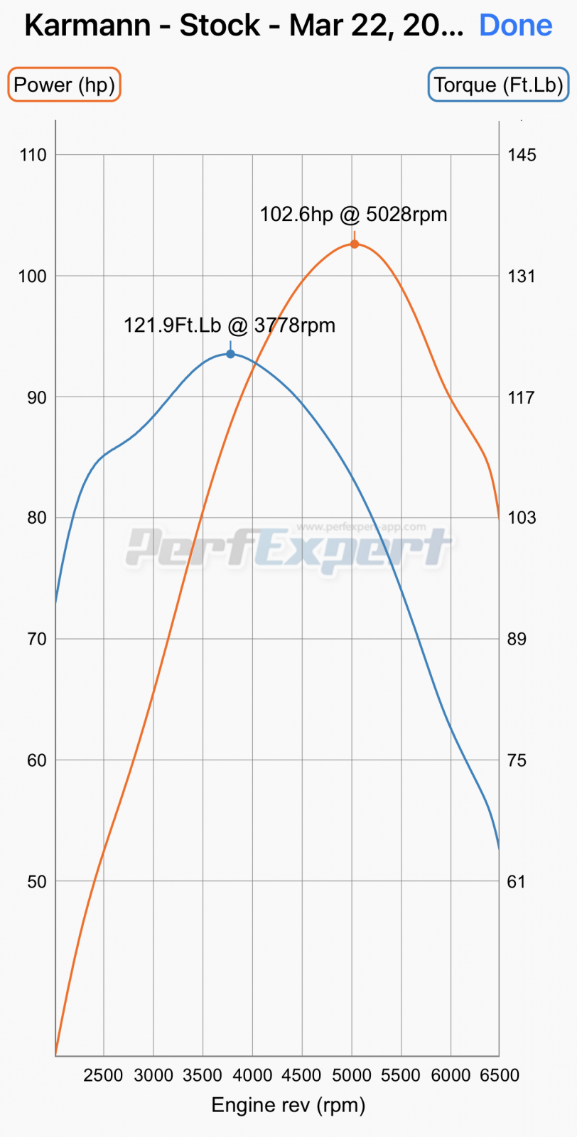

Carburetor Tuning Results
Since August of last year, considerable time has been spent on the dual Weber 44 carburetors. Fuel delivery is directly responsible for miles per gallon (MPG) efficiency for any given engine configuration. Once the fuel hose splits past the pump, every effort was focused keeping the carburetors perfectly balanced in order to avoid stumbles, hesitations, and performance degradations. I highlighted in the the last 3 fuel-ups with economy jumping up to 27 MPG. This is a direct result of the work on the 44mm intake runners and resized idle jets. encouraging ...
For the first time in months, took the car out for a series of dyno runs with consistent results. As expected, there is no net gain in maximum torque or horse power but the curve has shifted upwards in the lower RPM range - usable power for everyday driving.

Phenolic Gaskets
After monitoring the newly installed phenolic spacers, it seems there was always a bit of fuel weeping at the sealing surface to the intake runners. I tried to order some Hylomar Blue, but the shipment was taking forever to arrive. A trip down to the local Autozone gave me two alternatives - I chose the orange 'direct replacement' from Permatex.
The old paper gaskets were also thrown away, a thin coating applied to both sides of the spacers with a paint roller, and the goopy mess was pressed back into place. I let the material settle overnight, and re-torqued the anchor bolts in the morning. It is possible to clean up the non-hardening blue gasket material using 91% rubbing alcohol and rubbing briskly.

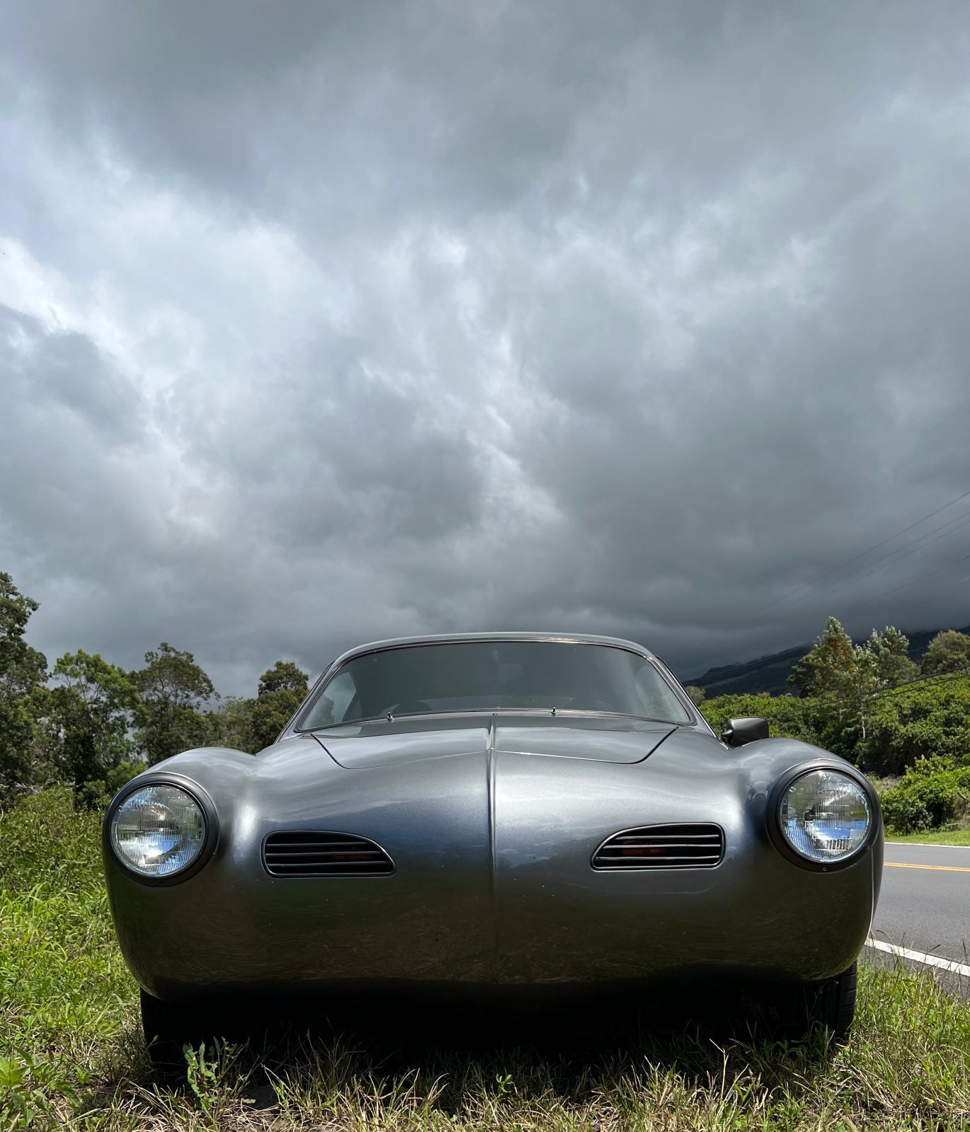

C&H sugar mill as backdrop. Last images before front running lights go on
