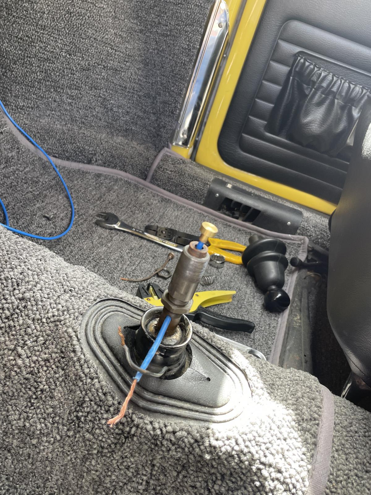

I did put a new blue wire in with the brass tip. The prior wire was cut and held together with a wire tie. The new wire I purchased is about 4 feet long but will not fit through the tiny hole the wire feeds through with a fixed female spade on the end. So I cut it like the person did that replaced it before, knowing it didn't come cut from factory. But where it is cut at the shifter one can touch that open wire to the body with key on to hear the click. That way I will know that there is not a cut in the wire from the shifter to the solenoid in between?
What you think ?

As indicated I already replaced with the blue wire and I’m going to test if the wire where it’s cut and connected and touch to the body for ground to make sure I’ don’t have a cut in the wire between the shifter and the solenoid. If that clicks now I’m in trouble because I have power to and ground and solenoid works but still doesn’t shift 🥲

PostPosted: Sun Mar 26, 2023 8:44 am    Post subject: Re: Auto Stick SOLENOID for 72 Super Beetle can`t find ? Reply with quote
[img]https://www.thesamba.com/vw/gallery/pix/2378920.jpg[/img
This VW has had everything removed. All rubbers replaced. Entire electricle replaced. Senergy green paint with mirror finish. Black and grey two toned mesh interior and head liner. Polished out Porche 911 wheels. Disk brakes. 1835cc with fresh barrels and Pistons, dual 44m weber carbs. Auto craft roller rockers with dual springs. Stainless valves with ported cylinders. RC trans with strap and mendeola support. A1 stainless exhaust. MSD ignition. Let me know if you have any questions....

PostPosted: Sun Mar 26, 2023 8:47 am    Post subject: Re: Auto Stick SOLENOID for 72 Super Beetle can`t find ? Reply with quote
Not shur if an adjustment is needed at the shifter so it is grounding properly ?

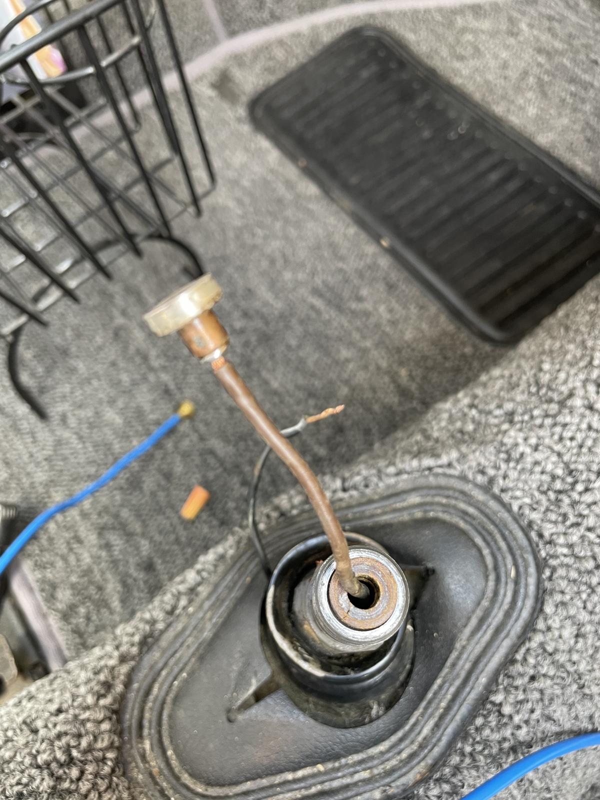

I'm not sure why you cut your new blue wire. That wire is supposed to go under the carpet and then connect to the brown wire under the rear seat.

Is it possible not to cut the wire and feed through the tiny 1/8 inch opening to go through with a female spade on the other end ? Thats how it was before I just copied it. There was a Black wire present already leading back so I just tied into it like the prior person did when they fixed it ?

Sure that should work assuming the black wire is connected to the brown wire coming from the solenoid. I do remember now having to cut the spade connector off that blue wire to fish it through. I just reattached a new spade connector to the end of that blue wire.

By the way I didn't find Bentley too helpful with the adjustment (tighten then back it off one half turn). Instead I adjusted that shift contact with the engine idling and the rear wheels off the ground (on jack stands). I would adjust and then shift and then adjust and then shift, repeat, repeat, repeat until I was happy. I have no idea his many turns it was. If the shifter is too high then the clutch will not disengage (grind). If the shifter is too low then the clutch doesn't re engage (wheels don't turn when in gear).
