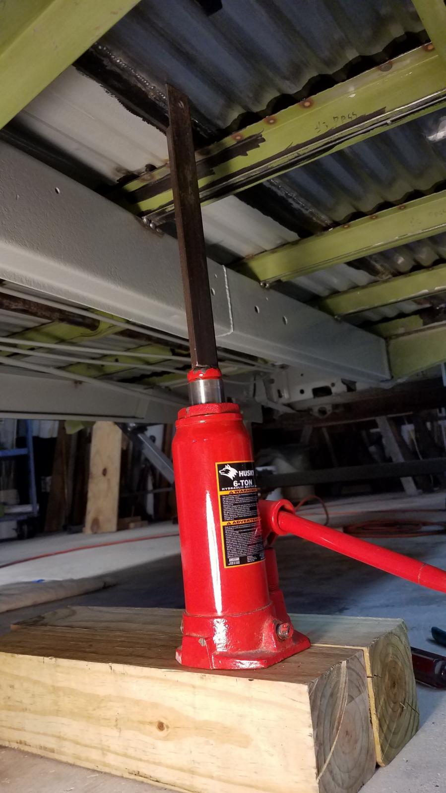

Used a jack to adjust the height of the floor at the butt weld.
Weld penetration was questionable at certain sections in the butt weld. Filled in some obvious holes by Mig welding on the back side. Also used the Tig gun without filler rod to smooth and connect the interruptions created by the individual Mig welds.

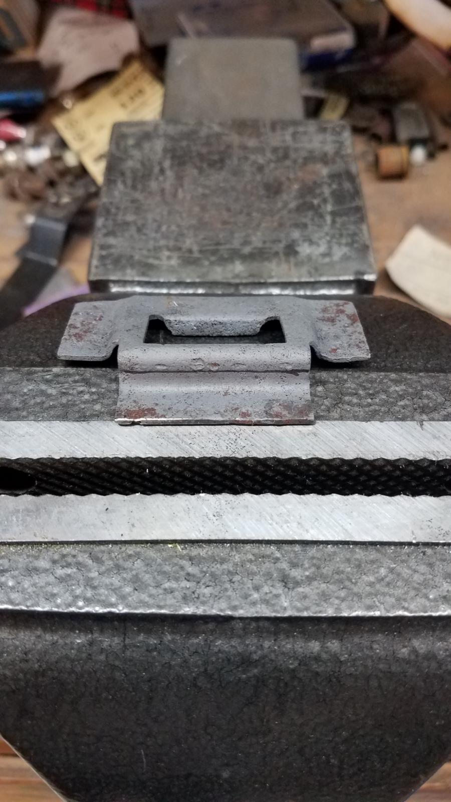

Harvested the treasure chest door catch from the original floor. Profile of the treasure chest floor and top part of the long rocker channel that houses the rubber seal (90-degree bend).
Sandblasted the piece but had to change its profile for it to fit.
Welded in place.

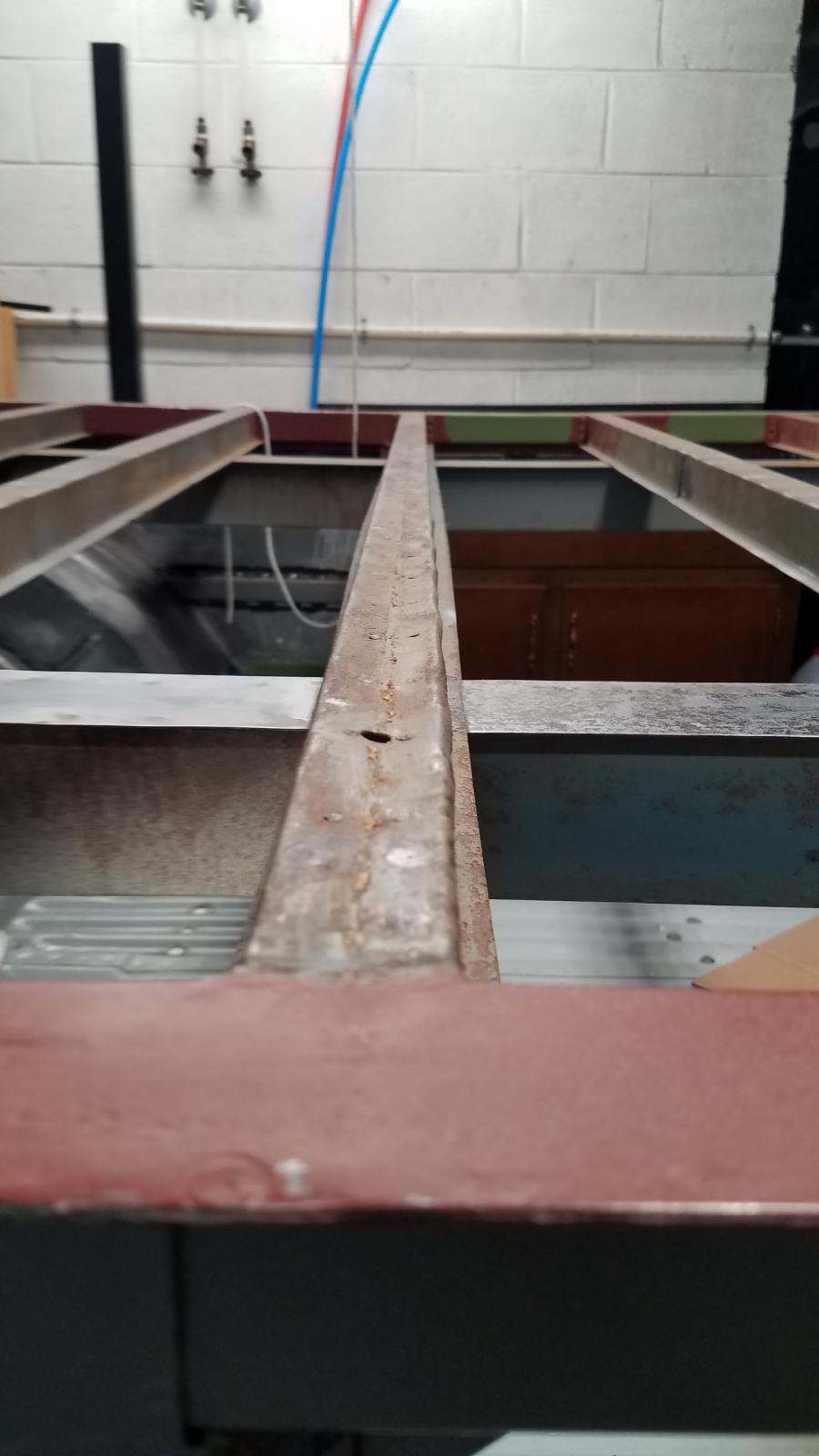

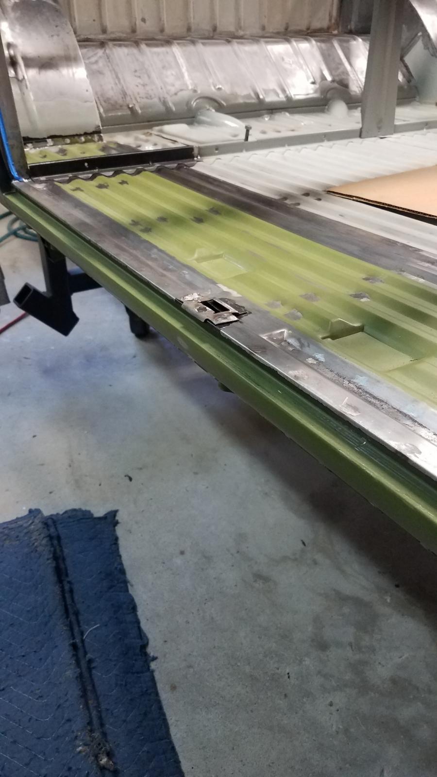

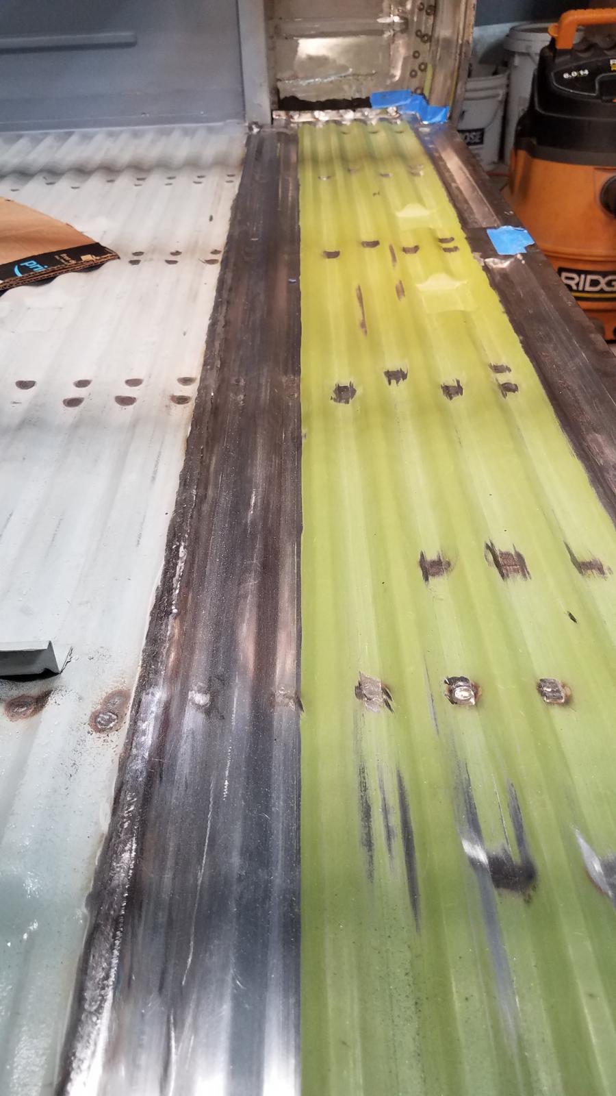

After finishing the treasure chest area, I wanted something less complicated to do. The load bed top hat that joins the front and rear panels of the load bed was really beat up. Getting the new load bed panels to mate up flush and straight across that top hat would be a challenge.
Unfortunately, I picked the only load bed top hat with 75 spot welds to free up. The load bed edges were riveted to that top hat. The rivet's locations were spaced equally from front to back and side to side. Didn't know if this was done at the factory or because the edges started to peel up after years of abuse/beating. Spot welds were also present but some failed.

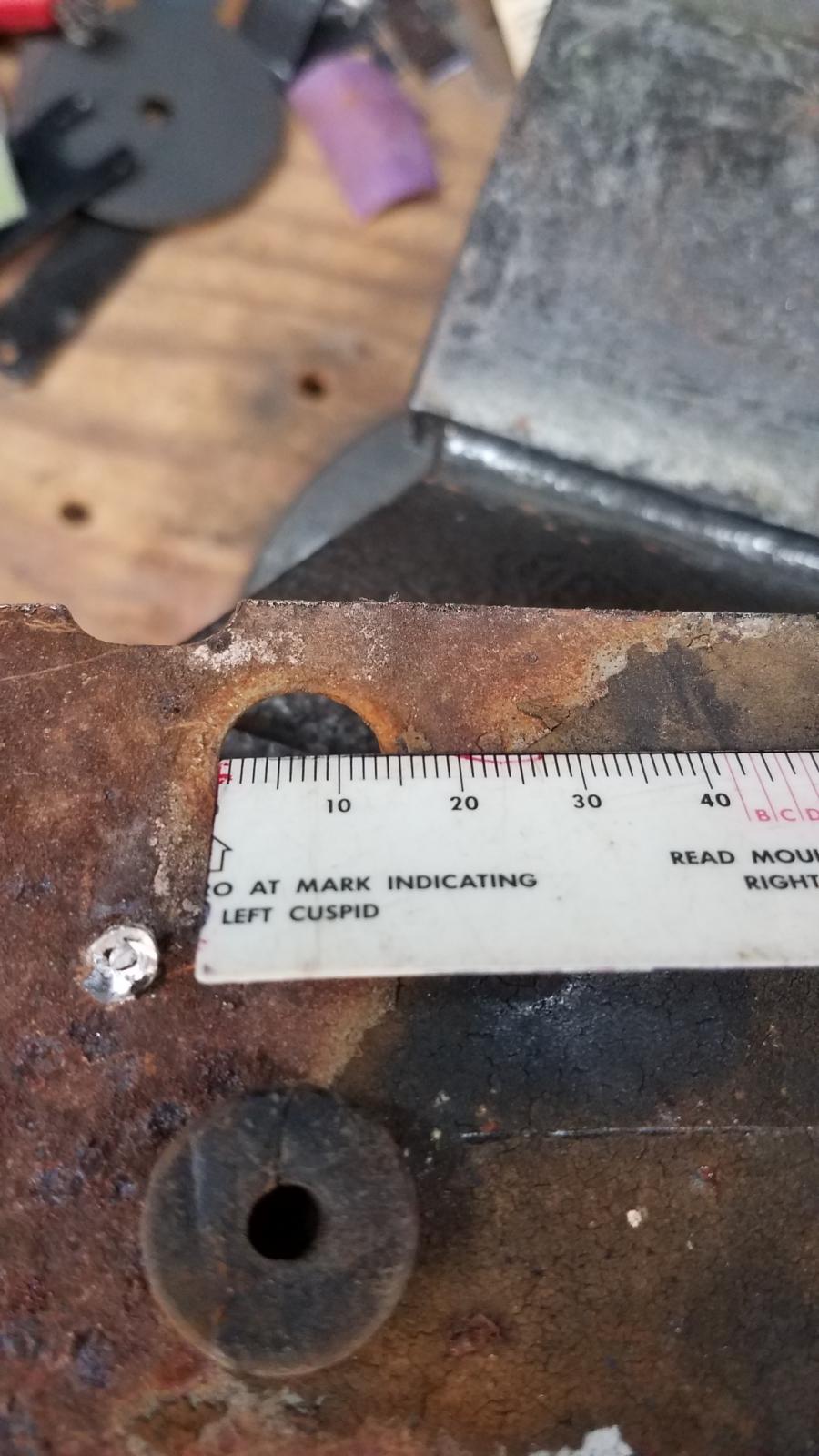

Picture of 50+ years of beating.
Spacing of rivets. Anybody know if the rivets are factory or local install?
Some of the spot welds that helped support that load bed top hat failed. Replaced those with some plug welds and cleaned up the original mating surfaces.
Got the new top hat from Gerson. Just needed minor flange adjustments where they weld to the hinge carrier panel. Punched all the holes in the new top hat and coated the chambers before welding. New top hat will be a definite upgrade when fitting the new load bed panels.
All welded in. Decided not to grind the welds flat (no one will ever see them except the mice 50 years from now).
Speaking of load bed panels, I ordered the 4 panels along with the top hat. I heard that shipping costs were going to get even more ridiculous than they already were. ("Supply chain problems"). When the load bed panels arrived, the outside cardboard didn't look good. All the panels were damaged some worse than others. Had to go through the pictures to the Gerson representative thing and the reorder time involved. I deleted most of the pictures because I took way too many. but saved the best. The two worst ones were the rear driver's side and the one that was stacked next to it, the passenger front corner.
When they sent the replacements they were damaged too. Not as bad as the original four, but damaged. They gave me 100$ off for my trouble to straighten them. They only had just one 3'x3' piece of cardboard between the four panels in the first batch. One piece in the whole box and nothing extra around the edges. Not much more in the second batch. (End of rant)

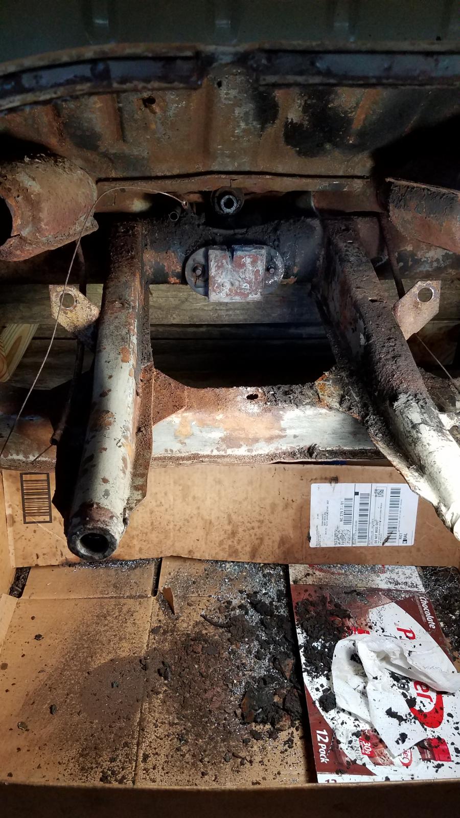

Next is the chassis crossbraces front and rear and the long heater pipe that runs through them. The original Y heater pipe was in good shape from the engine to the rear chassis crossbrace. The original long pipe was toast.
Started fitting the rear crossbrace and all of the channels for the accelerator cable, clutch cable and heater box cables fit very well. The hole for the new long heater pipe was too small and didn't match up vertically or horizontally with the Y pipe. Didn't expect it to. Just too many variables.
First had to make the end of the new long pipe fit inside the hole at the end of the original Y pipe. Gerson pipe was made so that it had a large lump in the pipe where they connect the ends lengthwise. Cut the lump off and butt welded a length of the end so that they could slide smoothly inside each other. During this process of wrestling with a 6-foot metal pipe I decided to stabilize the front of the pipe by fitting the front chassis crossbrace Idea. The front replacement part did not have a slot for the clutch tube and the hole for the brake line was wrong compared to the original that I saved. Fixed those things and made the shapes and locations of the other two channels match the original.
Closed up the 1/2 circles should be rectangles.
Plugged the old holes and drilled new holes for the brake line. (It was larger than the Gerson hole in case your rubber grommet is hard to get in)
With all that done I could fit the long pipe in the front crossbrace. Would worry about fitting the 2 sections of the rest of the piping system later since there seemed to be some amount of flexibility in their location. The rear original Y section did not move a millimeter.
Back to the rear chassis crossbrace. Filled the holes where the end of the Y section was leaving a gap. Scribed the outline of the pipe on both sides leaving it smaller than needed. Gradually enlarged the holes using a straight edge on the inside of the new long pipe to guide my grinding. Finally ended up with 2 holes that let the long pipe go through the crossbrace and slide into the end of the Y pipe. Yeah!

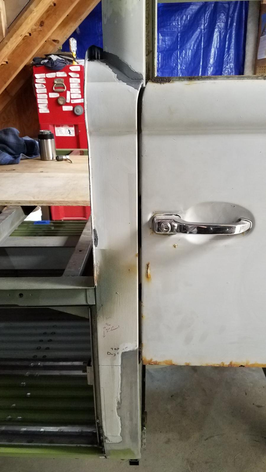

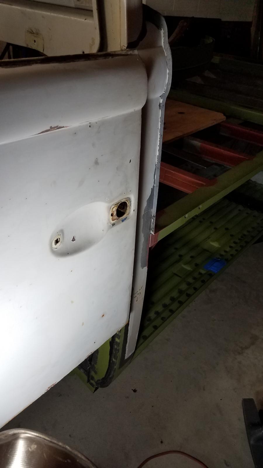

After the windshield repairs turning my attention to the front doors, A-pillars, dog legs, front floor and front nose. The doors and surrounding structures had a lot of issues.

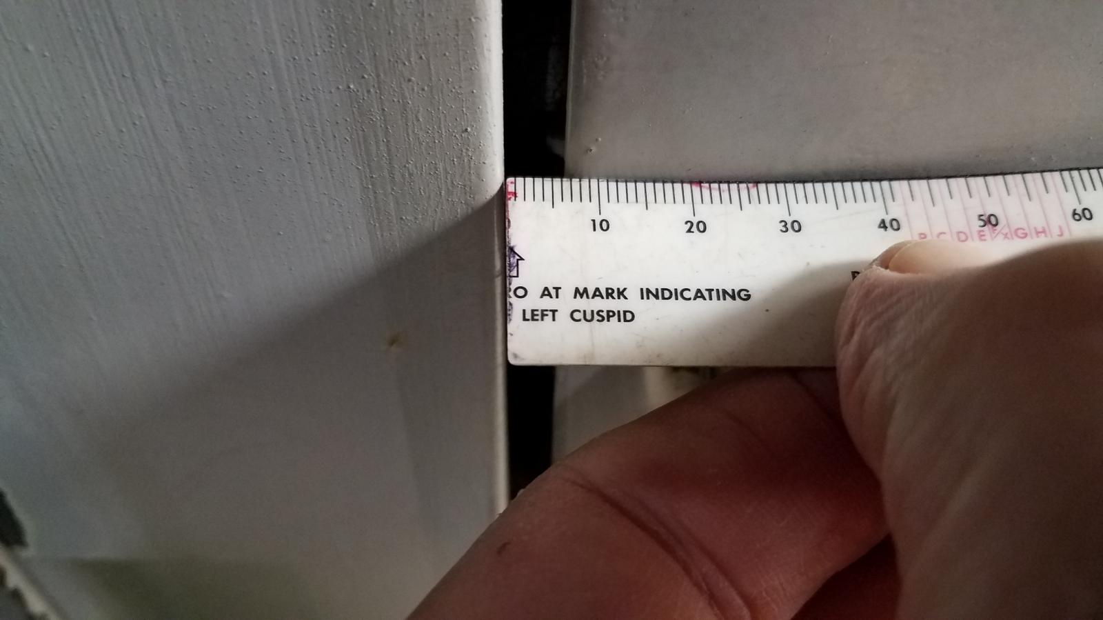

1. Hinges were loose and wobbly (50+ years of wear)
2. Driver door gaps were larger than passengers at the b-pillar
3. Both doors sagged screwing up the body line alignment
4. Bottom of A-pillar were very rusty with multiple holes
5. Door mechanisms were worn out
6. Cracks around the door sheet metal where the hinges are riveted to the door
7. bottom of the doors were rusty with holes
8. Multiple holes in the door skins from different mirror choices
9. Dog legs needed replacement
10. Inner and outer valences and lower nose skin needed new metal
Not sure if that is a complete list but I need to start checking off some of the things on the list. Decided to address the door and hinge issues first. Most of the build threads I've seen fit the dog leg to the door, not the door to the dog leg, so I wanted to finish those door issues first. Since there would be welding on the lower a-pillars the same logic would apply; fit and adjust the a-pillar to the finished door.

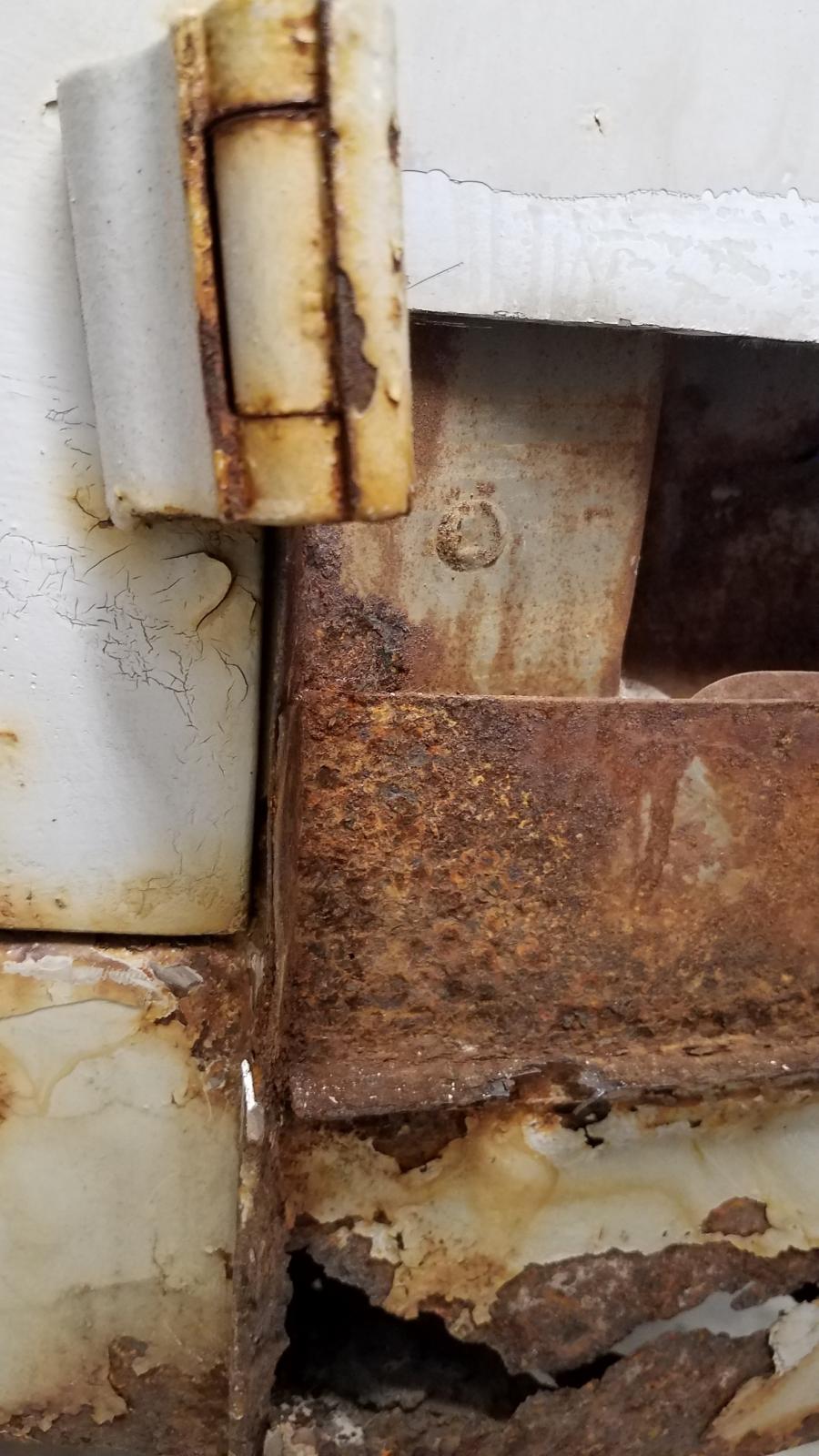

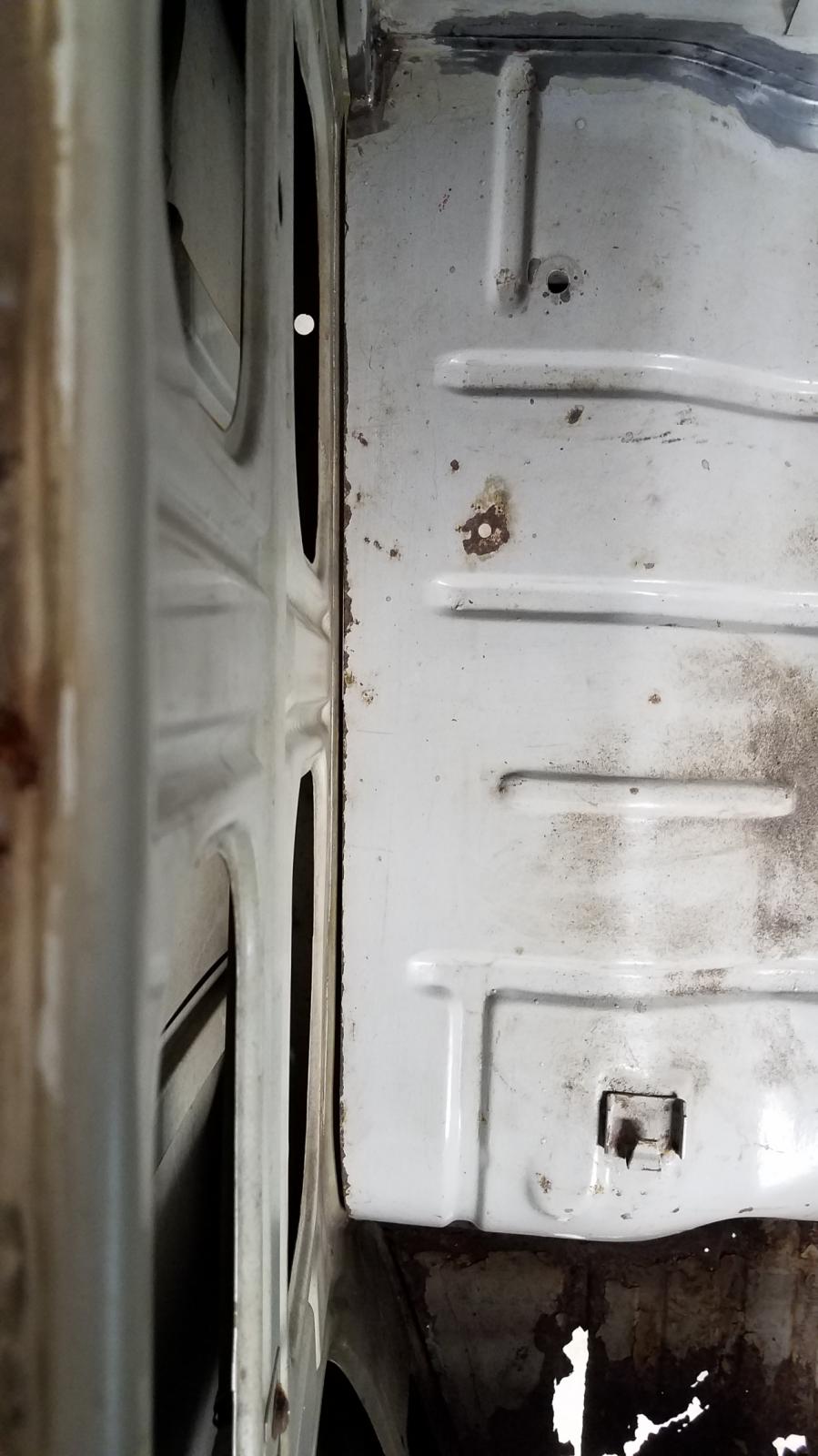

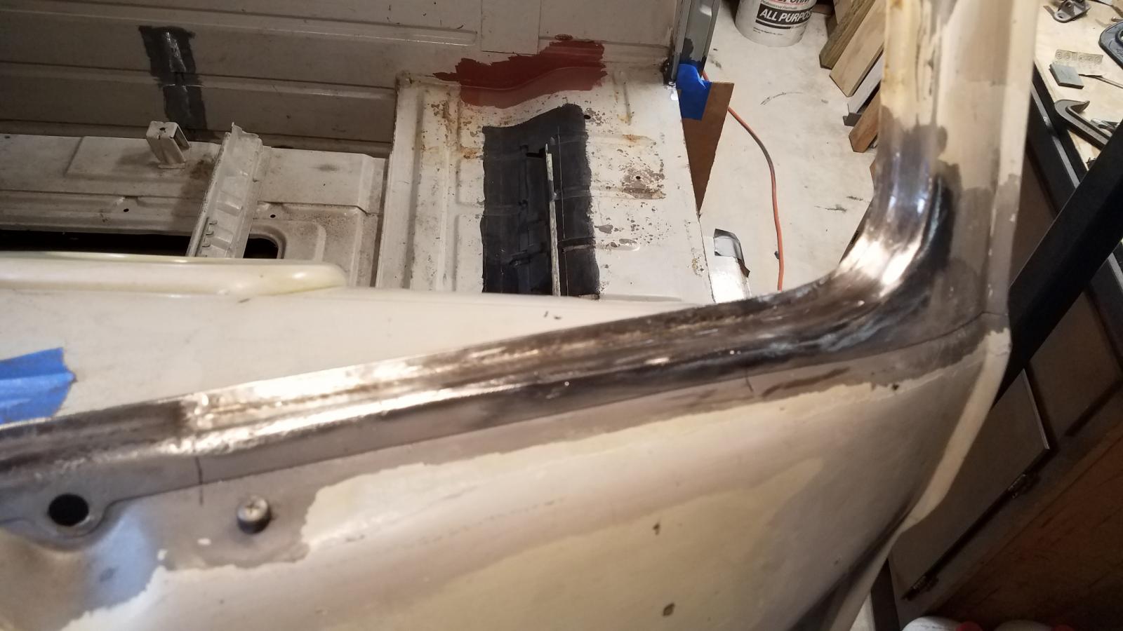

Couple of pictures at the beginning. Some of the damage in the front floor area. Sheet metal riveted repair with Bondo, fiberglass and resin poured over the existing rusty floor.
Rust underneath the front floor and some panels to help fix it.
Trying to get an idea of what the extent of the a-pillar damage is. Needed to peel off the lower 5" of the nose panel. Made a tool to help peel back the lower nose sheet metal.
After getting the crimped metal bent back, I could find the spot welds and free those up.

Needed a reference point on both doors to see if any changes that I make will have an effect on the door alignment. Passenger door was better than the drivers door. Passenger door was date stamped 6/64 and is an original door with the same paint as the rest of the bus. Drivers door date stamped 9/66. That door has the original color paint as the first coat inside and outside but has an exterior blue coat over that along with the brush painted gray over those two coats. I'm assuming it is not original to the bus.
Passenger door:
Even gaps at the b-pillar. Gaps measure 6mm (with paint). Slight body line sag.
Even gaps on the wheel well panel and the inside of the door.
Even gap at the corner below the bottom hinge.
Driver's door:
Wider gap ( 8.5mm) at the b-pillar and increases toward the bottom of the door. Body lines on the door drop significantly at the b-pillar.
Gaps in between the wheel well panel and the inside of the door increase and is widest at the point where the wheel well panel turns downward.
The bottom corner below the hinge touches the the a-pillar and rubs against the it.
The passenger door fit the best in the bus so I used that as the standard compared to the driver's side. The inside panel of the driver's door was distorted compared to the passenger door. Somehow the interior panel of the driver's door was bent toward the outer skin. In order to pull that out I made a jig that attached to the inner door panel and with a come-along pulled it toward the wheel well panel. Used the arm of the tipper cart as an anchor. After a lot of pulling and banging that gap was improved.
Another problem with the driver's door. The door wouldn't close all the way. The bottom hinge halves would contact. (Picture with arrows pointing to the contact areas of the door side of the hinge with the bus side of the hinge.)
when in contact this is how far the door would close.
Somehow, I need to change the alignment of that a-pillar bottom hinge area. There was a lot of rust in that area and I used a manual impact driver to break the hinge screws loose. (The kind you hit with a hammer.) So it could have been partially self inflicted. Time to put the thinking cap on. Decided to address the individual door issues which would give me some time to think.
Kb65single
Joined: July 24, 2019
Posts: 351
Location: Obxnc
Kb65single is offline
PostPosted: Fri May 19, 2023 8:22 am    Post subject: Re: Rusty 65 SC restoration Reply with quote
Removing hinge pins:
All four had a lot of free play/wobble in all directions. Hoping that with new pins I could eliminate that. Read a lot of stories about failed attempts at getting these pins out. Failures were most likely with doors still attached to the bus and using poor quality tools designed for pin removal. There was a lot of success using impact drivers. I had one but didn't have a tip that was wide enough. Tried it out on some metal that I didn't care about. Found that you can do a lot of damage with that tool, it's hard to control. Didn't want to mushroom the end of the pin or the hinge metal around it making the job even more difficult. Gave up on that idea with the narrow tip that I had and my lack of confidence using that tool in a tight space. Tip of my finger still has a numb spot on it from the saber saw incident.
My first attempt was a failure because I could not stabilize the door while holding a 1/4" wide drift in one hand and beating that with a hammer in the other hand. Had to stabilize the door with something better than my legs straddling the door.
Traced the outline of the top of the door on some old 2x10's in the back yard. Jig sawed that out and started building up layers to hold the door and most importantly holding the hinges upright level and perpendicular to the garage floor. It was crude but turned out very effective.
Supported the hinges on a large piece of metal on the concrete floor. Made a stack of metal pieces with a c-shape so that the top of the pin could escape. Used a lot of heat from a propane torch and a lot of quenches with W-D 40. After the last heat blast and a few blows with a 3lb. hammer, out they came.
Upper hinge supported with metal.
Lower hinge supported with a rear axle from an old rusty transaxle.
3lb. hammer with a 1/4" drift. 3lb. hammer made a big difference compared to a framing hammer, bigger target area and more force. Held the drift with vice grips, hitting my hand with that hammer was not an option Exclamation
Flopped the layers of wood over to make the support for the passenger door.
All four pins removed and sandblasted. Removed pins show no wear on the ends but significant wear in the middle. Glad to have that job done.
