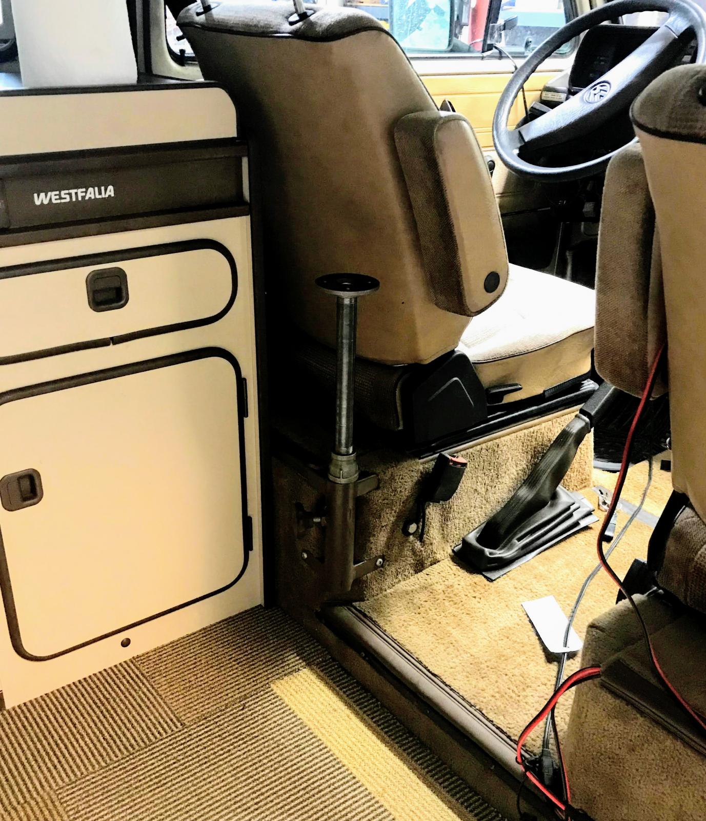

I have a Front Table Bracket I would like to attach behind the driver's seat on my 1986 Pop top with rear corner cabinet, fold down side table, rear-facing jump seat and a 12v fridge/cooler. my goal is to put in a step to upper bunk similar to this in the bracket.
Are there any obstructions that I need to be aware of when drilling holes or attaching with self-tapping screws. I know that the battery and associated wires are there. Will I need to remove battery before proceeding?

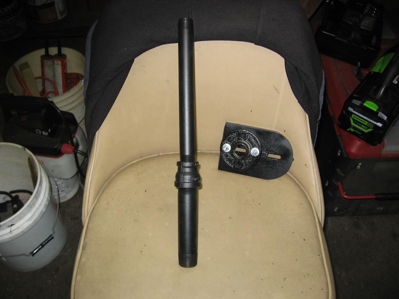

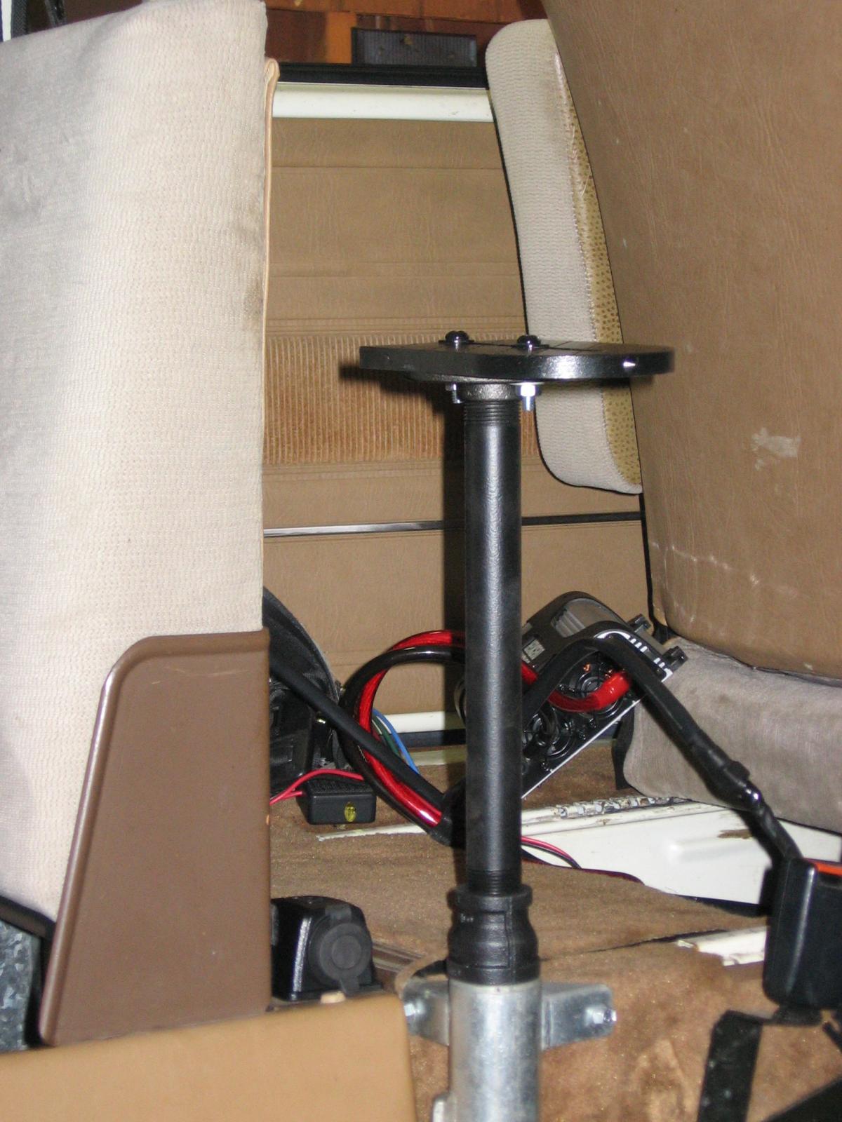

I completed the task of installing the bracket for a step-up to the upper bunk.
Using materials described in this link plus one addition.
https://www.thesamba.com/vw/forum/viewtopic.php?t=753437&highlight=top+top+step+up
Taking the side of caution, I slid the seat forward and opened the auxiliary battery box to ensure screws would not interfere with anything. Also, it was an opportunity to install a locking 12v outlet I had for the ARB fridge. If I were just installing the bracket, "kaalualu's" advise of carefully drilling a pilot hole or two, measuring thickness and purchasing appropriate sized SS self-tapping screws would have worked. I did have to remove the rear facing seat to put the screws in on one side of the bracket.
It was pretty much a straightforward install. The only problem I had was that I could not use the turn knob due to the close proximity of the rear facing seat. I will search for another type of fastener to secure the pipe and keep it from rotating.
Update06/03/2023:
Ordered a couple of M10-1.5 X 12mm, 14mm, 16mm and 20mm set screws to see which size would fit the best to replace the turn knob. Ordered from Bolt Depot as the local hardware joints only carried M4 and M5 ones. Bolt Depot was the only place online that I found that would allow a purchase of one or two instead of 25, 50-100 per bag full.
Any of the sizes would work, but I chose the 20mm as it stuck out enough to allow perspective as to inserting the shortened M5 Allen wrench to tighten.
Attached the Allen wrench to the pipe by wrapping a Velcro cable tie to it allowing access for future use and hope it will not disappear.
