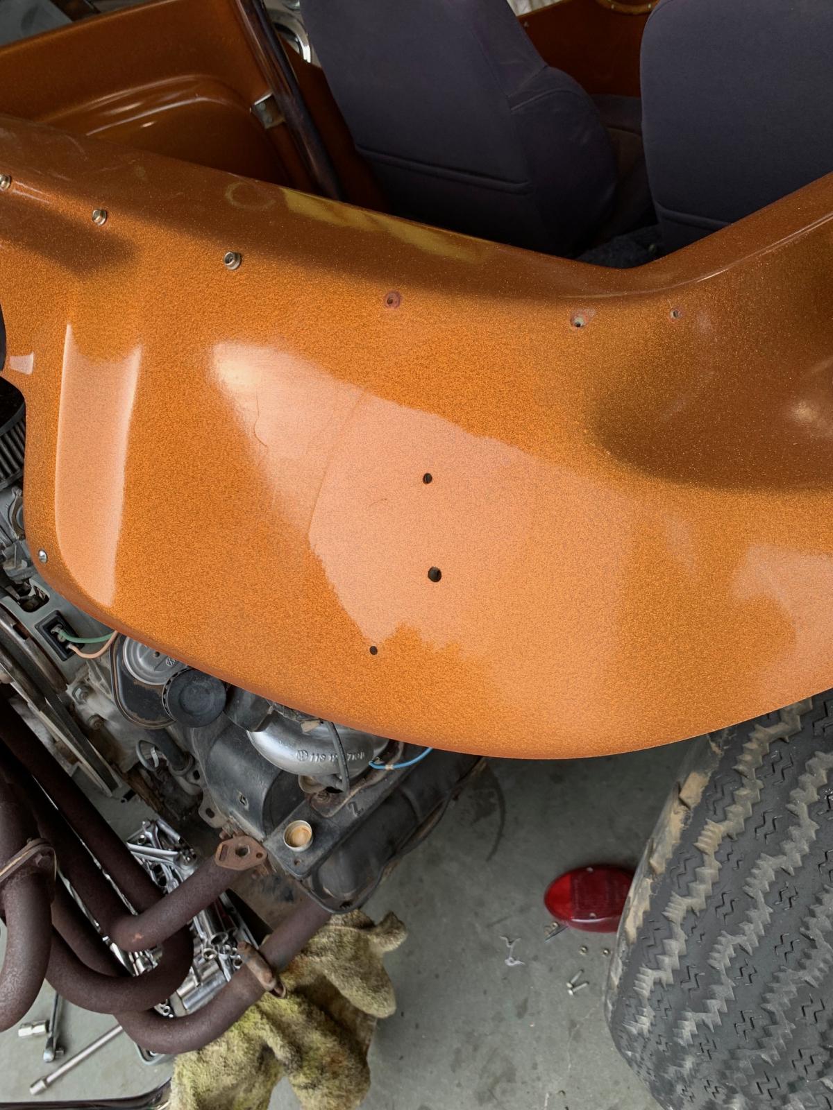

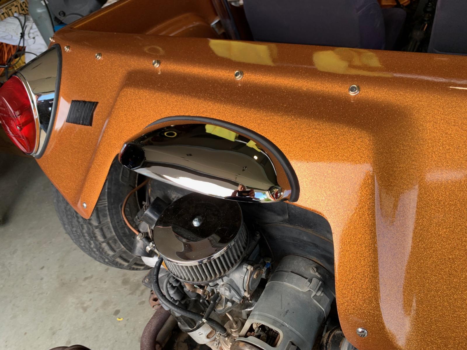

Spent a little time polishing the back fiberglass and it's looking pretty nice. There was a raised impression of a few decals on the back.
It's difficult to see but just barely visible in the light reflection is the image of Tweety Bird's head. The other side had me baffled until I figured out it was Sylvester the cat. There is another square visible but no telling what that could have been.
I did a search and found the exact decals that are from 1969. Same measurements and shapes. I was lucky and found a set for sale.....I may or may not put them back on the buggy.

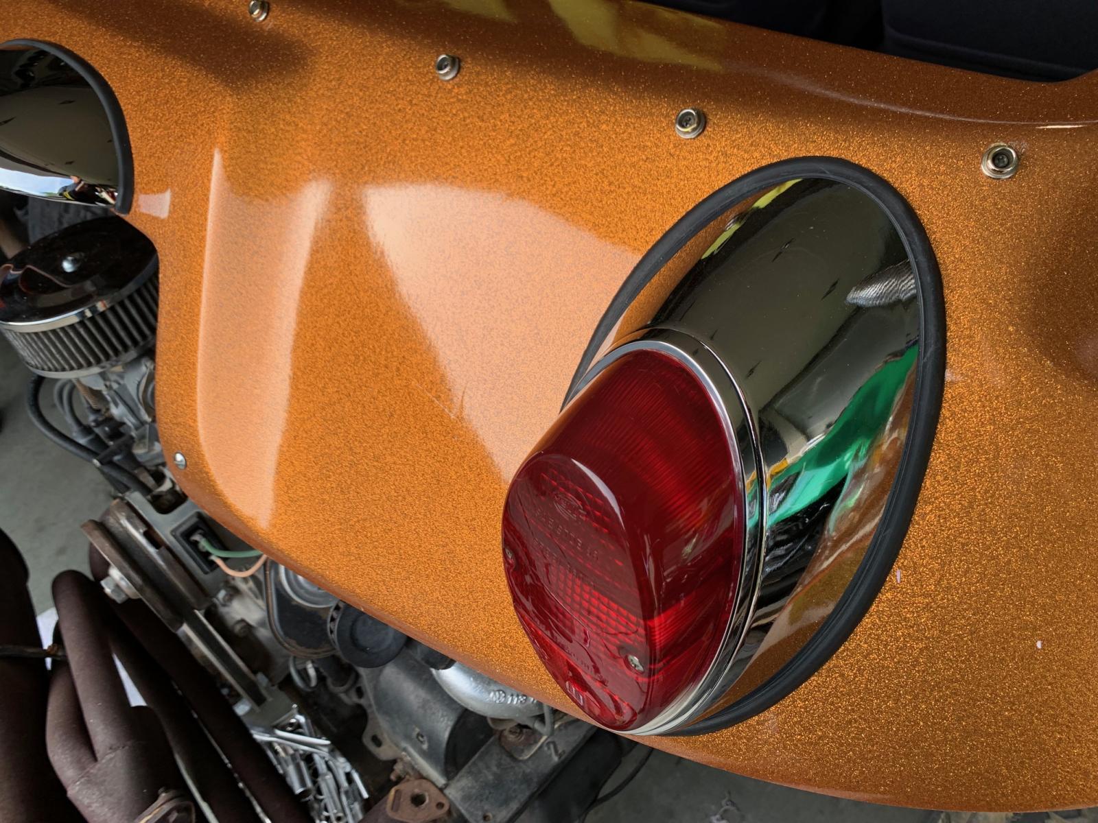

I also changed out the rear turn signal lights and license plate light housing.
Here is the before
And now the after. I found a set of light housings at a swap meet that were already chromed and have a little patina. I'll get the originals rechromed.
No chrome on this so it got replaced. I also removed and polished the convertible top snaps.

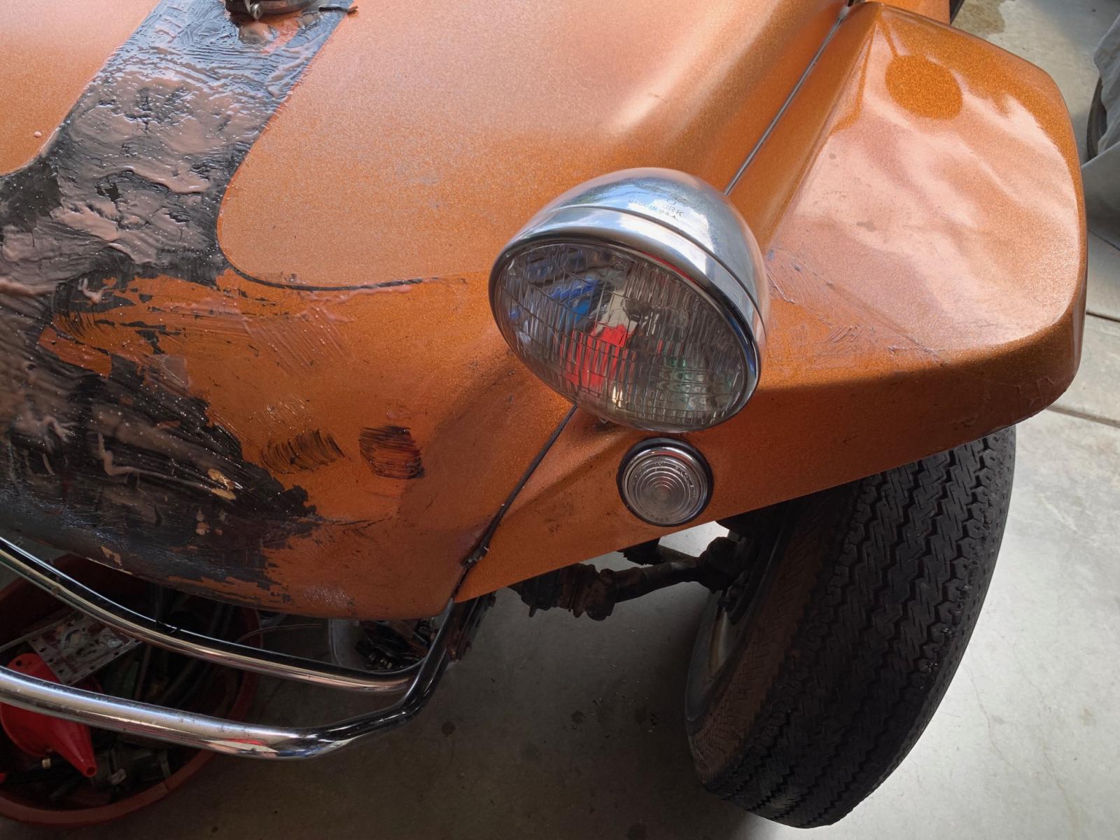

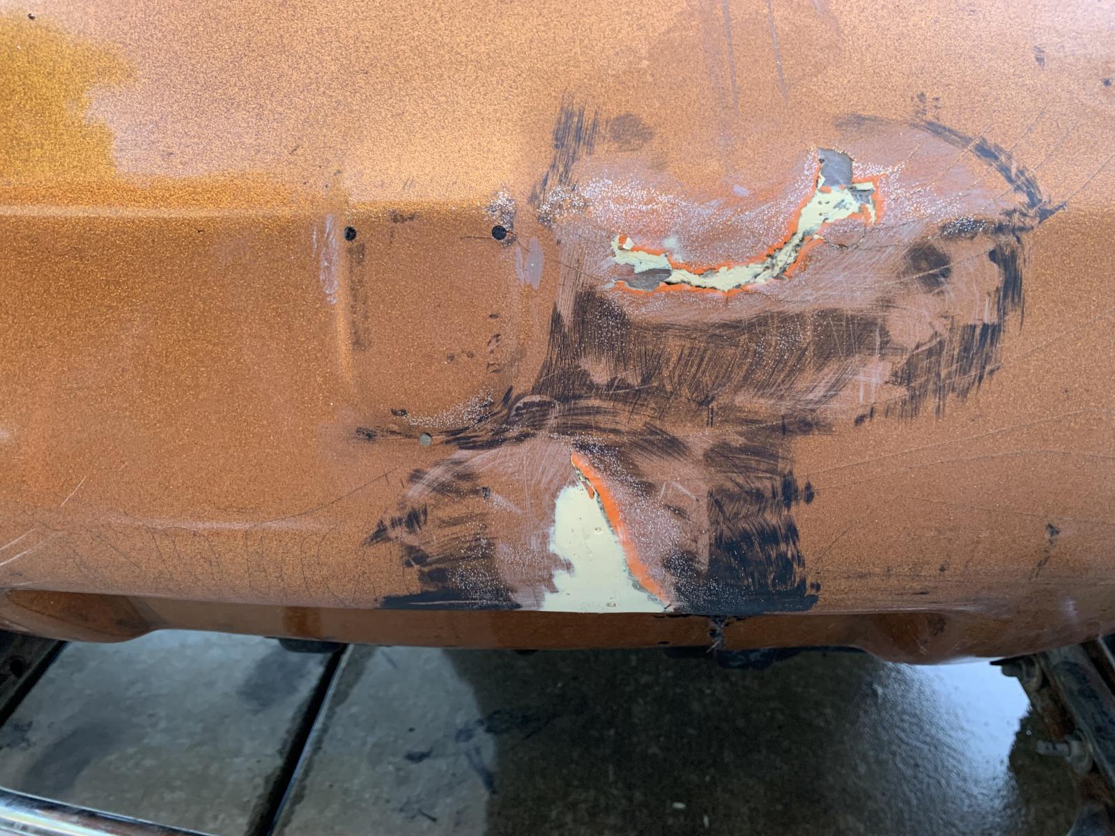

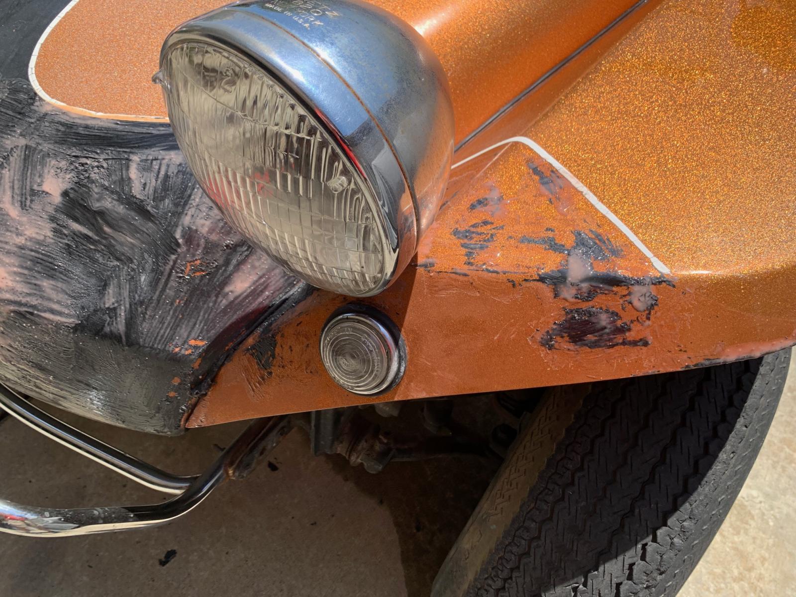

Started taking off the black paint on the front end. The damage doesn't look to bad. The gelcoat is pretty rough where there was no paint protecting it. Not sure if I'll be able to polish that out.

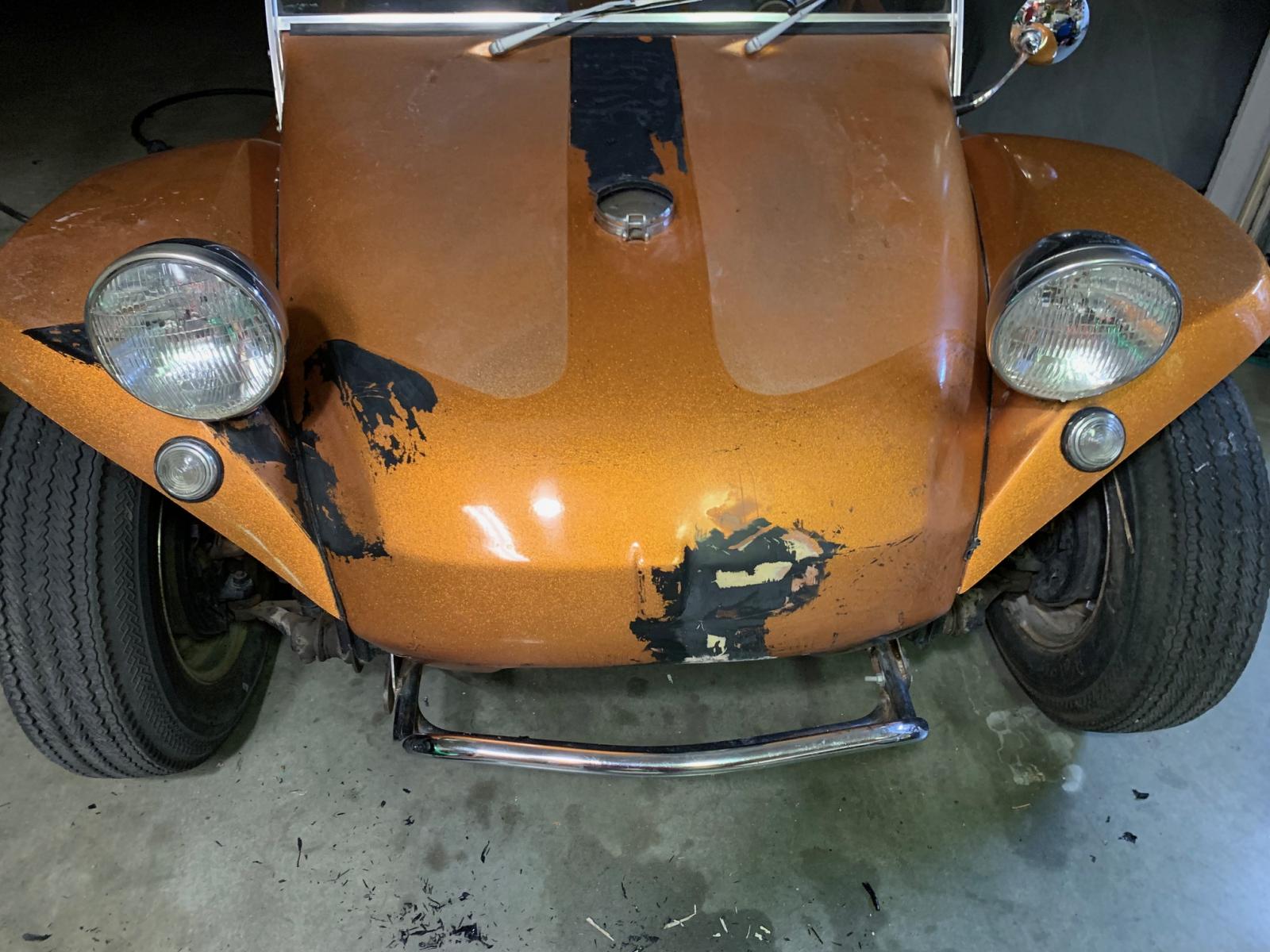

The hood is fixed as well as it can be for now. The gelcoat was toast in the areas that weren't covered by the black paint. I removed all the bondo and exposed the damage underneath so it could get a temporary fix. I should point out that I got a lot of help from Miguel Diaz on the repair. I removed the paint and he did the repair and clear coat of the hood.
I used Citristrip to remove the black paint. Covered it with Seran wrap to keep it from evaporating. Doing it in the sun seems to speed up the process.
The lower area will have to wait for the final repair when the hood comes off the car. For now I'll cover it with a license plate.

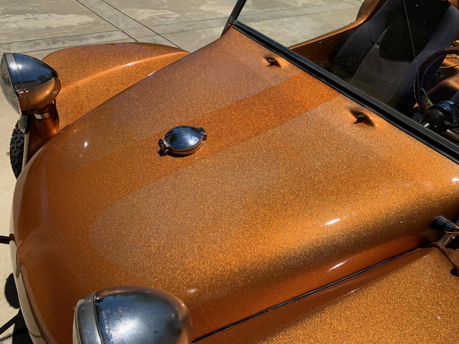

The old 7E Brilliant Golden Orange is nothing like the newer 7P Brilliant Golden Orange that Meadowbrook and Meyers Manx use today. That's a bag of the new 7P. We couldn't use that and had to go with with some gold flake as a temporary fix.
This is the newer 7P flake that has a lot more orange than gold
I'm looking for an original Manx emblem for the front....the kind with the 3 plastic studs.
I'll let it dry a few days and then will wet sand and polish.

Miguel Diaz spent a lot of time matching the color on the hood. He took it to numerous paint match experts that eventually all told him don't come back if it doesn't match. He had to experiment with different base coats and spent a ton of time but finally got it as close to perfect as possible.
This is what we started with.
A night and day difference from before.
