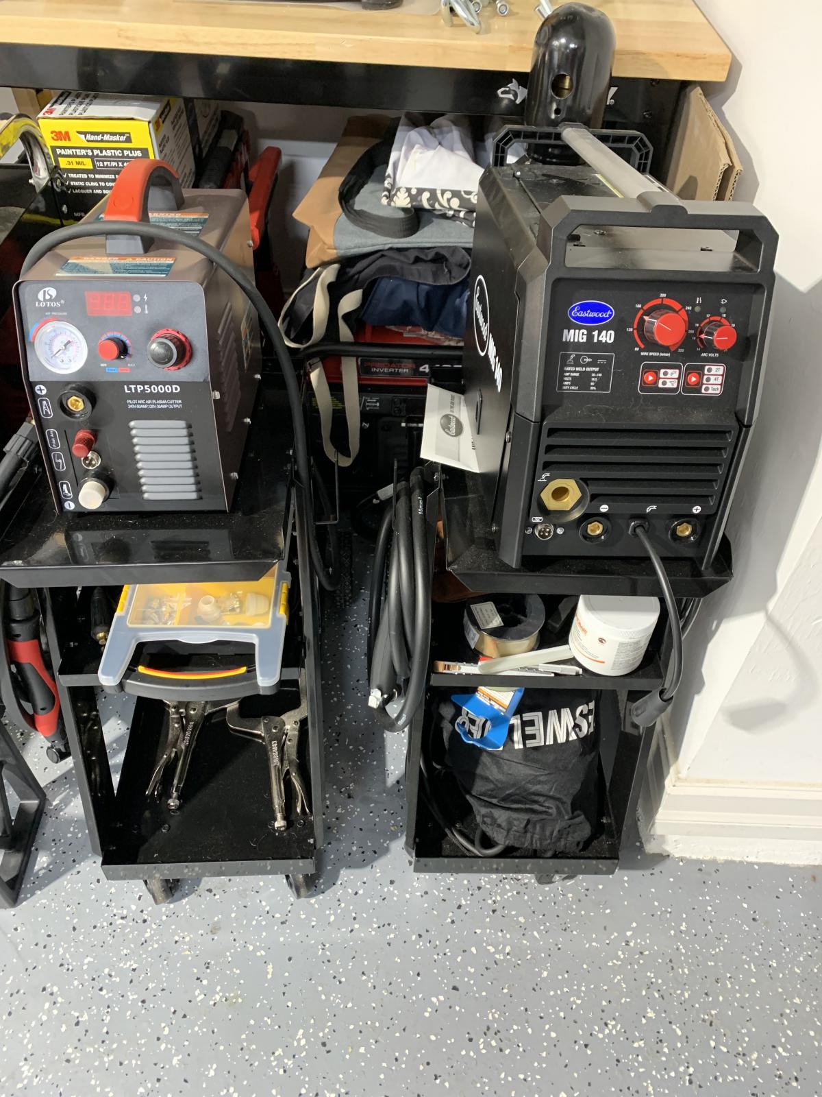

My "handy me down" 30+ year old Lincoln welder finally sh*t the bed. Since I rarely weld anything thicker than 3/16" and am a mere hobbyist at it, I selected Eastwood's MIG 140 (120v - inverter technology) which replaced its 135 series system. I had the dedicated 20 amp line already so it was plug and play for me.
Not too shabby for a value / affordable MIG. Plus, I liked the 3-year warranty which beat a few other systems I considered.
If you're a hobbyist at it and don't want to break the bank welding the VW - Eastwood's 140 might be a good pick.
I'm another Eastwood user, they make a robust and well designed welder. Around 2010 when I was welder shopping for the first time, one simply could not buy a mig welder with infinite controls on both wire speed and power for what, less than a grand? I finally decided on the MIG 135. After using it for about ten years, I recently replaced it with their 200 amp multi process welder and upgraded my bottle from an 80cf to 125cf. It comes with a 240v adapter plug so it's usable on a regular 120v receptacle.
I think the entry level gas-capable Eastwood welders will handle any hobby project like VWs, and beyond.
