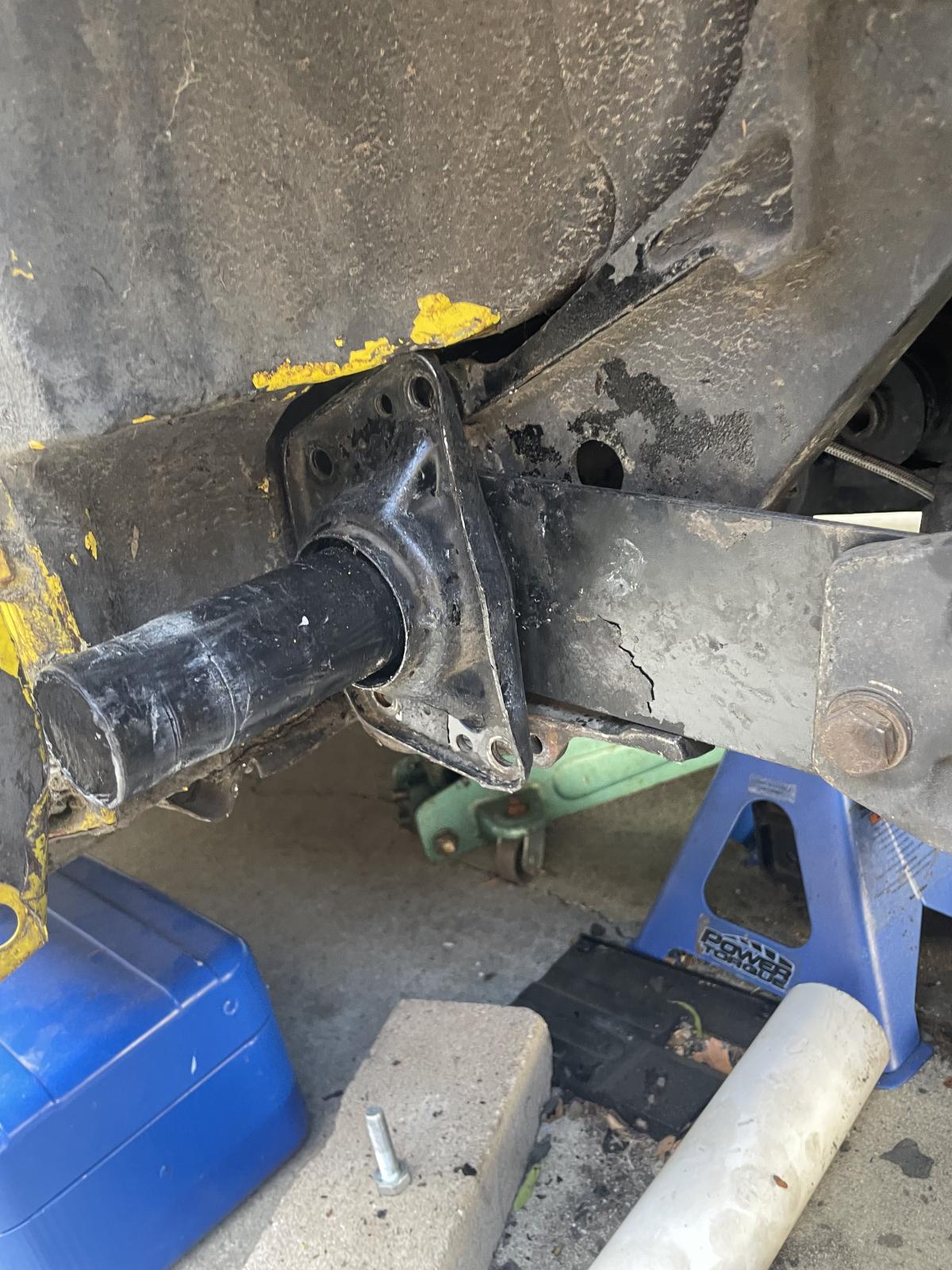

I'm in the process of getting my '74 back to stock, which means bringing it back up to stock ride height. I adjusted the swing axel, but now I cant get the spring plate back on and lined up. Any tips/advice?

PostPosted: Sun Nov 26, 2023 4:21 pm    Post subject: Re: Spring Plate Won't Line Up? Reply with quote
I used longer bolts to 'pull' the bushing holder in till the regular bolts would reach

PostPosted: Sun Nov 26, 2023 4:27 pm    Post subject: Re: Spring Plate Won't Line Up? Reply with quote
X2 This is the way I install "spring plate" torsion covers.

PostPosted: Sun Nov 26, 2023 5:06 pm    Post subject: Re: Spring Plate Won't Line Up? Reply with quote
Alright I'll give it a shot then, I've already tried that with some "longer" (~2.5") bolts but it's worth another shot with something even longer. Thanks gents.

PostPosted: Sun Nov 26, 2023 6:30 pm    Post subject: Re: Spring Plate Won't Line Up? Reply with quote
If the rubber is dry, it may be fighting you. Spray those donuts down with some silicon lube or use silicon paste. Be generous with the paste!

PostPosted: Mon Nov 27, 2023 6:51 am    Post subject: Re: Spring Plate Won't Line Up? Reply with quote
It is easier to first losely attach the cover plate withthe four bolts, then lift the spring onto the pad.

PostPosted: Mon Nov 27, 2023 9:57 am    Post subject: Re: Spring Plate Won't Line Up? Reply with quote
I had longer bolts ready to go based on good Samba advice. But first I tried compressing the whole mess with a C-Clamp. Worked the clamp around and compressed in several places. To my surprise, the original bolts engaged the threads and tightened.
I did the above BEFORE bolting the spring plate to the diagonal arm. From your picture, looks like you have these two bolted together now.
