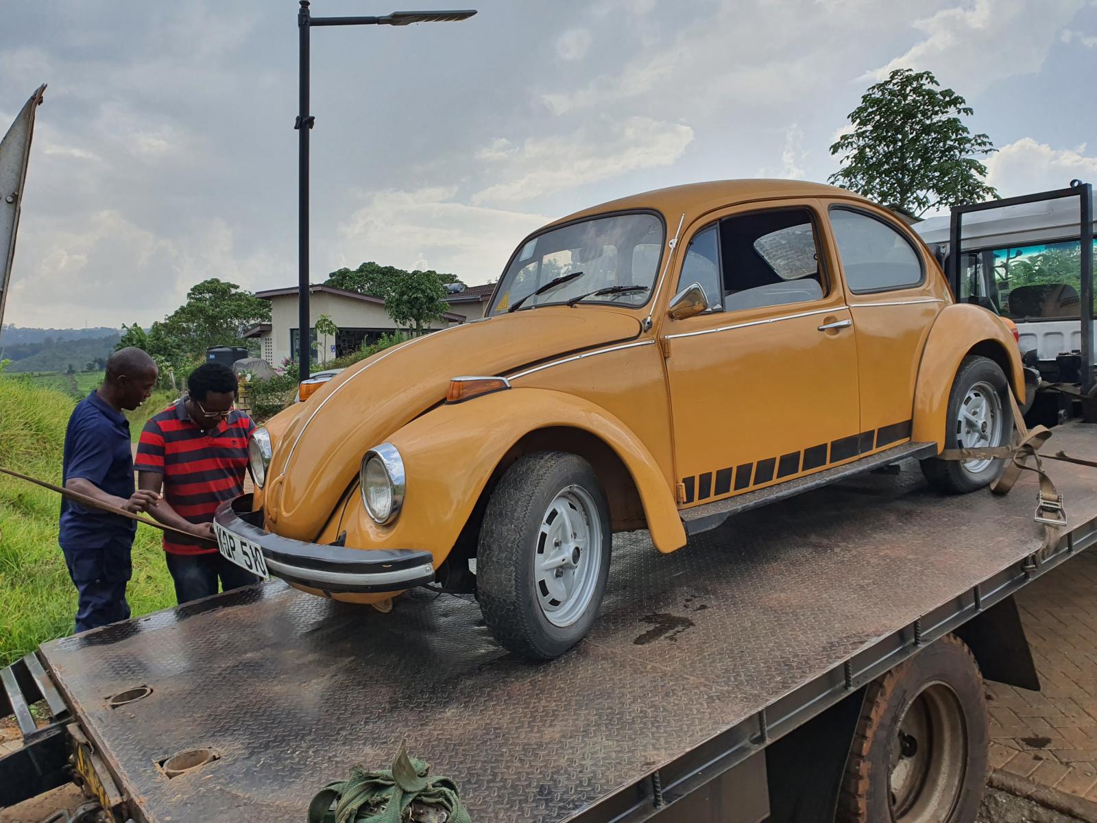

So, she's finally here. Looking forward to trying get her running in the morning!
Fingers crossed.

Nice! It looks nice and dry, good project. And great price!

NICE find
Now about that Ford, any pics?

So, is the engine covered in dust or paint overspray? There's money on the line here.
Great looking Bug though, it would be a steal these days in the US is it's as dry & clean & rust-free in person as in the pictures.

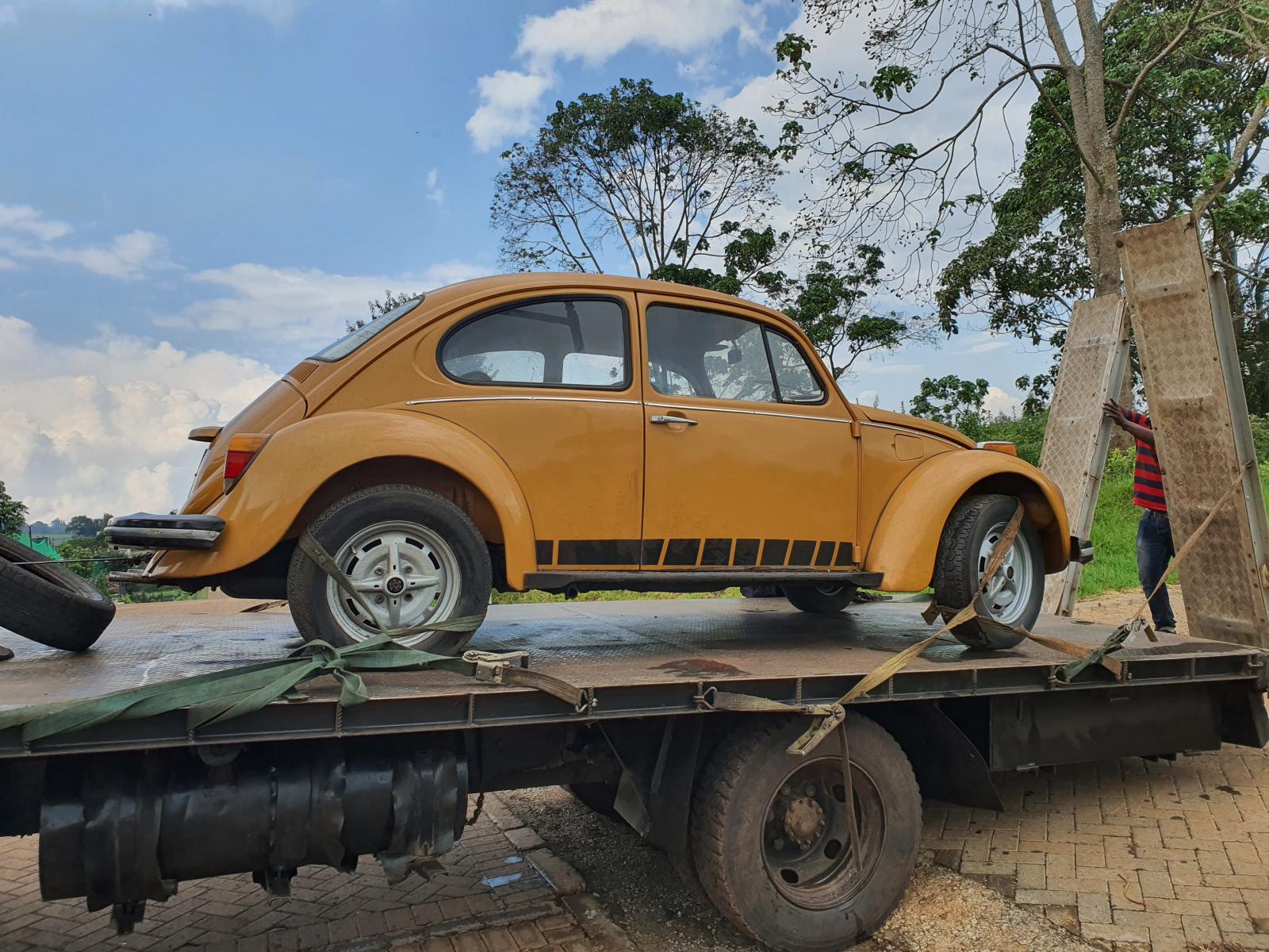

lotus72R5 wrote:
Is this extensive body damage, or previously damage covered up? The lines from the b-pillar back at way wrong, especially where the side moulding fails to follow the contour of the body line.

TDCTDI wrote:
I agree that there seems to be some pretty decent damage in that area, but also, its Kenya, and I'm sure replacement quarter's are not what we would call affordable. Hopefully its not too bad that its structual and more just cosmetic that may need some panel beating and mud slinging again.

the chrome trim is also obviously not original and it appears to have been riveted or screwed in place, the rear quarter panel section was clearly made from a straight piece and it doesn't follow the curvature of the panel, making it appear distorted (or more distorted than it actually is).
