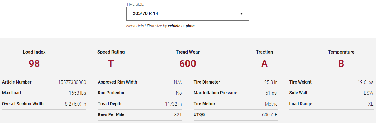

Is anyone running the AltiMAX RT45 205/70R14 in Load Index 98?
I am tempted to try these simply because my Vantras are not useful for loose surfaces (snow, dirt, sand and mud)
The Altima is an all-season tire. I’d expect them to be <marginally> better than the Vantras, but maybe not.

wbailey2112 wrote:
They are great tires however I do believe that the load rating and the sidewall construction would be suitable for installation on my top heavy Westy.
They are actually well up to the task with a max load rating of 1653lbs.
Thanks all for your input on this tire. I am staying away from the Grabbers because I have a stock 1.9 and live at high altitude. I need as much gearing advantage as I can get, and these are identical diameter to stock.
Back when I was looking, I don't remember seeing this one. If someone picks them up for a Vanagon, please report back.

brickster wrote:
[Altimax] are actually well up to the task with a max load rating of 1653lbs.
…although, not being XL or LT rated, subject to 9% derating (like any passenger tire used on a 5000# van).
9% is a significant loss of safety margin, although still gets you about 1500# per tire…just sayin.

Good point on the derating of the Altimax. Between that and the quality reports, perhaps best to stay away.
The Petlas look exactly like what I was looking for. A quick search didn't show them as being available locally, so perhaps they would be a ship to installer choice? It would be great to have another stock diameter & load range option different from the summer/highway/commercial tires (Vantra & Thunderer).
