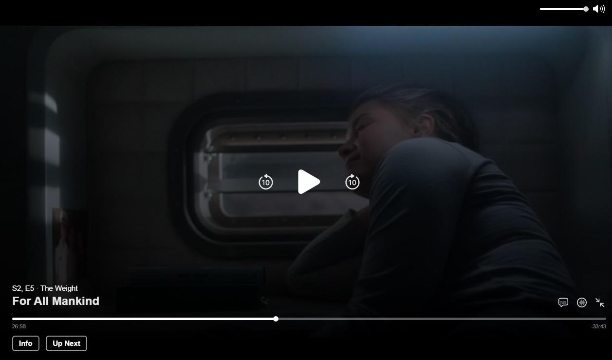

I just got an idea from a show I'm watching. What if you installed aluminum panels to replace the glass? You can still ventilate your van, but you have the ability to go full dark
