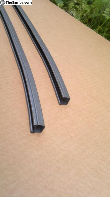

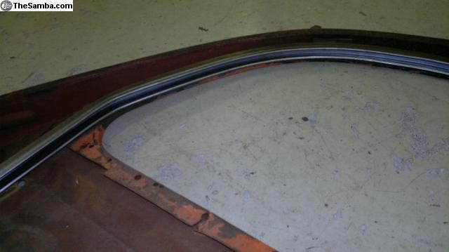

there are two styles of the metal channels , early n late . you need the later ones .....im currently working on the same and ordered the rubber n felts today .....look over these adds to see the two styles ..... these are in the samba classifieds . there are several repo manufacturers now days . there is another thread showing the felt installs by John Henry .
early
https://www.thesamba.com/vw/classifieds/detail.php?id=2653500
later style for notched windows . this is what mine has .
https://www.thesamba.com/vw/classifieds/detail.php?id=2653502

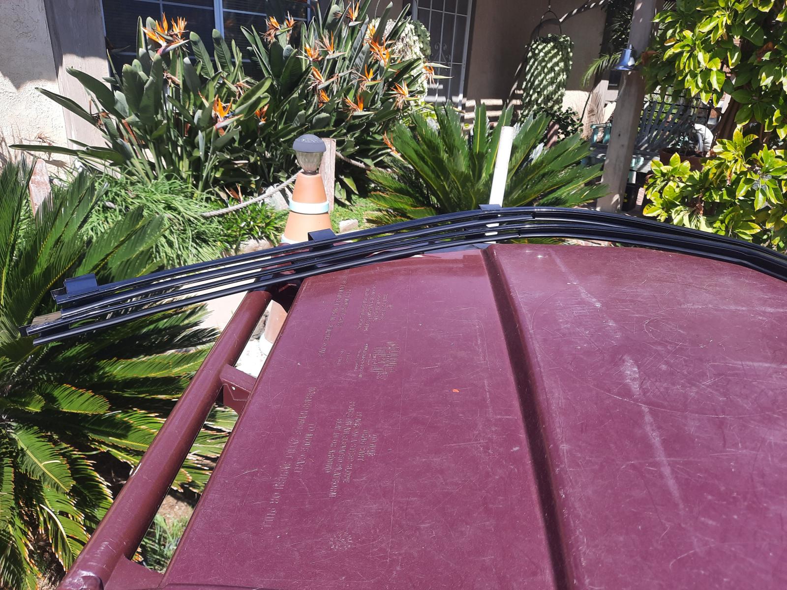

i got all the old rubber out of my window channels , stripped the paint n re painted em ......ordered the rubber kit from kafer nostagia as splitpartsunlimeted didnt have the complete kit for a 51 , he wanted me to cut the center out of the U channel rubber for the upper pieces ..........the KN rubber is pretty nice , the rubber U channel just pushes into place like the original rubber n fits good ....... the two upper pieces when in place just fall out and need to be glued ....my old damaged original upper pieces have a bit different profile and almost lock into place without any glue .....i went n got some 3M weather stripping glue n glued those upper rubbers in place NOT EASY .......the glue is like contact cement , coat both pieces till tacky n put em together , well getting em in the channel with contact cement on em is a tricky situation ......had to use a little gasoline to remove the excess glue ......after about an hour i have all the rubber installed in both channels .......it came with some stretchy fabric for covering the whole works now . i have not gotten stated on that .....i did see some pics John Henry showed how he installs the fabric cover ........it looks to be a chore !!! the KN rubber is pretty nice but they used maybe 20 rubber bands to hold everything coiled up , well these rubber bands left a lot of dents in the rubbers , some of em would massage out but not all .........luckily they were long enough i could cut off most of the damaged parts .............its coming along ok so far ...
on the plus side the KIT came with 4 rubber U channels , so it has enough to replace the rubber in the straight channells as well cuz mine is a 51 and doesnt have U channel all the way around ....

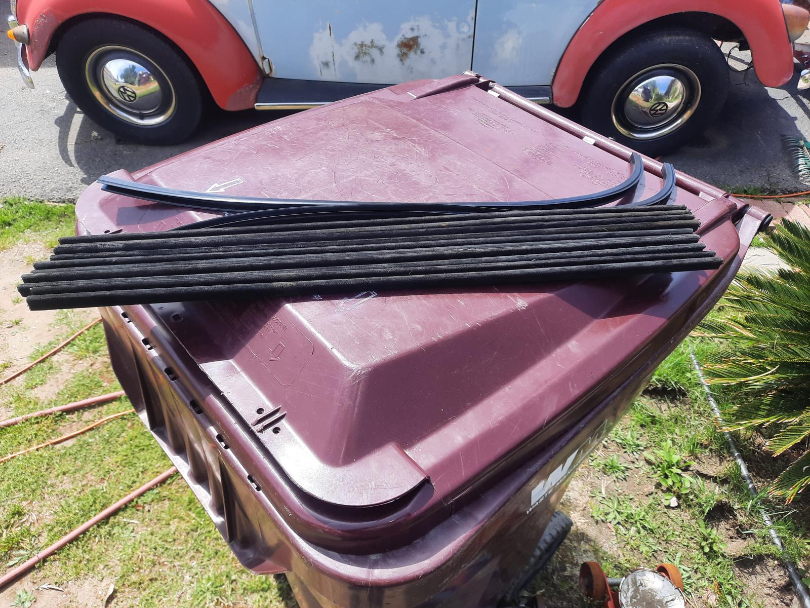

this is what i mean about the straight window channel piece . the door glass rides up n down in these channels . one on each door .......i have 5 of these straight channels sold to me as NOS ages ago .......they look nos to me but maybe didnt have the best storage as the felt/whisker fabric covers are a bit worn n dirty ......i may re do one pair to match the other channels and sell the rest in the classifieds here ........anyway the KN U channel rubber fits these as well as the upper channels .....
not sure why they all have this square hole in the back side of the metal , must be for mounting to something ?

ok i thought id go trial fit one of the straight channels WAPITA i was not sucsesful - all i manages to do was scrape off some of the old fragile fabric cover trying . im sure there is a little trick to this i need to learn ....... the door is curved so it only fits in the one area , not much wiggle room there ...... the fabric cover is so old n fragile ill prolly remove it as im learning how to fit it ..... some trial and error is happening here Smile
still struggling LOL
my3bugs
Joined: June 18, 2003
Posts: 927
Location: Moreno Valley
my3bugs is offline
PostPosted: Sun Apr 07, 2024 12:14 pm    Post subject: Re: Window channels and felt Reply with quote
OK piece a cake this time , the trick is to pull open the door shell just a tad , pull the inner shell from the outer shell just a bit and it just dropped right in Smile the other door will be a lot easier now Smile . the doors are not painted yet so im just trial fitting things .... you dont want any troubles after paint .
i ended up using a wooden wedge to hold the shell open a bit to work on , a rubber door stop wedge would be best after paint .

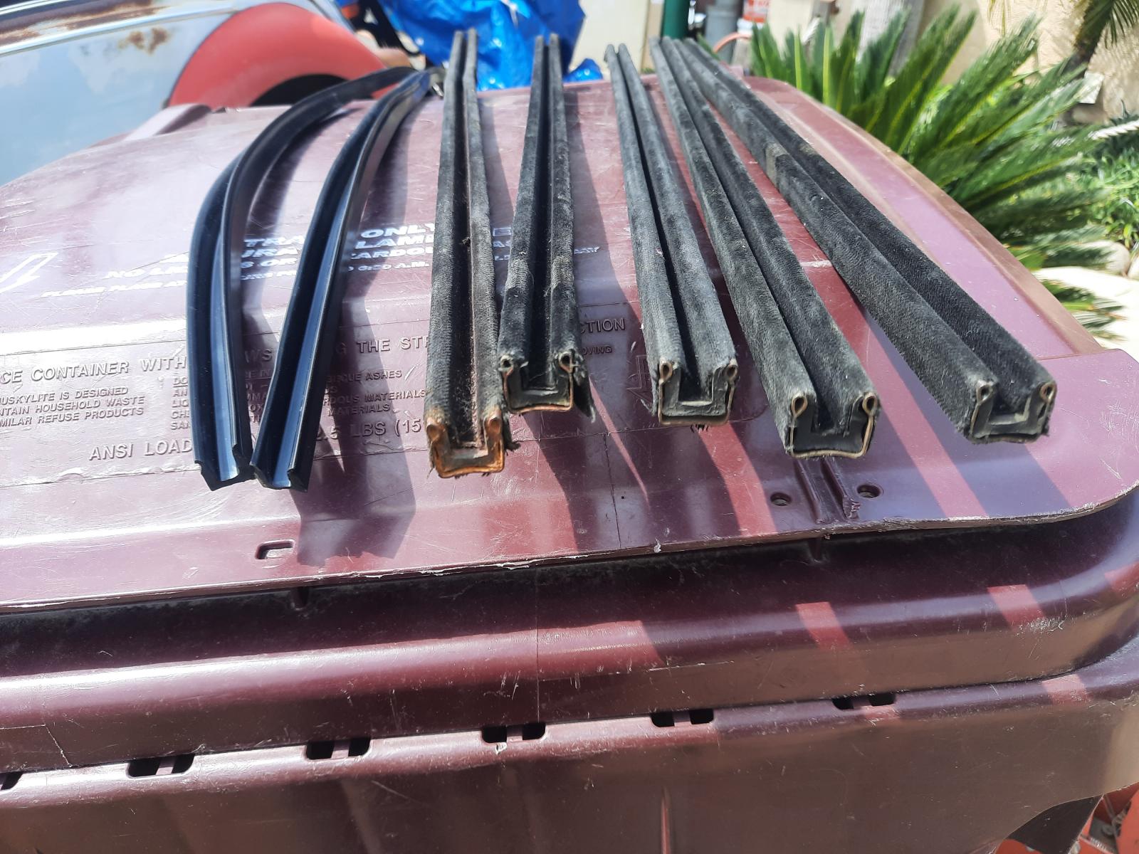

so i peeled the cloth off a pair of the straight channels . that leaves it rather bumpy with bits of cloth stuck to the remaining sprayed on glue . it was kind of a mess . checking the rubber it looked ok but it was hard n cracked when i messed with it so i took it all out as i have new already ...... got the channels all stripped down with Jasco paint remover .....then i gave em a shot of rattle can rustoleum gloss black ...... there is a lot of work to a pair of these early doors .... i have trial fit most everything now but the big window channel , it looks intimidating LOL
