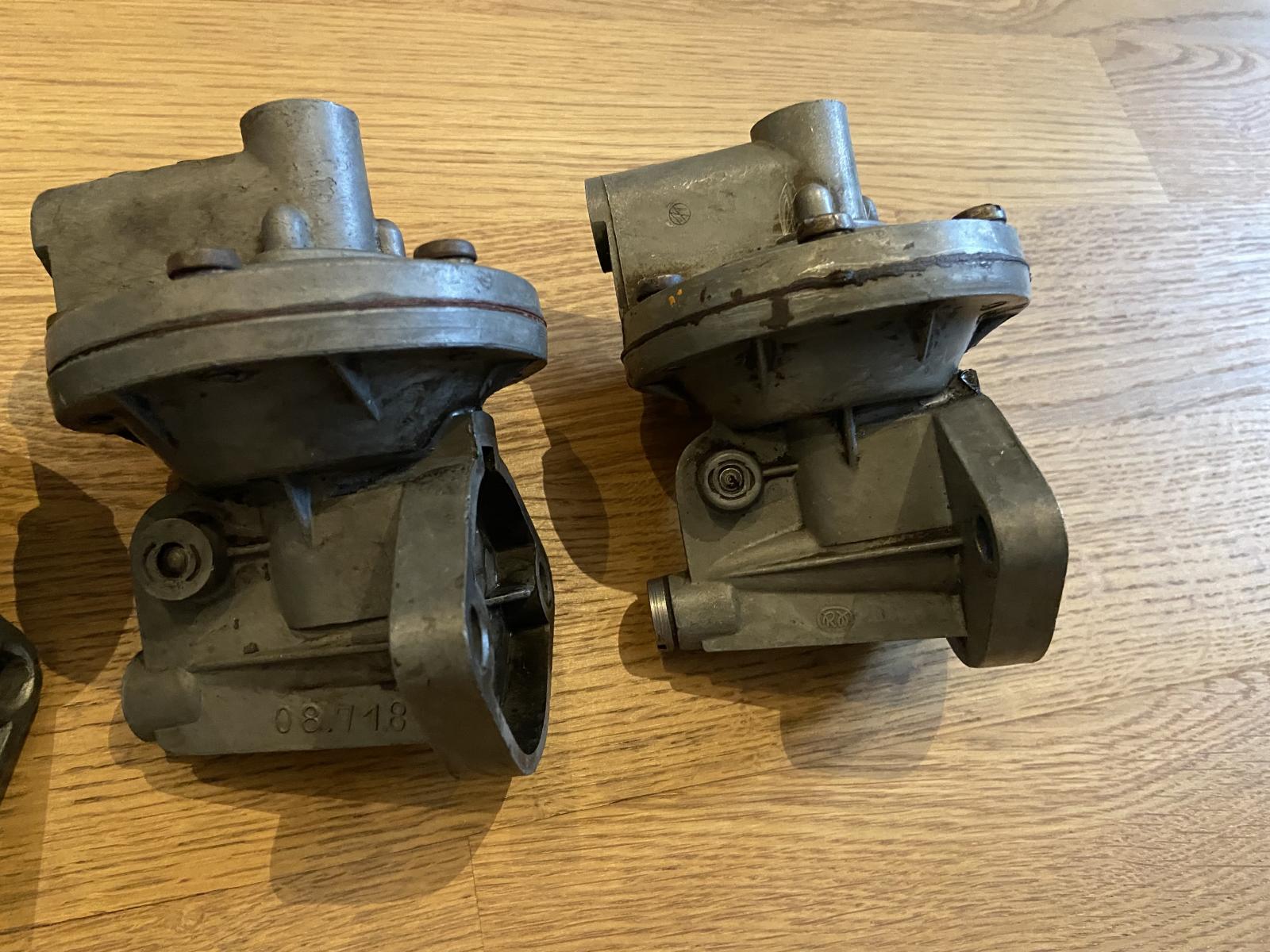

for a 36 horse 1958-59 fuel pump... though they're basically the same fuel pump, the one on the left has more "Made in W. Germany' stamps than the other. The right version , does say "Made in W (VW logo) Germany" on the top. Maybe a later manufacture date?

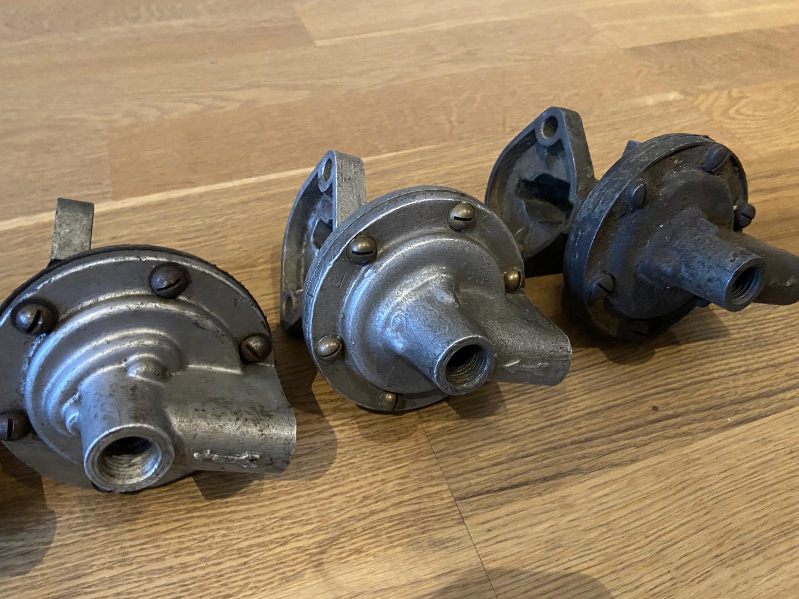

Here are some pics of early fuel pumps to supplement this thread. From left to right in chronological order (to the best of my knowledge):
- Kdf fuel pump with cog wheel, production probably ended when Solex couldn’t supply them anymore in 1945.
- Aluminum fuel pump without any manufacturer marking, note the rough surface finish due to the sandcasting method
- Diecast aluminum fuel pump, HUF marking on the bottom part
- Diecast zinc fuel pump, HUF marking on the bottom part
- Regular 8 mm 25 hp Solex fuel pump for reference
Best regards
