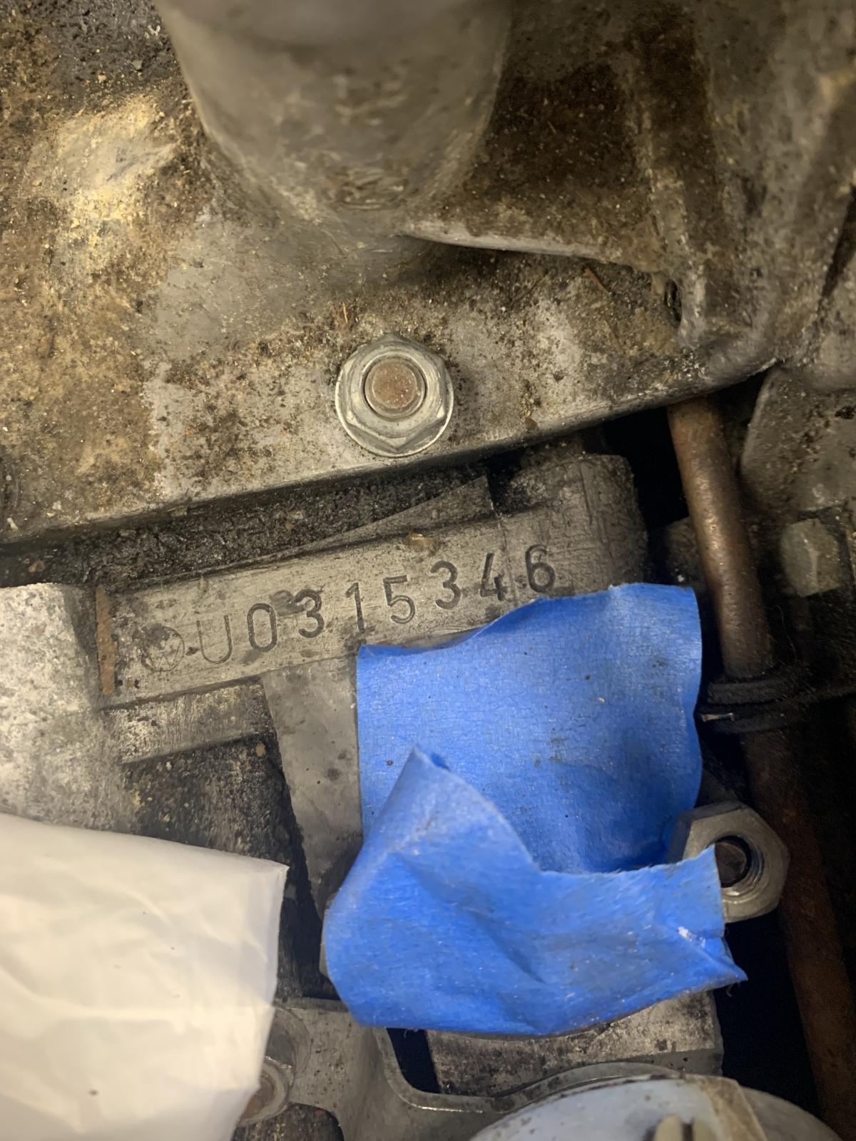

came home, checked the timing, spot on, and really solid at 0deg, checked dwell and it's a bit on the long side but still within spec
so for this engine u0315346 (this is the number from original engine as I am using EVERYTHING from it such as distributor, and FI components, timing supposed to be at 0.

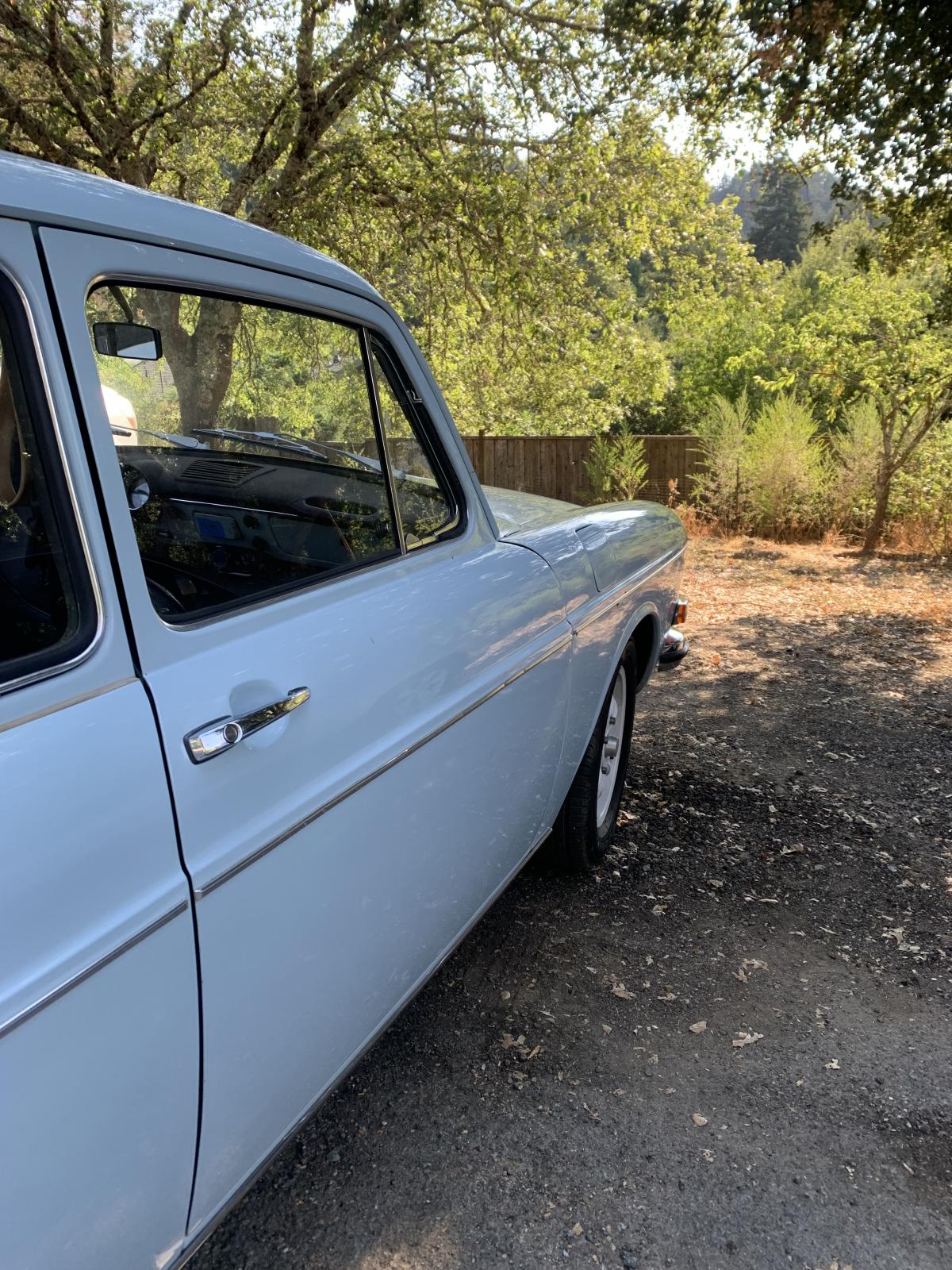

After that I wanted to pull off key code from a door handle got that pulled off and here is where you get to see how much the paint has faded
While handle was off, I put some sawing machine oil on it and on the door lock mechanism.

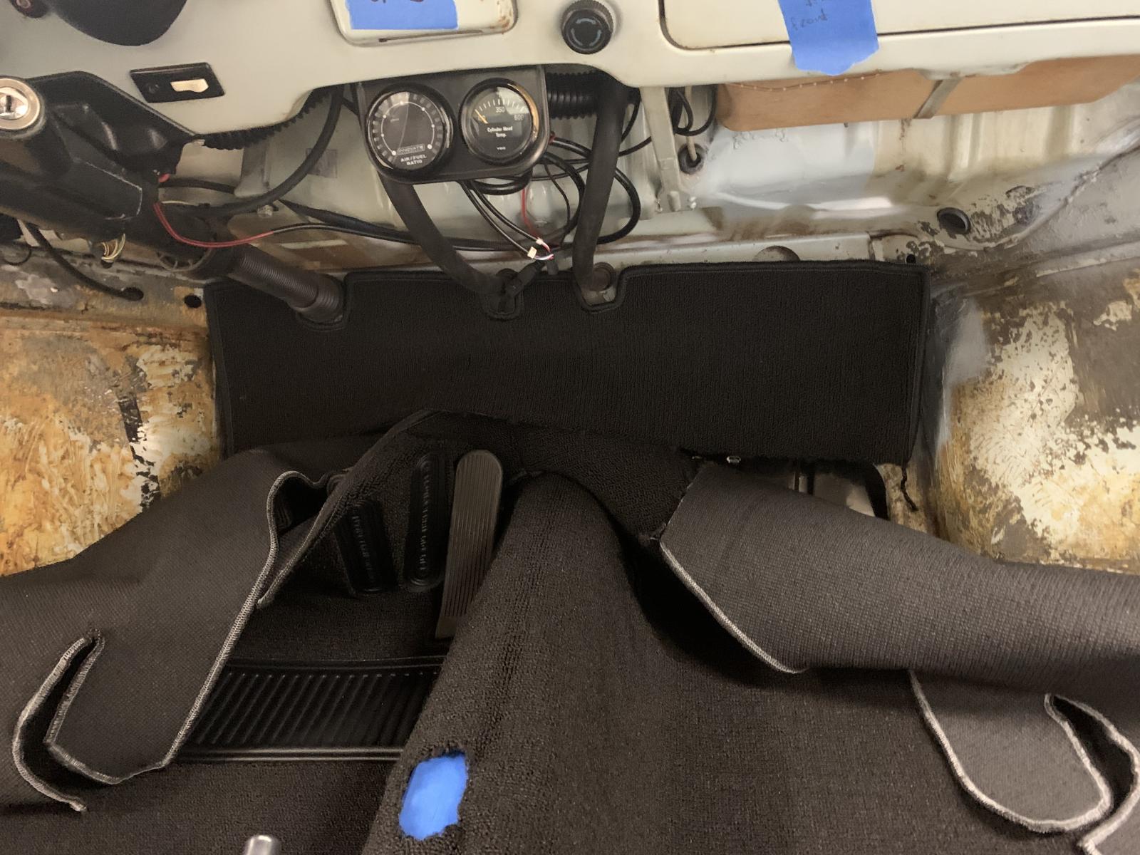

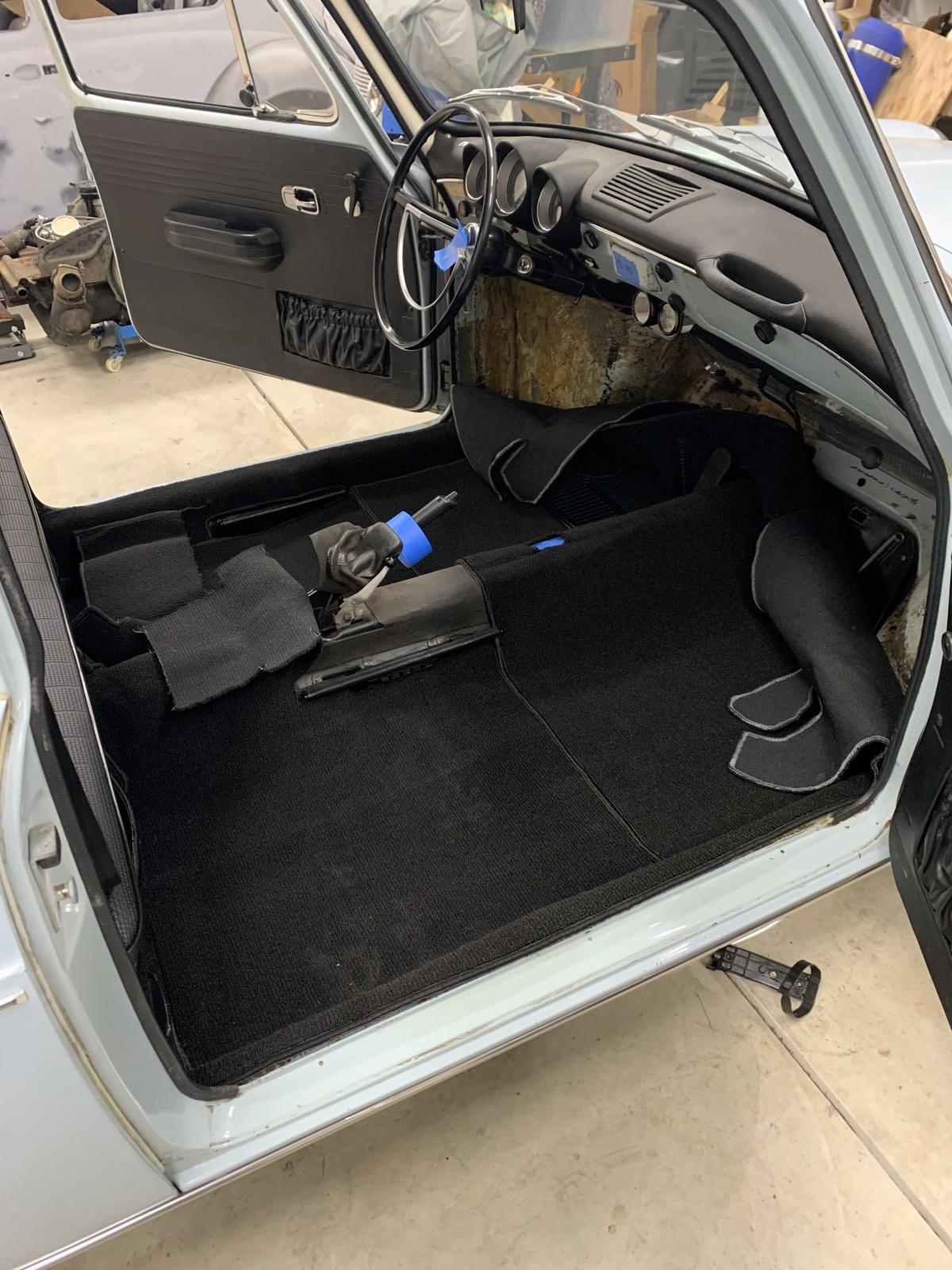

Today I started on the carpet. First order of business is to remove everything like seat belts, seatbelt buckles, shifter and whatever else that will be on the way. Then vacuum and wipe clean the floor. Layout all the pieces in the sequence and see how everything fits and whether anything needs adjusting or compromises.
Checking each piece to make sure there is nothing weird.
Every thing needs to needs to meet with other pieces
I only had 5 pieces of the sound deadening, but that’s more than enough to be effective. I also don’t like to add too much weight and want padding to have something to stick to so uncovered borders should help with adhesion
Not a huge progress but sorting out the game plan is half the battle.

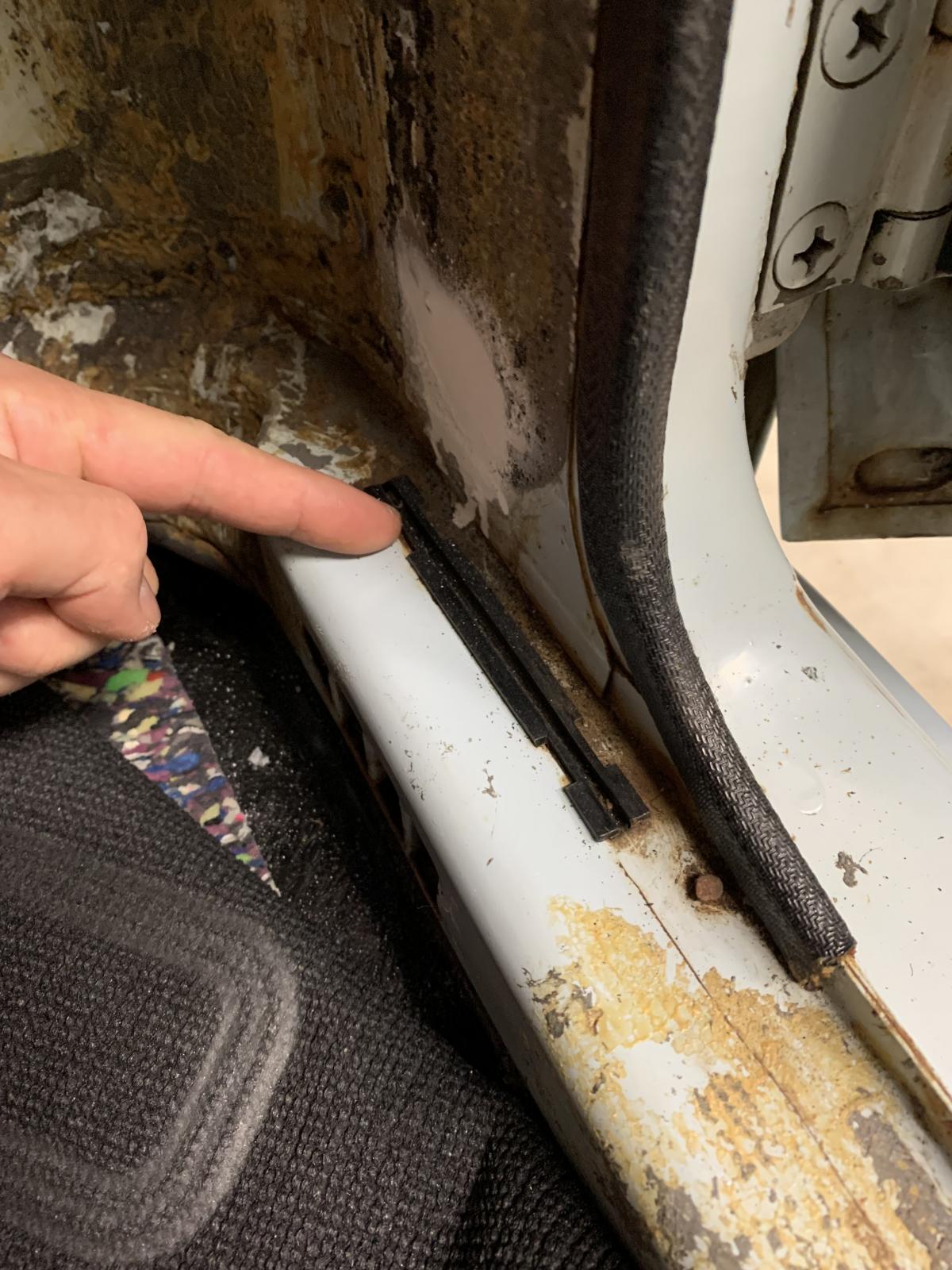

Slowly continuing with carpet install...
cutout and glued in padding

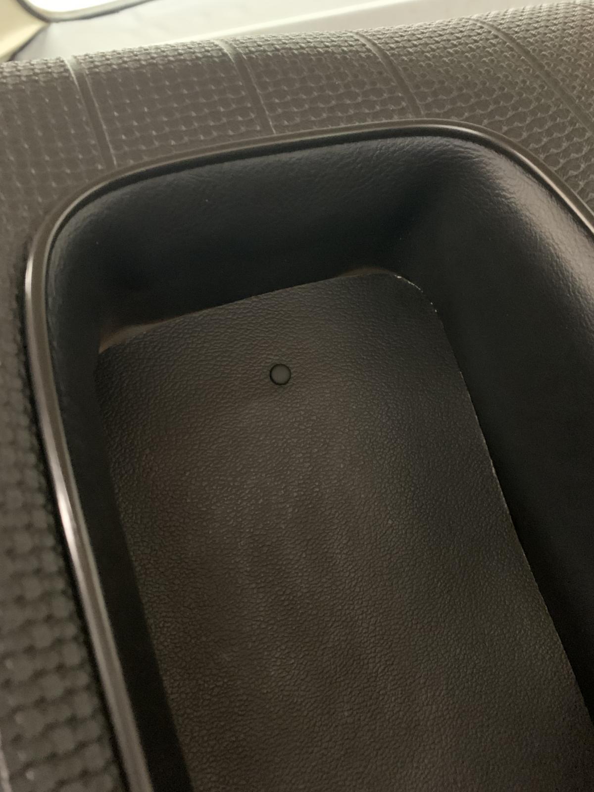

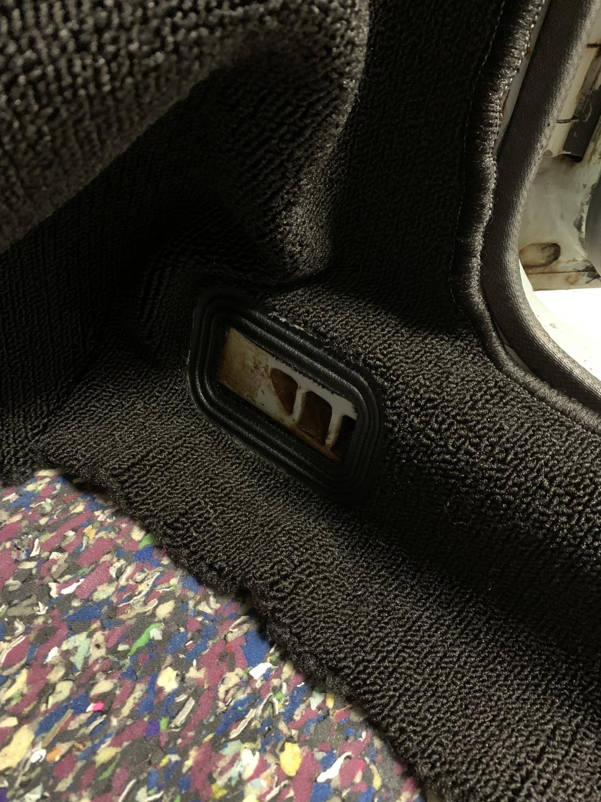

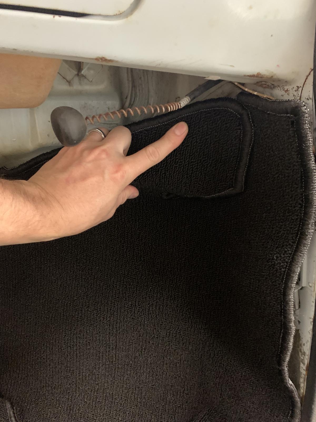

Started cutting out vent holes and I knew they were off but not that much, I think vinyl is like 1/3rd off
What is the purpose of this plastic thing?
So I think I need to do something about this, I am thinking metal cover painted black like the plate over the heat control that is right above it
I am trying to replicate the windows but I think it maybe easier to just cut one big window
Cheers!
Anton
The plastic part is the hinge for the vent/heat to dash flap. On the "B" post should be a slider knob and a cable tube that allows you to close the flap (sends heat to the windshield) or open the flap (burns your foot), or somewhere in between by tightening the knob on the cable (solid strand wire). The flap is solid except for 2 small holes (about 6mm diameter) for the cable and the clip to attach to the flap. I'm sure there are pics of it in the forum. I know there's pics of it in the brown Bentley. I hope this helps.

PostPosted: Sat Aug 03, 2024 2:23 pm    Post subject: Re: 1970 Fastback "sympathetic restoration" Reply with quote
Thanks Bob, I thought it maybe some insert for vent covers or something, but that makes sense.
One vent cover is hammered out. I didn’t want to make it too big, but it’s not going to cover those vinyl borders completely. I think they will be below the floor section of the carpet
I used vent slider cover radius to round the corners so that these pieces match the covers

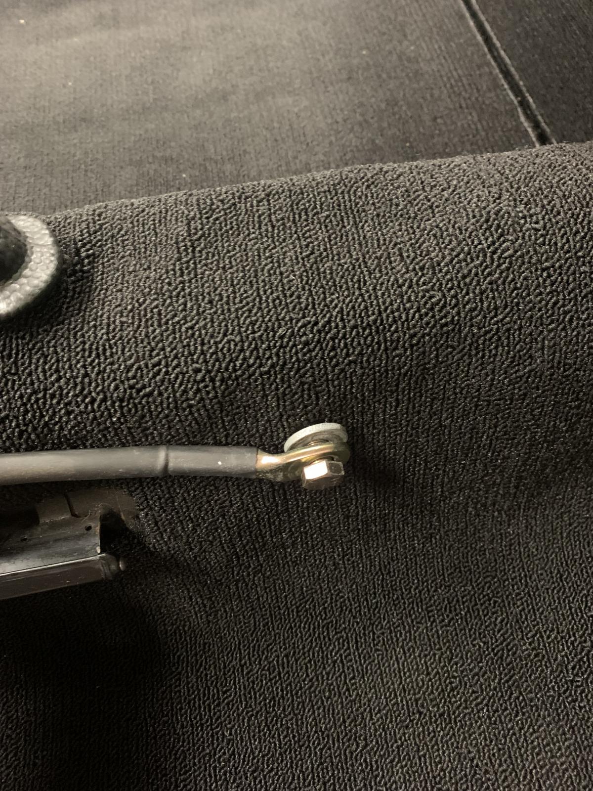

While at it I thought I would ask if anyone has any ideas why my seat belt catches are weird.
There is an offset in the loop that bolts to the tunnel. If flat is on the tunnel then button is toward the outside of the car, ie it’s under the belt. Every car that I can remember release button is toward the center of the car.
Here is the close up of the mount
I am assuming that the washer is supposed to be on top of the bolt hole not between the catch and tunnel.
This looks awkward
. These are not original installed before me.
