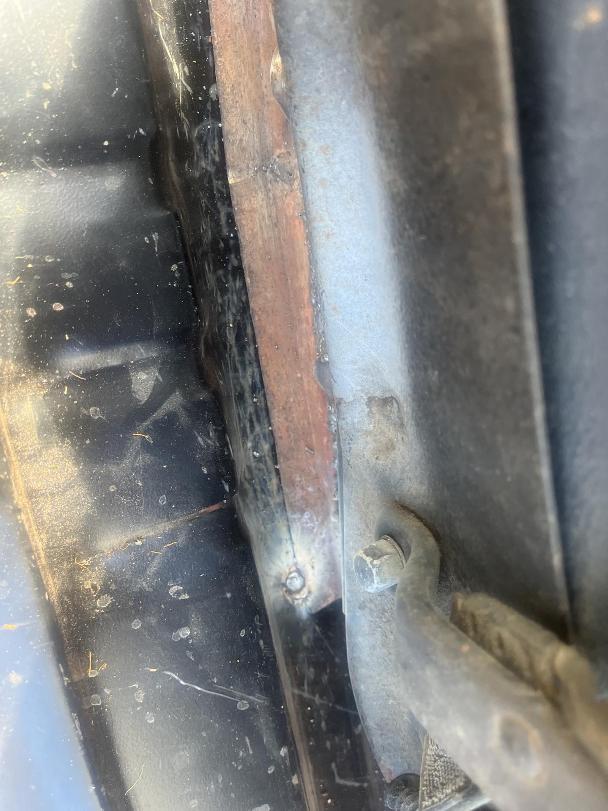

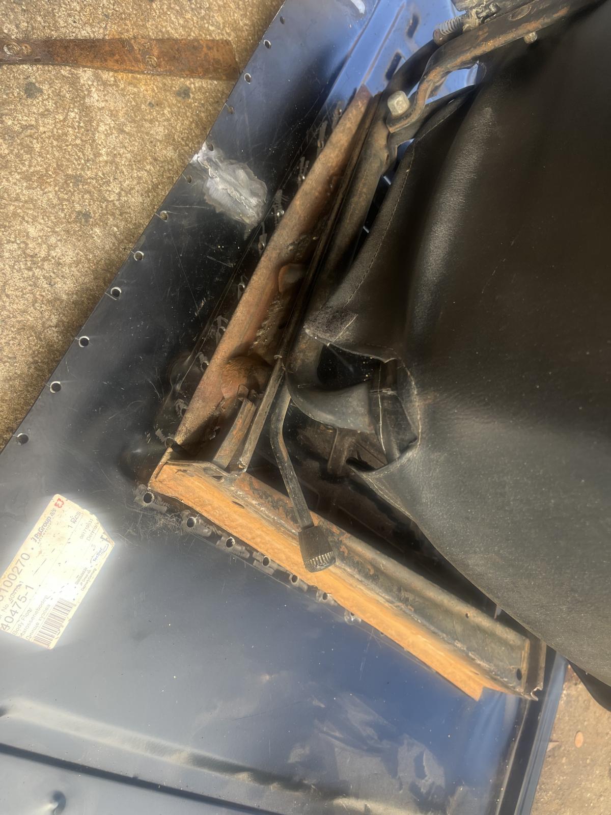

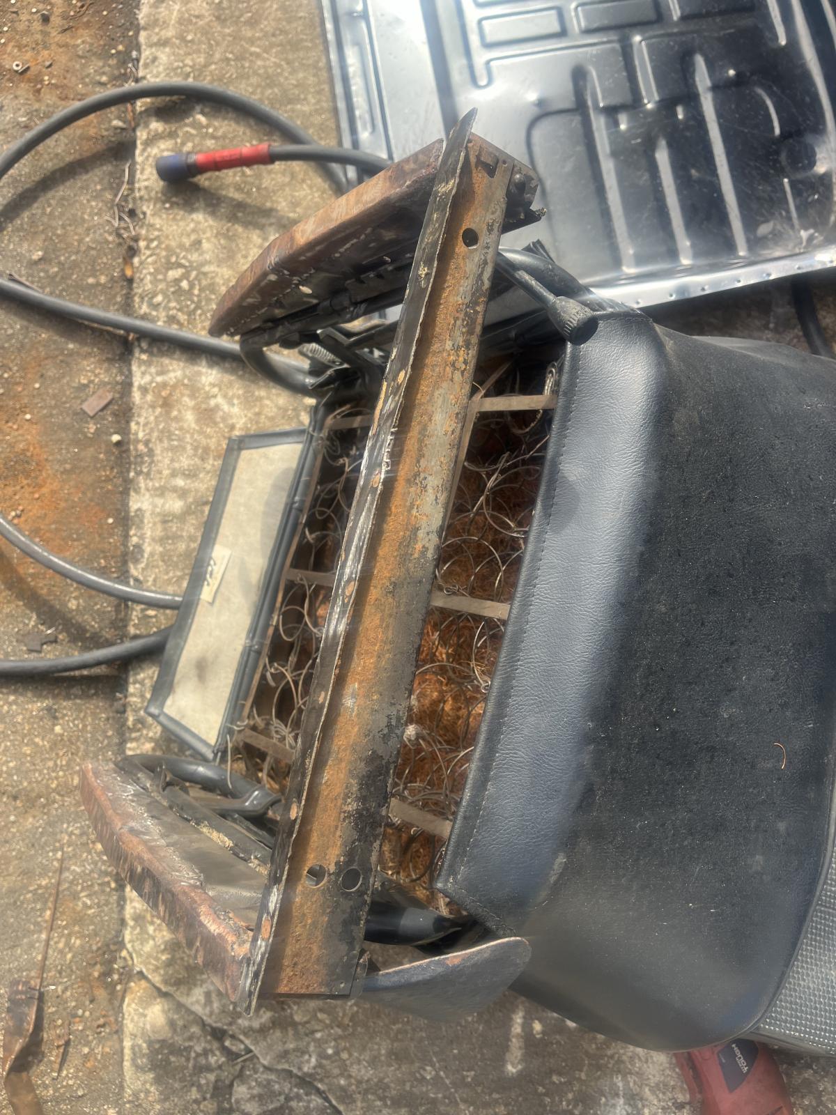

After drilling out the rest of the holes, I slid the seat track into a seat to ensure correct alignment of the tracks.
I then set the assembly onto the pan & positioned it back up to the lines.
And tacked it in place.

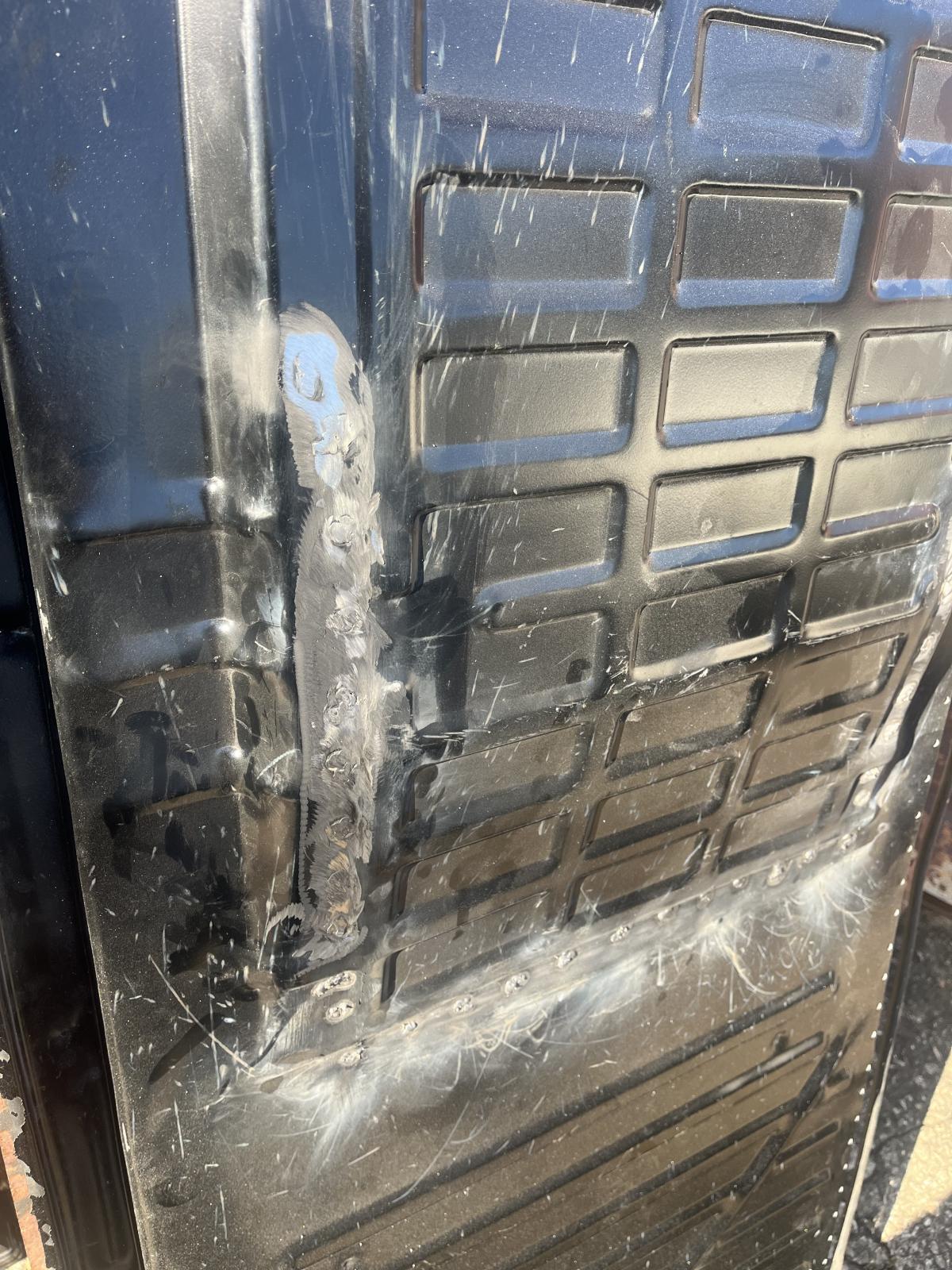

Once secured, I removed the seat, flipped the pan over & began filling in the holes.

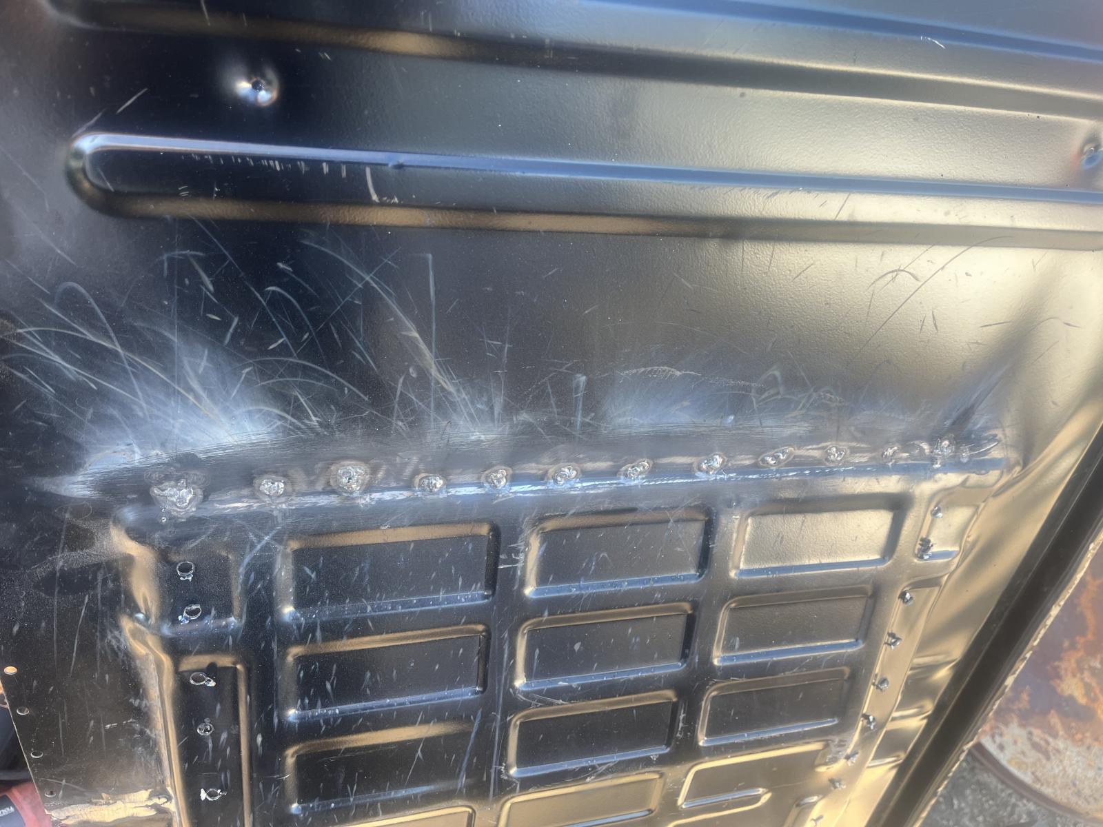

PostPosted: Thu Oct 17, 2024 7:57 am    Post subject: Re: SKULLDUGGERY Reply with quote

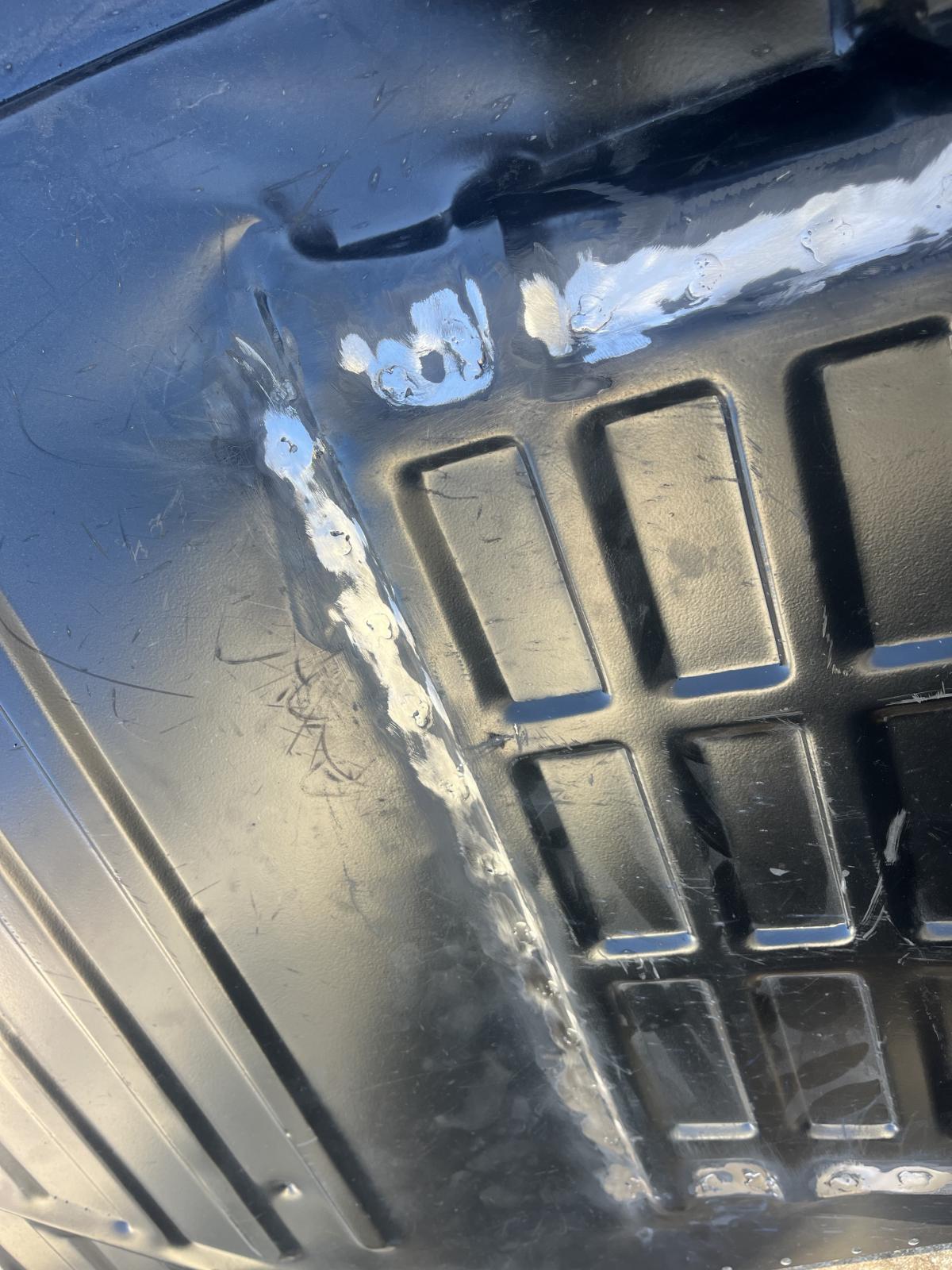

This morning I plugged up the rest of the holes.
And started knocking down the high spots.
And then buffed them off with a Scotch Brite surface pad.

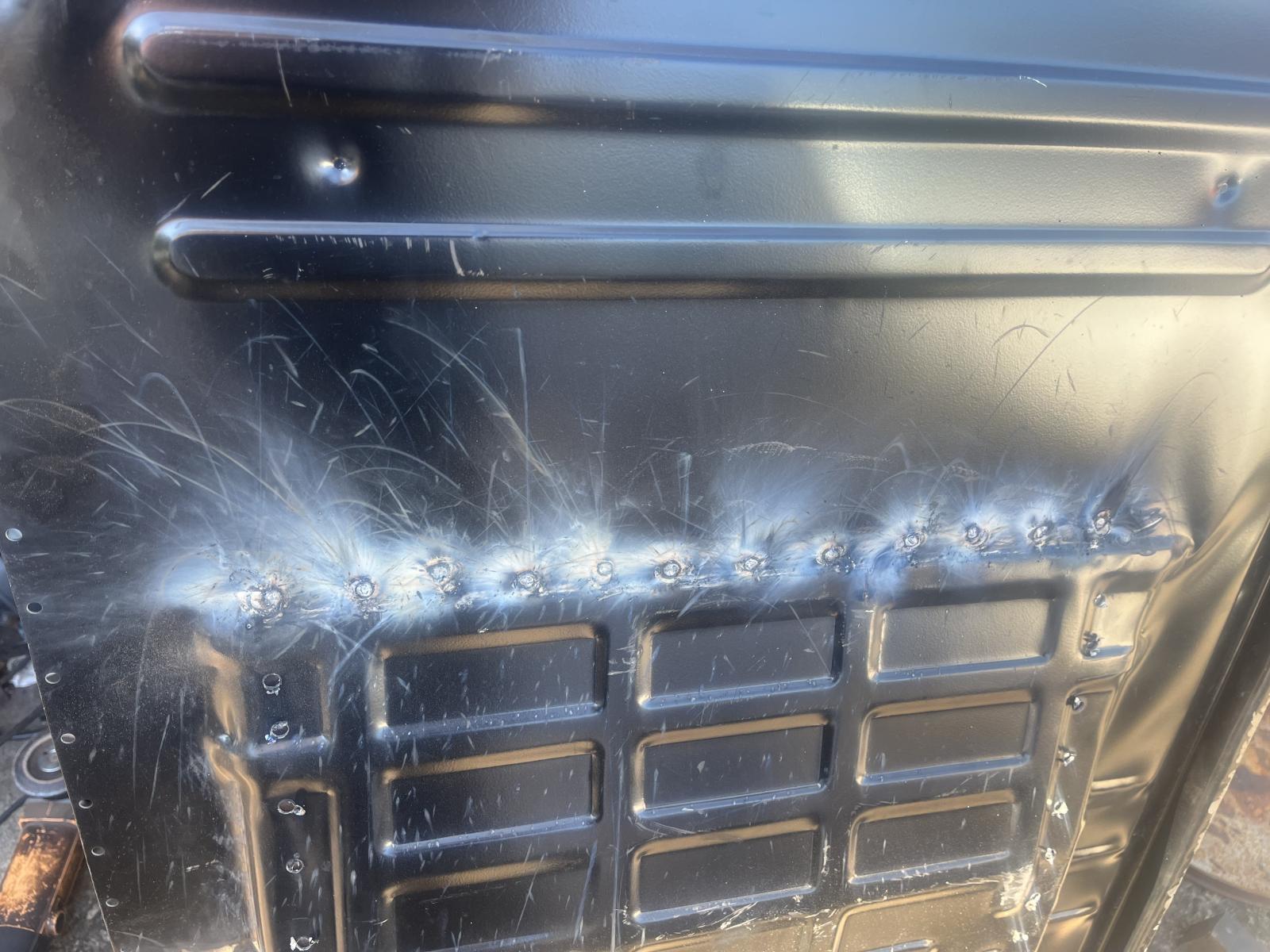

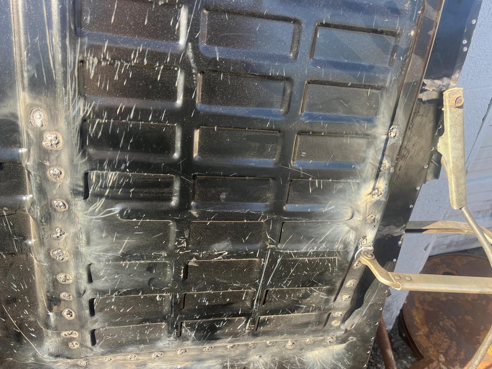

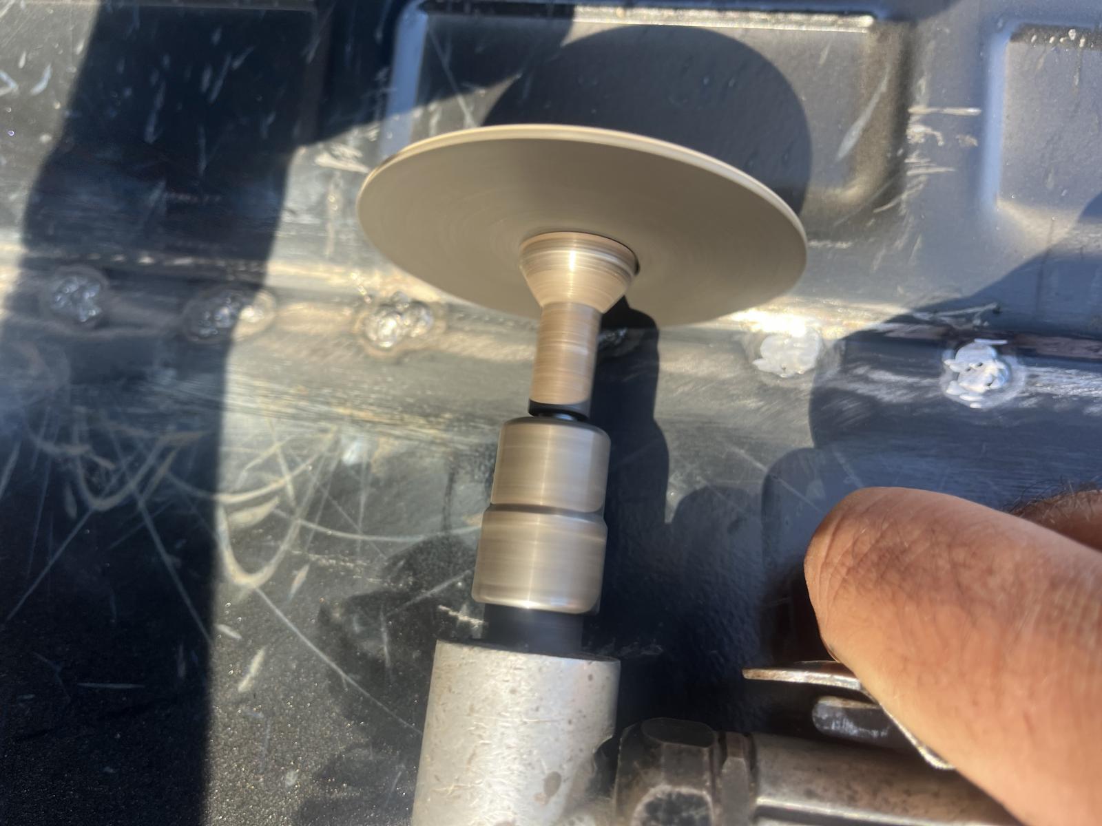

PostPosted: Sat Oct 19, 2024 9:28 am    Post subject: Re: SKULLDUGGERY Reply with quote
Today’s endeavors consisted of knocking down the rest of the welds with a cutoff wheel.
Grind them flush with a sanding disc.
And finish them off with a scotchbrite pad.
